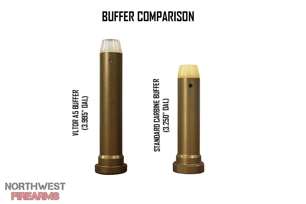

Or a great way to reduce recoil on a .223 a bit is the Vltor A5 buffer system. It's 1/2 way between a carbine and rifle. It will keep the length of pull Smurfable too... receiver extention is 7 position and 3/4" longer, and you can use a regular Carbine stock. I was running one with my Scilencerco Hybrid on a .224 Valkyrie Upper I was testing out a few days ago, and even that hot rod cartridge was super tame. No real felt recoil at all. With .223 and a good muzzle brake before my can was free from NFA jail it was super light..My daughter loved it. Now with my supressor, it's like shooting a .22.
If y'all were closer I'd let you try mine. D2238DC0-B4BD-46CD-9E95-FBECC10AB6D5.jpeg
