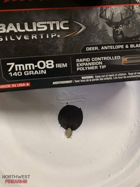

I'm not sure what the attached photo says on the subject, but this is what Velzey was able to achieve with 4 shots of factory ammo at 100 yards out of my new factory barrel when he was sighting in my new Model 70 SG after mounting my new Zeiss scope. To be quite honest with you, that level of accuracy is a good enough enjoyment factor for me. :)
I should point out that Velzey did replace my M70 factory trigger with a Timney trigger worth about $140 before taking those shots.
If that's 4 shots into one hole, I'd just stock up on that ammo and call it good.
