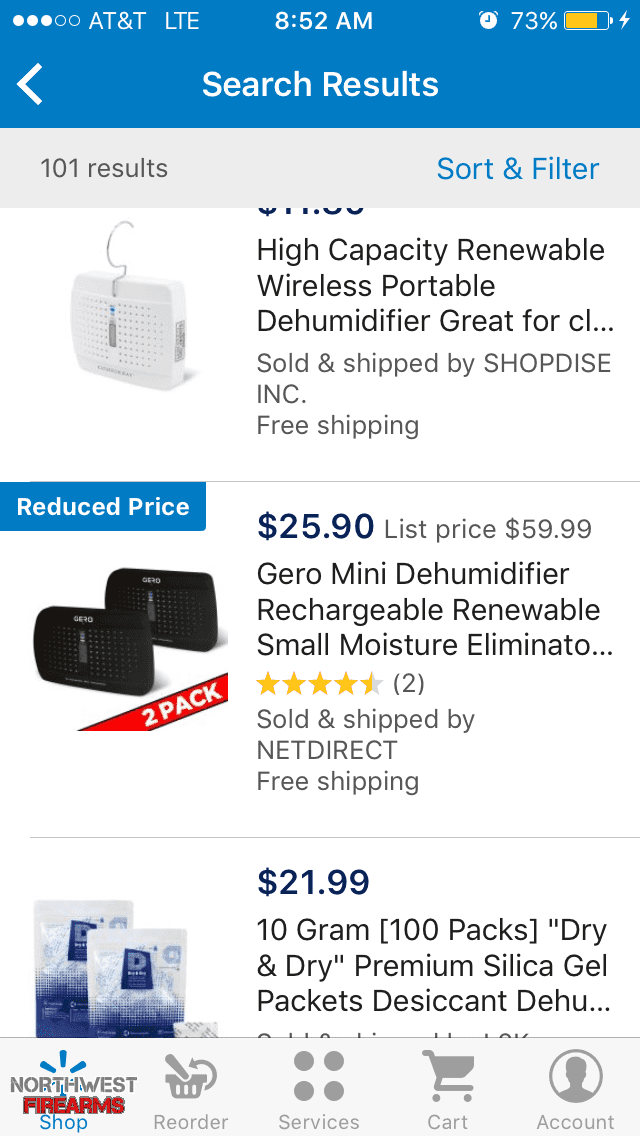

I ordered and just received these from walmart online (the black ones) in the mail - got tired of baking all of my desicant tins.
They recharge with a wire, cover 340 cuft and are two for the same price as the others that cover 100 cuft.
I don't buy them while they are on clearance.
