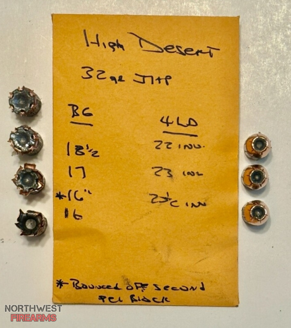

XTP and Golden Saber are two of my favorites. But I have yet to get them to reliably expand from a 2" or less barrel at standard pressure. It doesn't get them up to the velocities that make them reliably open. And those that don't open make the wound tracks that resemble FMJ bullets.First off, I've not seen a HP clog in close to 30 years.
HST, Gold Dot, Golden Saber, or XTP...nada. Even going through 4 layers of denim, they don't clog...the denim bleeds off enough velocity that it takes them out of their power band, and they don't perform. But they still have a blunt nose that cuts and plows and keeps them from over penetrating. In this state, they don't act like a FMJ.

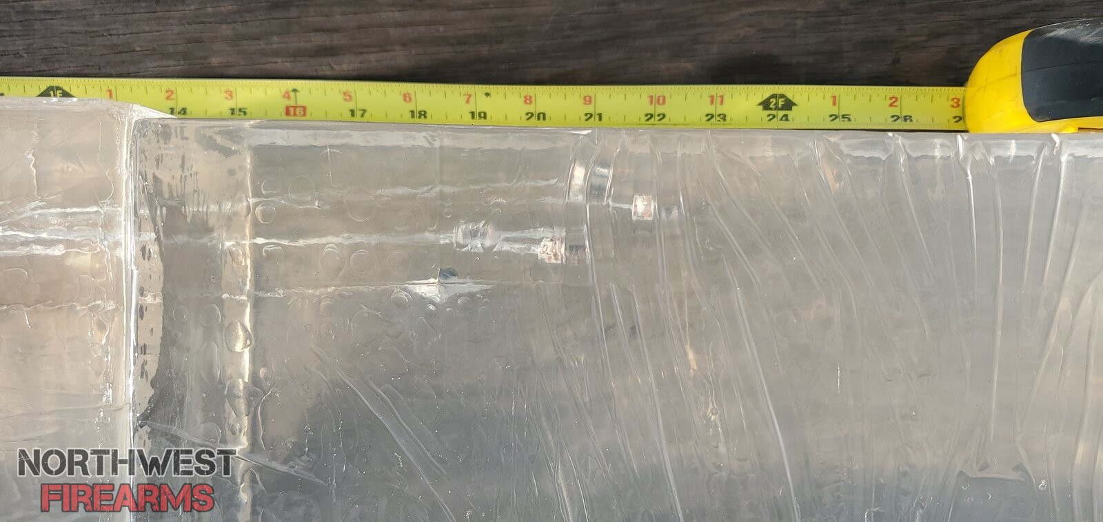

Study the photo below. Bare Gel on the left, denim on the right. They don't clog, but still get the needed penetration, yet don't over penetrate. They act like a wadcutter. They plow into a flat face surface, cut a nice wound channel and stop well within the needed depth. My minimum standard depth for penetration is 16", max is 22"

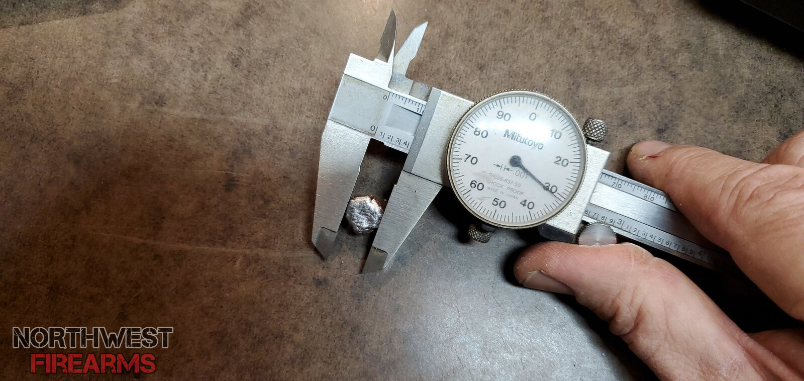

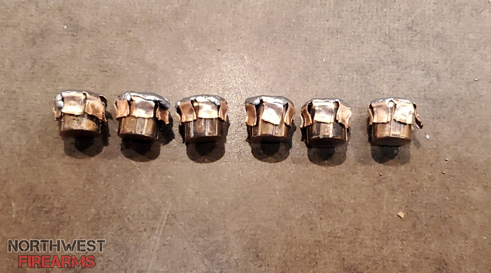

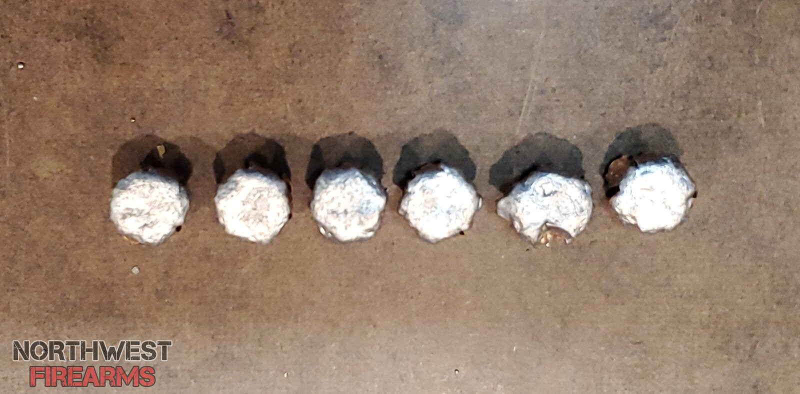

Next is 9mm 115gr XTP running at 1,150 fps out of a 3.5 barrel...made for short barrel handguns, both semi-auto and revolver. 17-22" of penetration, even after going through 2 layers of denim, and 2 layers of T-shirt...and reliably expands to around .430"
If you can get the HP in their engineered power band, they will work...or if they don't, they will work in a different form.
The 9mm pics above were shot through 2 layers of denim and 2 layers of T-Shirt, and out of a Glock 43x, M&P 3.5", S&W Shield, and a SP101 2.25"XTP and Golden Saber are two of my favorites. But I have yet to get them to reliably expand from a 2" or less barrel at standard pressure. It doesn't get them up to the velocities that make them reliably open. And those that don't open make the wound tracks that resemble FMJ bullets.

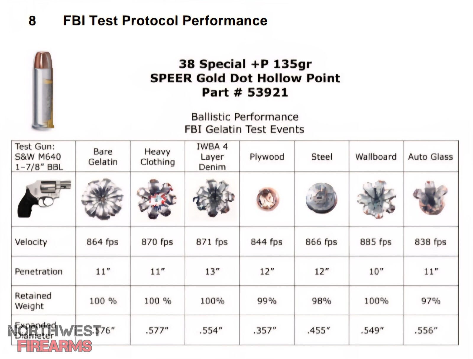

That 135 gr gold dot is what I carry in my J frame. I carry a reload of the same as well as 148 gr federal wadcutters, cause I can.I has the same concern when I started carrying a J frame but I found this load that I now carry. Speer started producing a line of "short barrel" gold dot .38+P loads that were specifically designed for J frames. They make them in both the "duty" and "personal protection" line but as far as I know they are the same slug at the same velocity.
It kicks a little more than cheap practice ammo but not much. Its definitely not as harsh as other +P ammo I have shot, and not quite the fireball either.
Here is a lab report on its performance:
38 Short Barrel Technical Data Package
