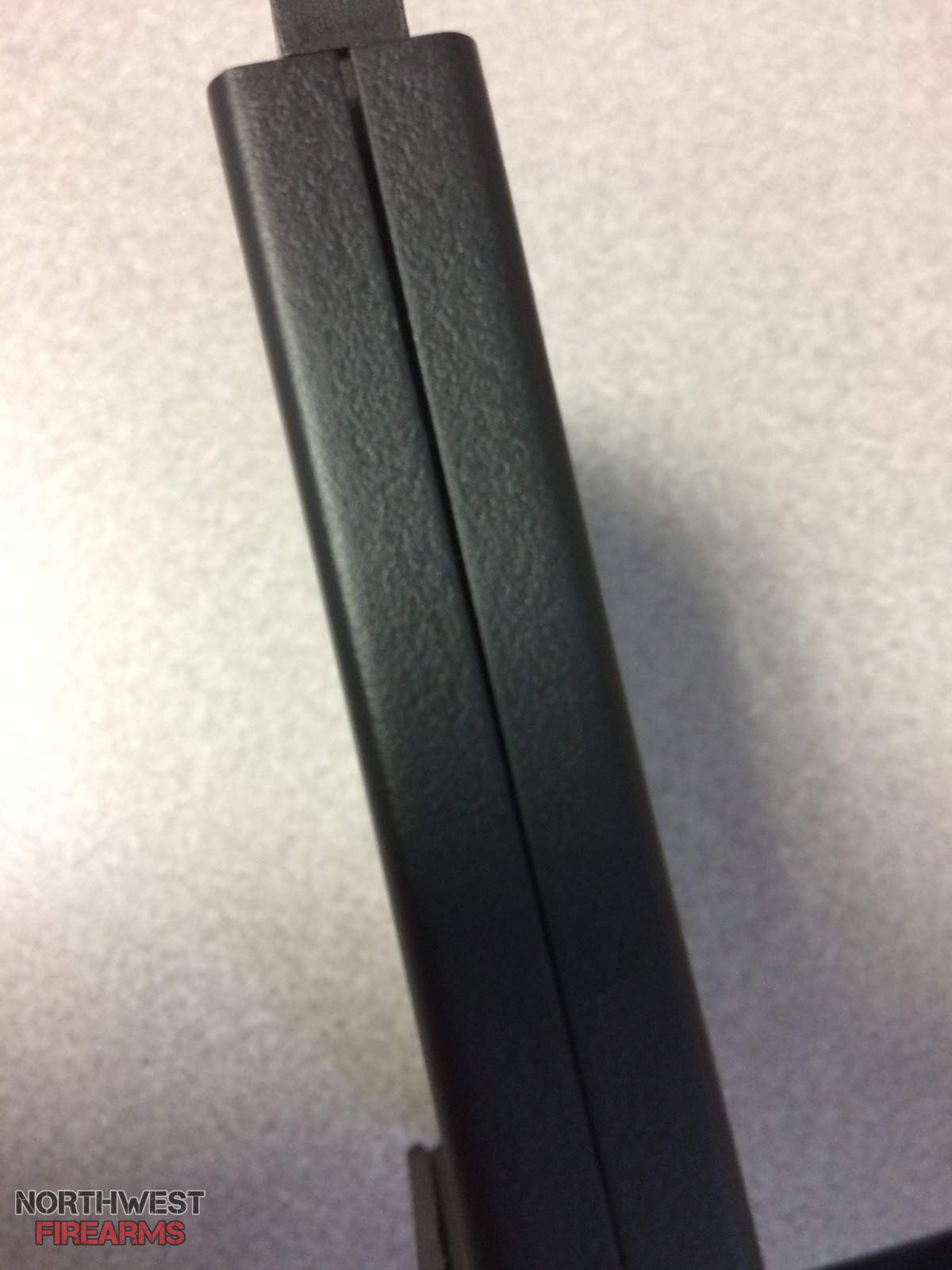

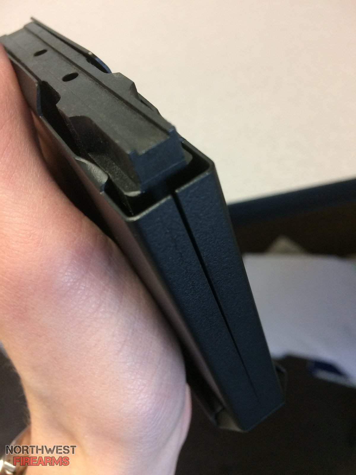

Starting to get a little annoyed...
Does this look a bit, um, unfinished? Because they didn't weld, braze, bolt, glue, or otherwise attempt any other method of attaching the sides together.
The mags for this gun are turning out to be quite an adventure. Back to the shop these ones go too. What fun!
