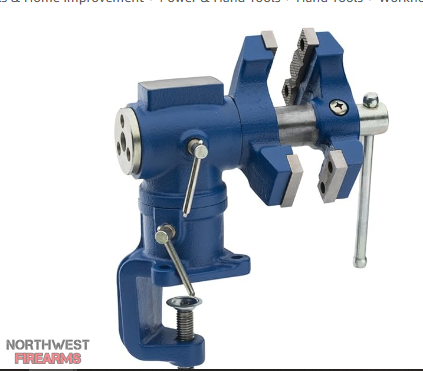

I think the smallest I've used for 1911 building is a 3" Wilton machinist with swivel base. I'm partial to the cheap $100 chicom 5-6" dbl jaw swivel vise particularly for hand checkering and old school slide tightening.

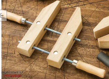

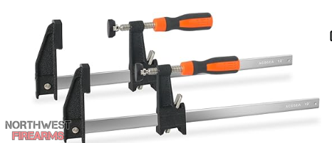

If you just need to hold stuff for light buffing and filing or general disassembly, you can C clamp or better a nice set of mini bar clamps
to hold a wooden parallel jaw clamp to your bench, in a variety of positions, especially if you have two. 1731802131985.png

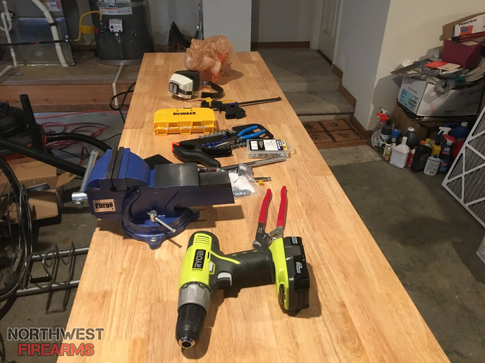

I bought a Husky folding leg work bench and bought a fairly cheap Harbor Freight vice. I drilled holes on my workbench and used some plywood underneath and bolted my vice to my bench. It worked very well for my purposes.
I moved it over to side of garage and anchored to the studs on the wall now.
