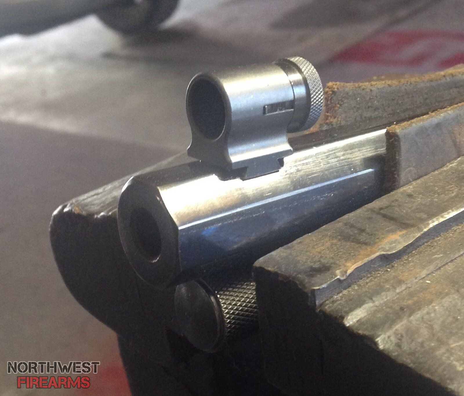

I usually use wooden blocks. I've also got some copper jaw covers for a vise. There is a difference between non-marring and non-scratching. Blued steel falls under the latter. You have to be careful with jaw covers of any kind of material. There can be tiny bits of harder metal impregnated into soft jaw covers from previous work. Difficult to see. That's why I like to use virgin wood blocks on anything that doesn't want to get scratched.

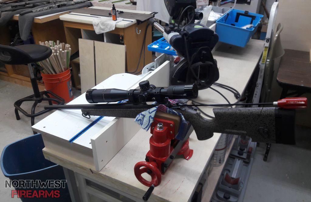

My vise has wood on the jaw faces which work for many situations. Also use shop rags around the firearm in the vise as well.
