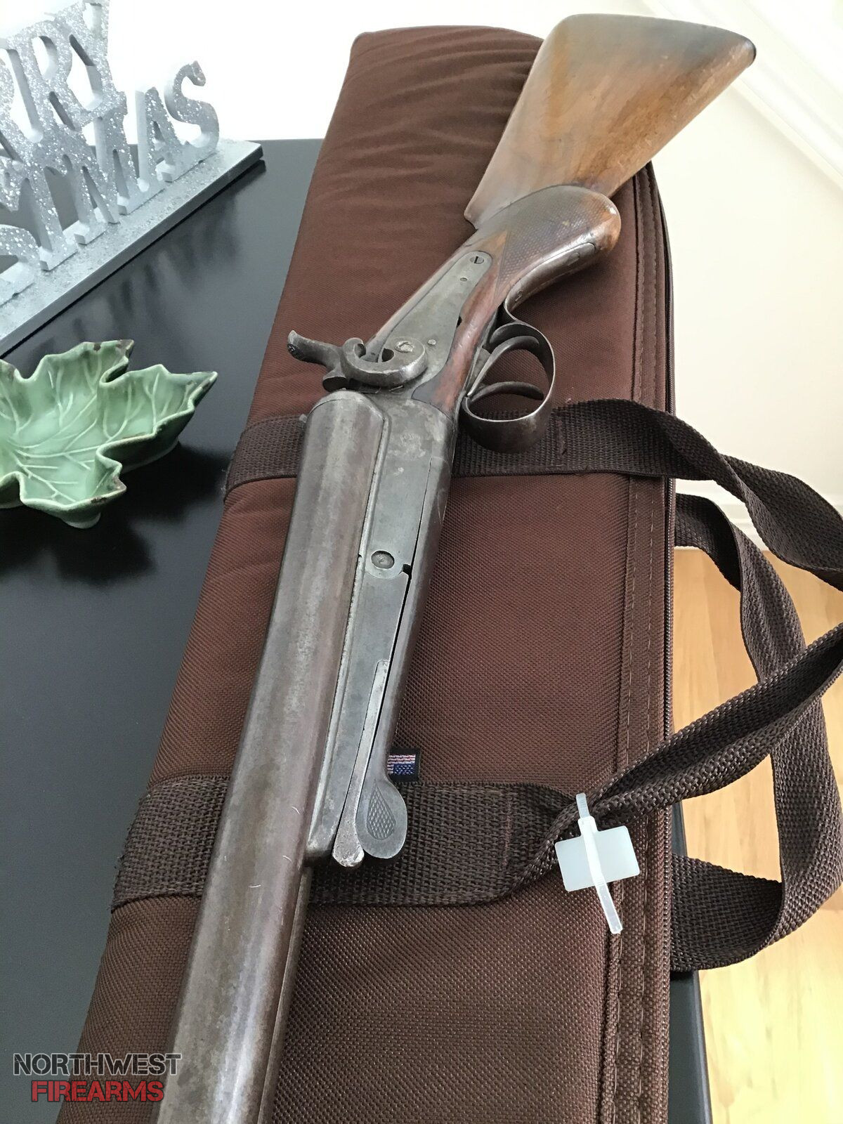

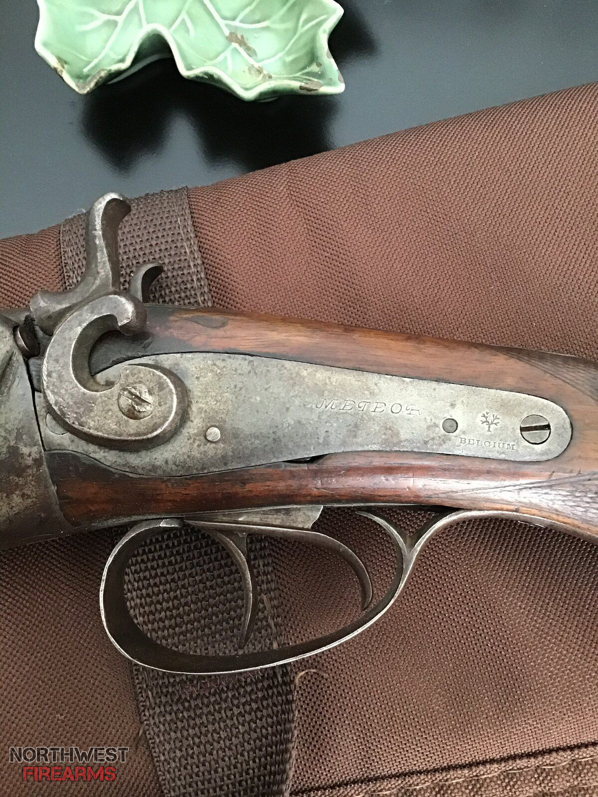

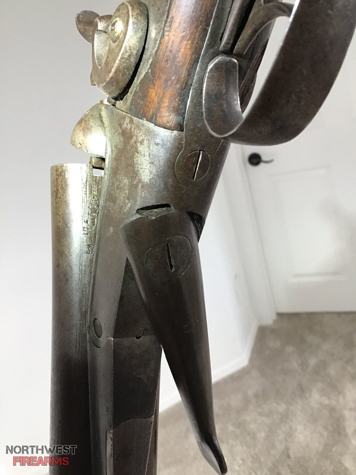

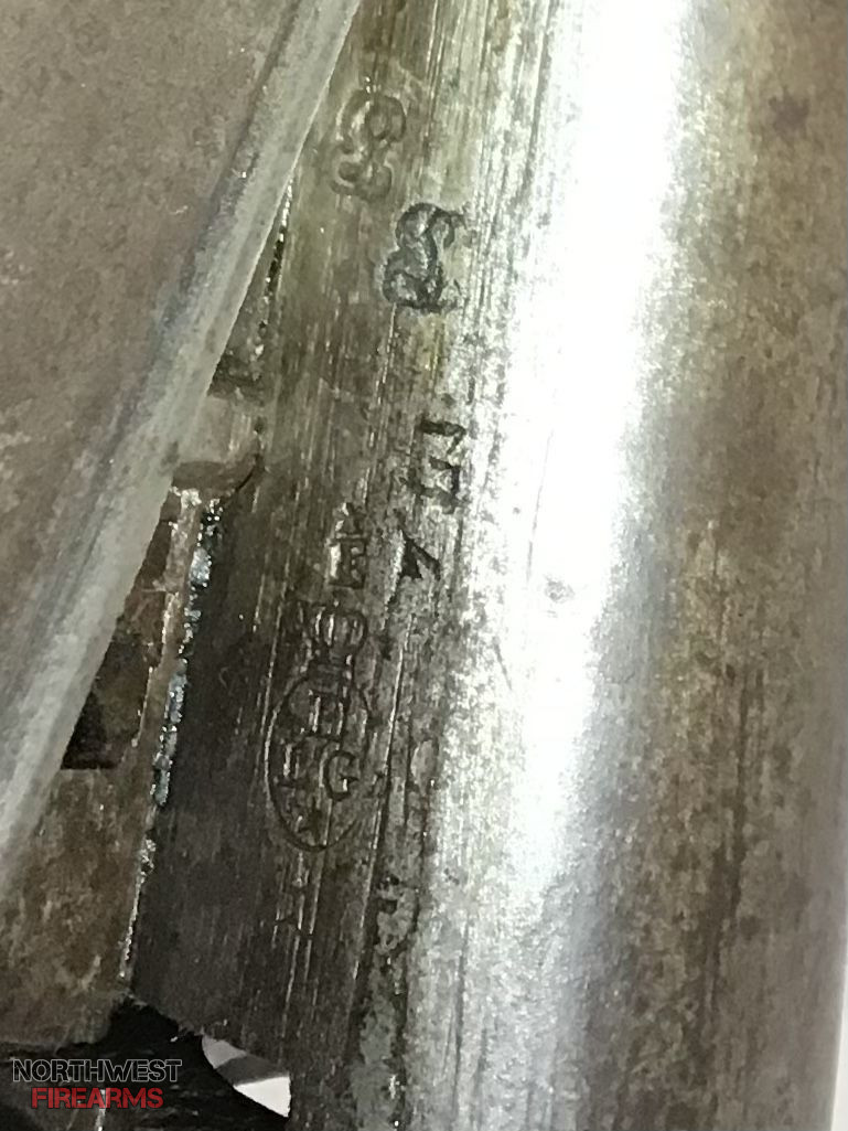

Just picked up a great old wall hanger Meteor 12ga, “Belgium Laminated Steel,” side by side. I have no history to share and I’m trying to find out more about it. I’ve run some searches on the company and Belgium doubles but almost nothing. Do you have any information about this Belgium?
The pics of the proof marks are the best I could do...thank you in advance:

The ELG over crown dates it after 1854, and the 18,2 is the bore in mm - 12g, as you note. Any chance of all the markings you've missed, and horizontally, please, to save me trying to angle my monitor?

Final proof is the crowned ELG mark.
The Perron (tower) indicates provisional blackpowder proof even on guns later voluntary proved with smokeless powder; which are marked with a Lion over PV. If there is no Lion over PV, the gun was NOT proved for smokeless powder.

NON POUR BALLE - choked unrifled bores used 1878 - 1897
1898 - 1910
– Bore in mm (22 cm from breech) and muzzle (choke constriction) appear next to each other after ‘choke’
1910 – 1924 – Bore in mm is over muzzle dimension

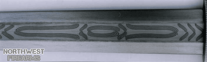

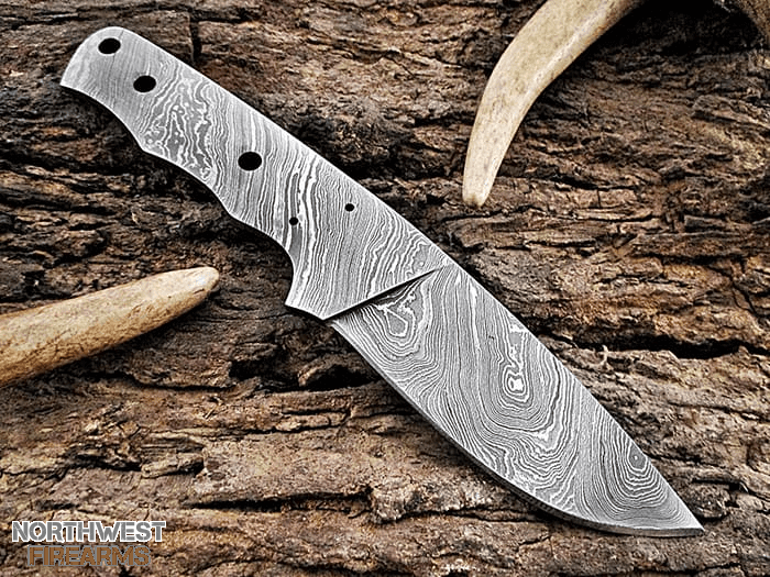

Let us agree that barrels are not made from 'Damascus', but that the method of making them gives them the appearance of being made from Damasque - a decorative form of fine silk fabric with a multiple weave that 'corruscates' upon the eye, originating in Damascus. In other words, so-called Damascus steel has the appearance of this material with its multiple swirls. It can also be formed, during the forging process, into making its own internal pattern, adding to the intrinsic beauty of the either the blade or the barrel - this is known as 'pattern-welding'.
This is a Damascus blade -
This is pattern-welding -
