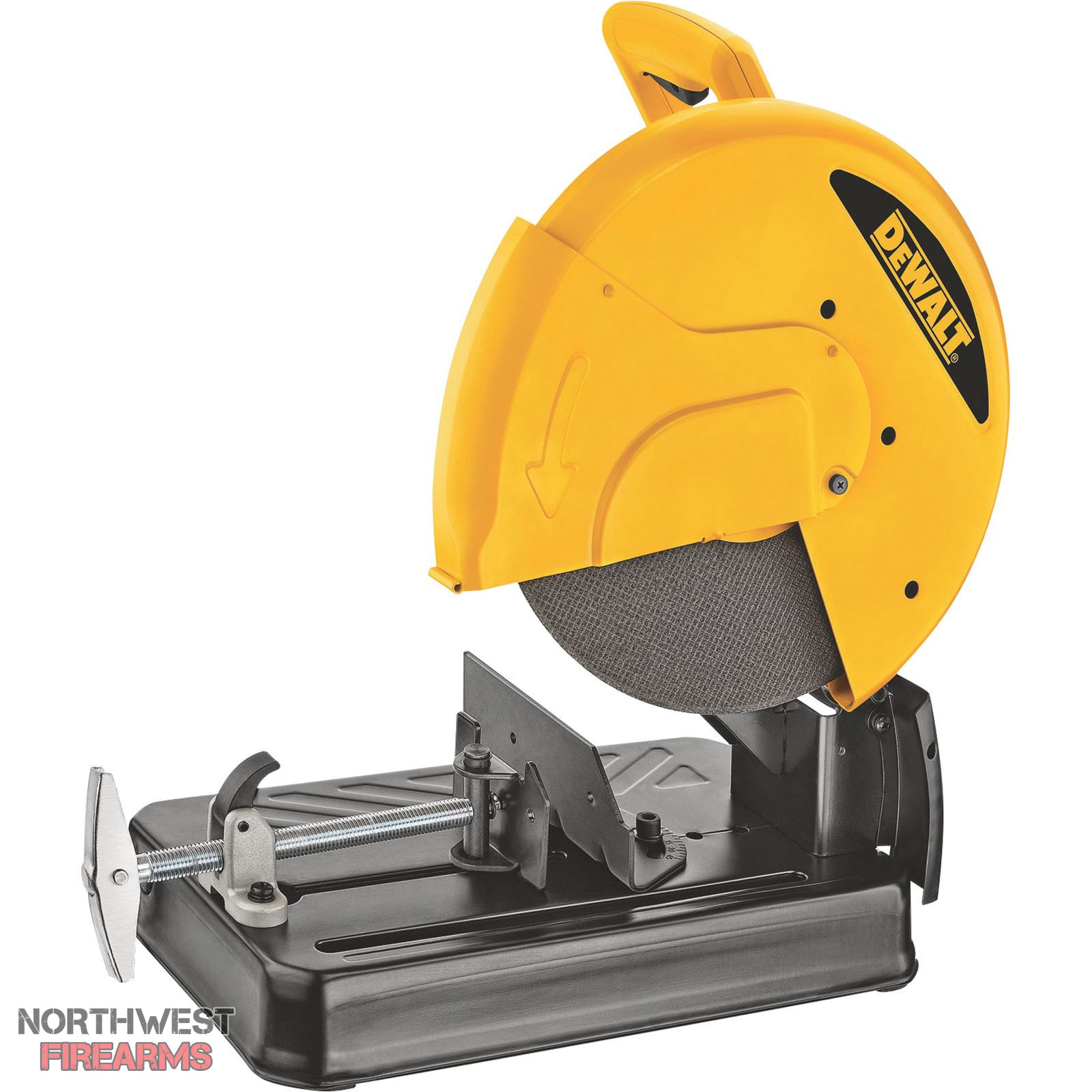

Or you could just get one of these and do it yourself!
I did consider doing this myself but there is some welding involved where I would need to relocate the lower grip screws, and that is where my skills fail me I am just not confident in my welding skills, so for the time being this is not an option. I will check out alchemy, but if any one has more suggestion I would love to hear about them.
