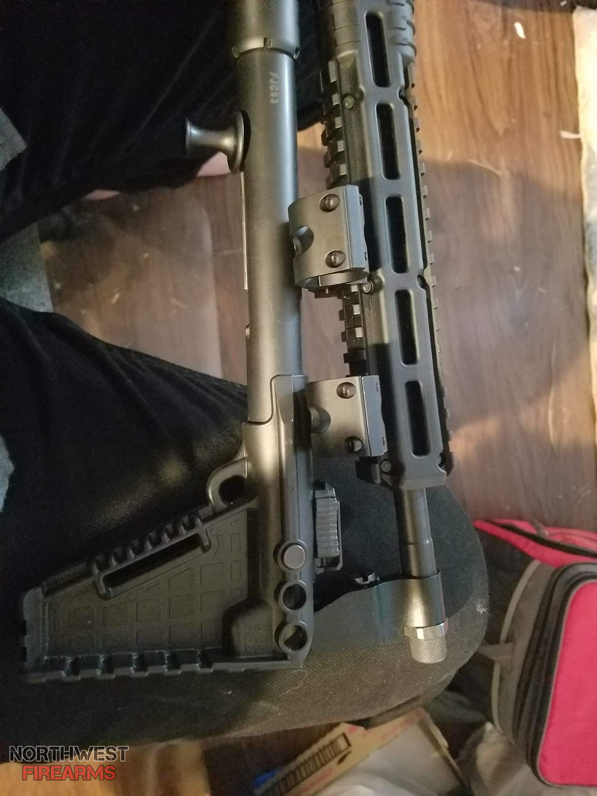

Here's what I'm working with, it's 12-14" to the rear of the rear ring. So I need about 10-12" Eye Relief.
You could always look into getting a cantilever 1 piece mount and mount it backwards. That will bring the eyepiece back farther.
I want to still be able to fold it, those rings are offset 45°, I could get an m lock rail and Mount the rings to that to move them back a little further I might be able to use a scout scope at that point.
I have sold lots of Sub2000s and have a few for myself. What you are describing is a need for what would be a cantilever mount on just about any other firearm, or keep it simple and look at pistol scopes. No problem getting you the relief you want, prices go up fast though.
Example with 20" of eye relief: http://shop2.gzanders.com/optics/simmons-prohunter-pistol-4x32mm-truplex-black-matte.html and only weighs 8 ounces and leaves half your budget untouched.
