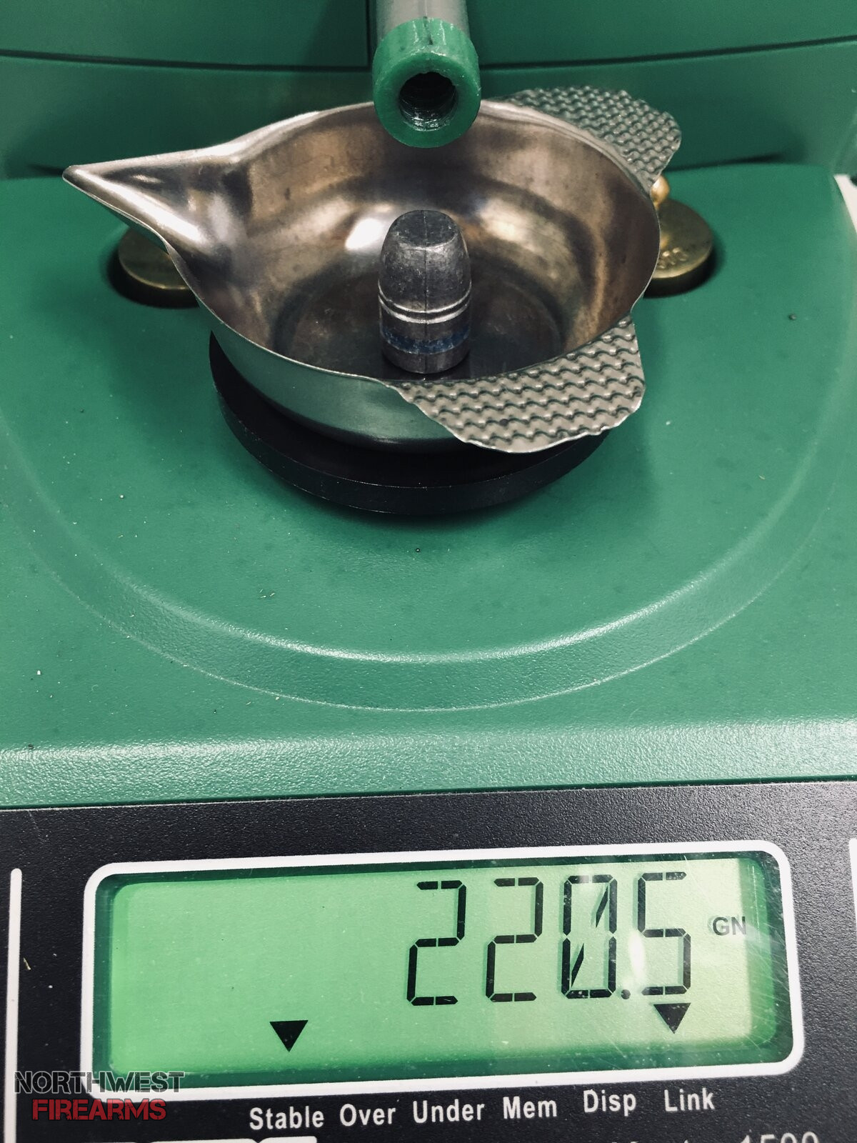

I recently acquired some 220g RN 44 mag bullets (thanks @LHancock) and I am wanting to load them to shoot in a lever action 44 mag rifle.
Most all of the research that I've been able to find is calling for A#9 powder, which I do not have.
I have very poor google foo abilities today.
Does anyone here have any alternatives that they've found through their years of 44Mag loading?
The powders I do have on hand are Bullseye, A#2, TiteGroup and H-110 (W296).
Thanks in advance.
