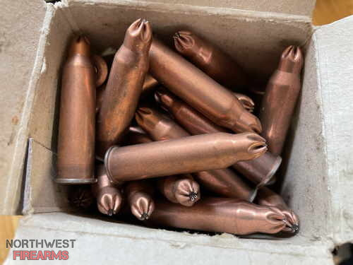

Some years back I did buy a whole bunch of 7.62x54R blanks. They were really cheap, and I bought a lot of them, but then I couldn't think of any practical use for them at all. I found that if I took a .31 round ball (I have a mold- same size as a piece of #0 buck shot), and gently pushed it into the chamber throat with a wooden dowel, I could chamber and shoot a blank behind it, with reasonable accuracy.
In general, it's very bad practice to ever put a projectile in front of a blank, so I recommend against it even though I did it. It's just not designed for it, and there's a risk of damage. The reason I got away with it was because the little .31 round ball is light and has a very short bearing surface in the bore. I would NEVER put a regular bullet in front of a blank.
It worked, but I gave up on it pretty quick, just didn't use them. Real cast bullet loads were way more practical. So I have a bunck of blanks in my garage that I'll probably never use. They were cheap enough that it doesn't matter.

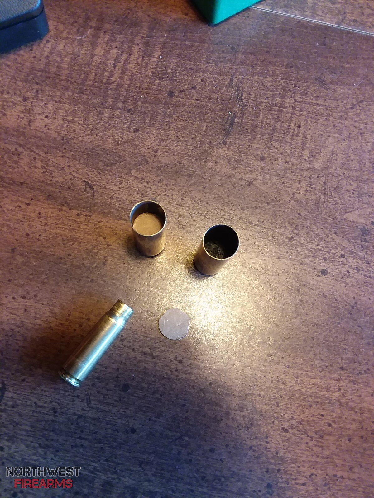

Here is the process I used.

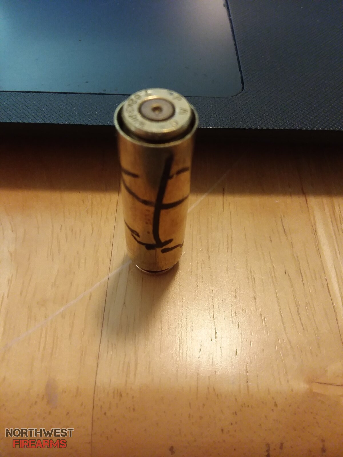

Step 1. insert 50 Beowulf case with (no primer, no powder) and a 7.62x39 case (also no primer, no powder) upside down in 50 Beo case into the rifle (full battery).
Step 2. insert projectile from muzzle end and ram down until it hits the combo cases inserted at step 1.
Step 3. eject the combo cases
Step 4 insert charged case to full battery and the rifle is ready to fire.
Since I didn't have a 50 Beowulf die set I used the decapping pieces from a Lee 30-06 Loader set to remove the spent primer, I was able to install a new primer with the same reloader set or I could do it with a 7.62x39 shell holder and the priming arm on my Lee press. I then charged the case with about 12 to 13gr of Unique powder. After putting the powder in the case, I put a circular piece of thin cardboard over the powder charge to keep the powder from spilling out of the case. These could be preloaded like this for reloading the rifle in the field.
Since I didn't have a 50 Beowulf die set I used a decapping pieces from a Lee 30-06 Loader set to remove the spent primer, I was able to install a new primer with the same reloader set or I could do it with a 7.62x39 shell holder and the priming arm on my Lee press. I then charged the case with about 12 to 13gr of Unique powder. After putting the powder in the case, I put a circular piece of thin cardboard over the powder charge to keep the powder from spilling out of the case. These could be preloaded like this for reloading the rifle in the field.
This loading process will have the effect of an enlarged case capacity. The charge I used should've created less pressure than if it had been used in a case with the bullet loaded in the case.
