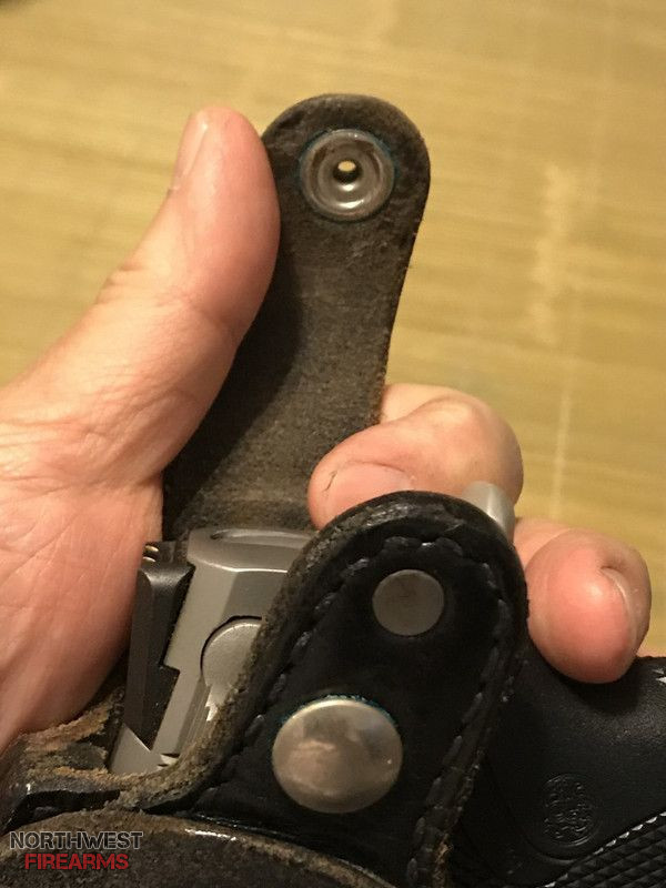

I've got a nice Tex Shoemaker holster for a 1911 with a thumb break snap. Pretty sure the back of the snap was covered with something that must have fallen off. If I use it as is the back of the snap will scratch up the gun. Any suggestions on what to cover it with to prevent scratching?

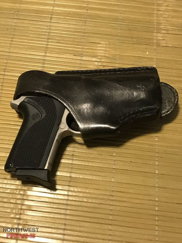

I have two examples of Tex Shoemaker & Sons off duty paddle holsters with the thumb break snaps. They both do not have any sort of "backing" to the snaps.
That being said....I guess....if you wanted too, you could add a backing to the snaps or not.

I found this holster "new in the bag" at a yard sale a year or two ago. Maybe it had been used briefly and then returned to the bag, but if it had been used there wasn't any real evidence of it. The reason I bring this up is, I don't know if you got yours new or not, but this one had something on that snap that fell off. I don't remember what was on it now. And obviously I want something that lasts a little better.
