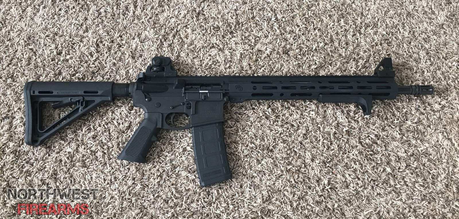

Here's a quick accuracy report for the KG Wraith Elite upper. A buddy wanted a compact coyote gun so we put this together for him.
Basics-
16in Ballistic Advantage barrel. 1/7 twist
3.5lb Rise Armament trigger.
Noreen lower
LPK from KG
Scope is a $98 NcStar 6-24x I picked up in 2001 at a gun show. It's mounted on a B-Square Ar mount. (a 1-6 is going on the gun but this scope always holds zero and is my quick go to for grouping)
1st- the lpk from KG is meh. I had to grind and buff the safety detent as well as the front take down detent to get them to work smoothly.
2nd- the rest of the upper is good. Solid rail, nice barrel, nothing marred or stripped. Bolt and Carrier are mil spec and normal.

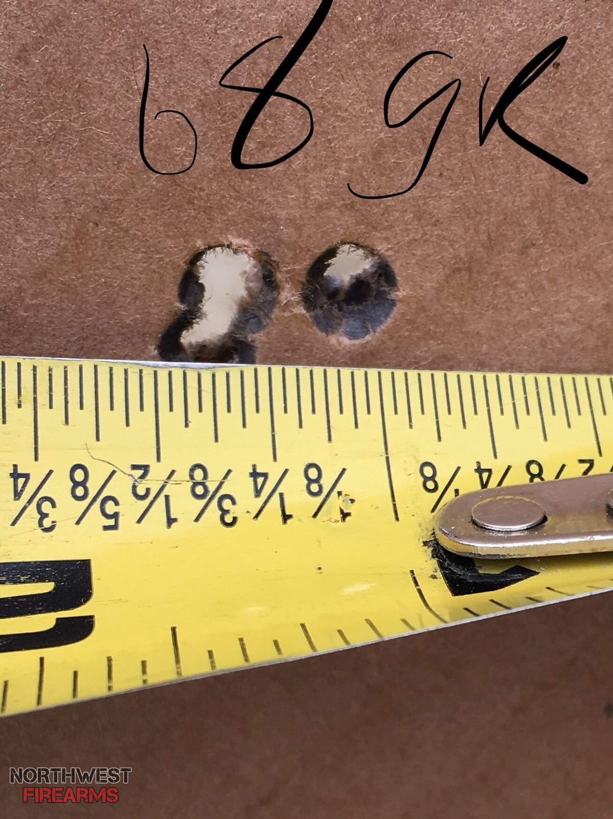

Results: 100yd from bench with rifle rest 12x on scope. Wind 1-4 mph 1/4 value. 45 deg out.

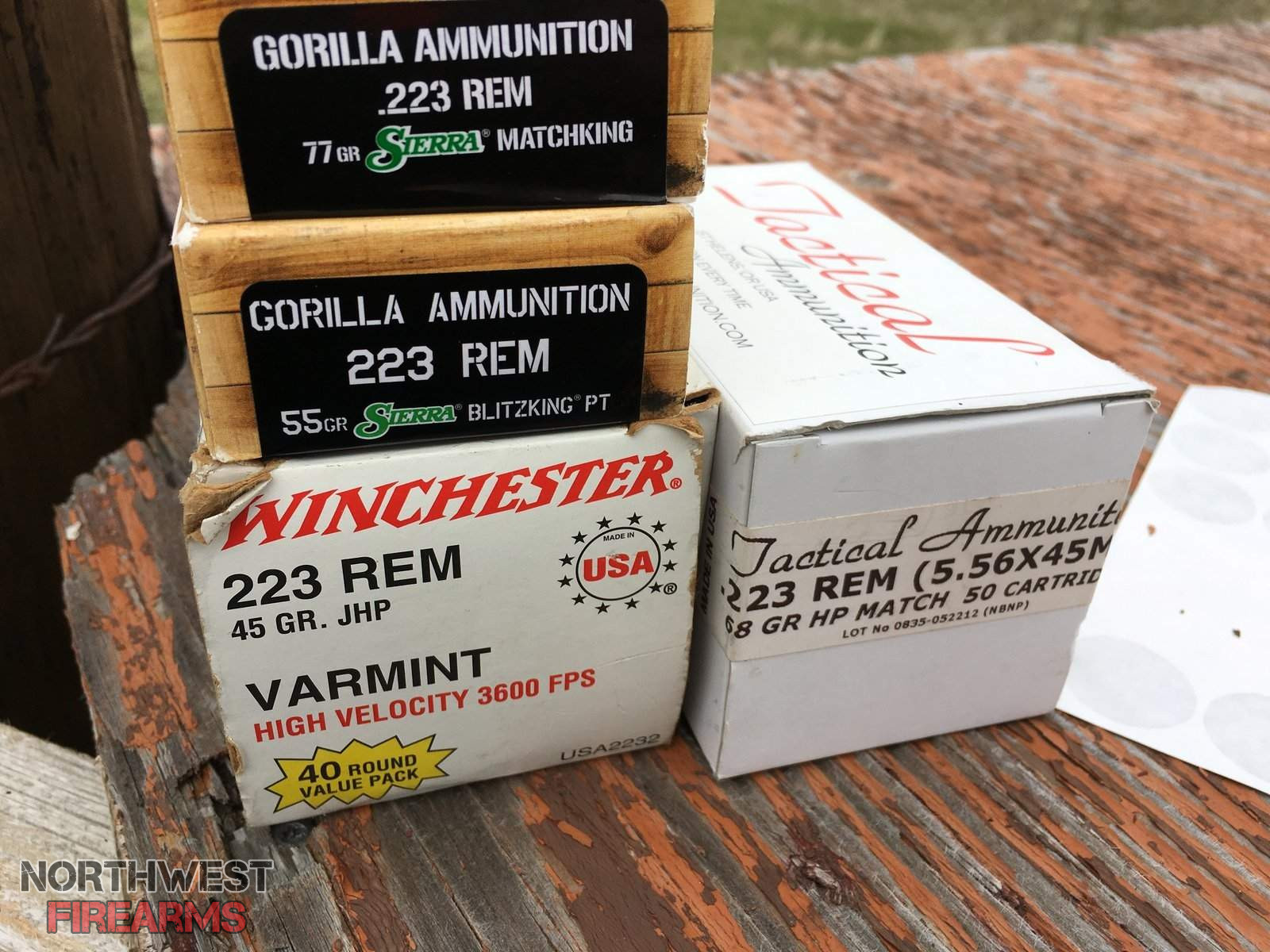

77gr match 3/4in group
68gr match 3/8in group
60gr vmax 1in group
55gr blitzing 1 1/4in group
55gr fmj bulk 5/8in group
Win 45gr jhp 3/8in group

B.. Tactical Ammo (out of St. helens OR...a stones throw away) makes a hellofa good bullet. Thier reman ammo is also great. They stand behind it too. I've been really impressed with their customer service!
