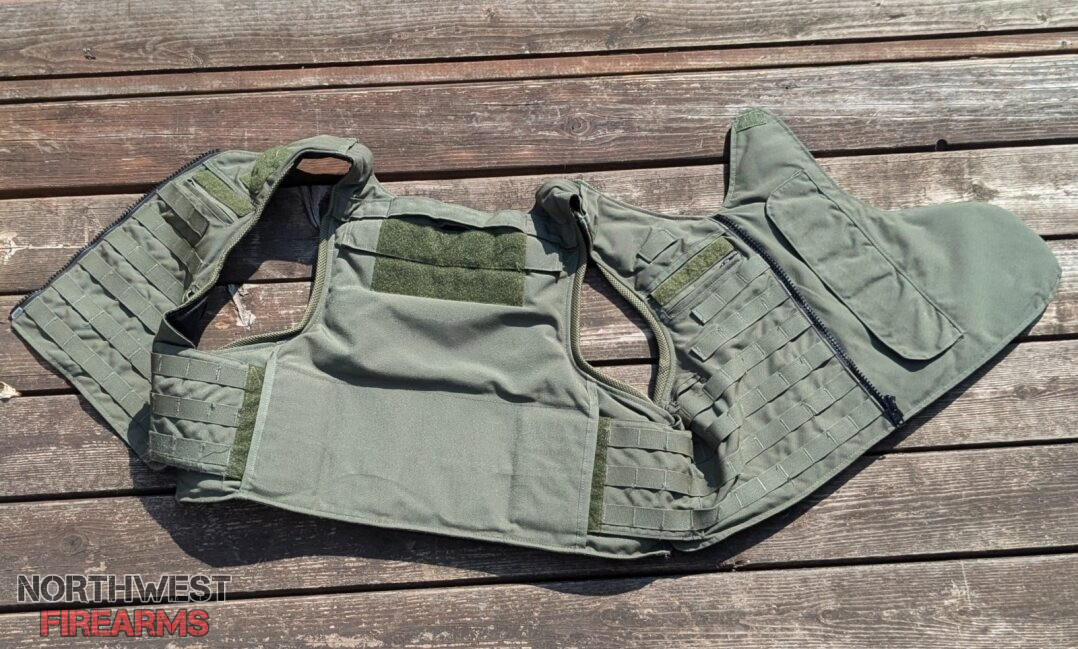

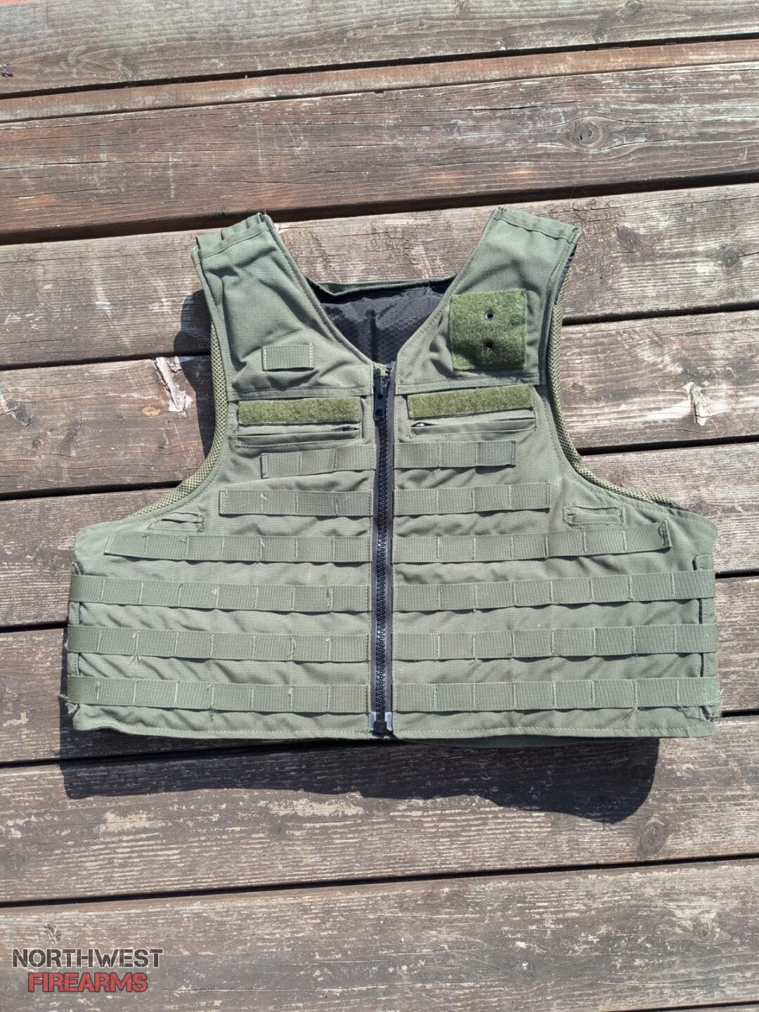

I would love to know more about this vest. It is expired (?) and was discarded a Sherriff's Office. I can find no markings. Guessing it is a 2XL. I would love to trade it for a much smaller one that may fit.

Looks almost exactly like the Safariland Protech Oregon City 2.0 armor carrier
Maybe the original version (1.0)?
Edit, yeah it's the original version

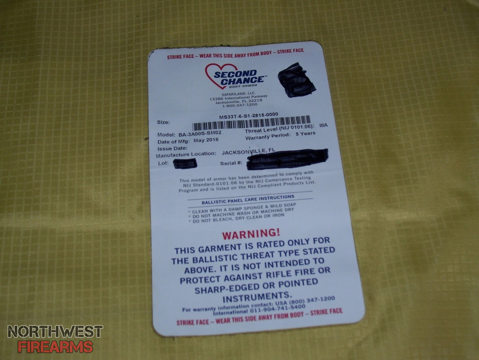

It is a Second Chance level iiiA.
Info was on the removeable panel in front .I have no idea I could take it apart...
Seems Second Chance went under after a settlement. "50 percent of used vests could not stop bullets that they had been certified to stop" In 2004. This was retired for a sheriff's office in 2021. And manufactured in 2016. I'm confused...

What put 2nd chance out was an at the time new materiel. In Japan they came up with a new material to replace Kevlar. The stuff was GREAT, until it was not. One ad used to show a guy ringing a vest in his hands like it was a towel. Stuff was far lighter and easier to wear. One BIG downside was it degraded with UV light. So even indoor lighting was working on it. When a few LEO's got shot and the vest no longer worked a LOT of finger pointing ensued. The maker claiming they warned those buying. Galls somehow did not hit real hard. 2nd Chance went out. They had tried to recall the vests out and add Kevlar to them but damage was done. Later the name came back again not sure who was making it but with Kevlar of course. As for the one you have its NOT something I would ever trust.
It's the Zylon material that put Second Chance out for a while. Second Chance brand got bought by Armor Holdings in 2005 after the settlement in 2004. In 2007, Armor Holdings got bought by BAE Systems (same group who also bought Safariland, Specialty Defense Systems brand and several other brands). As of 2025, Second Chance is a part of the Safariland Group of brands. So the 2016 inserts are not Zylon, but proper Aramid Kevlar and part of Safariland.

IIRC based on a memory of a Massad Ayoob article there was also an issue with them losing effectiveness when they got wet (a common problem with Kevlar) and the waterproofing material didn't actually work to the point a officer in the southwest was injured when his sweat saturated the vest

What the makers claim is 5 years from date of manufacture. So makes sense that a department would get rid of it after 5 years. As another poster mentioned after 2nd Chance went under the name was bought. They were still being sold then with the same name and of course made with Kevlar.
