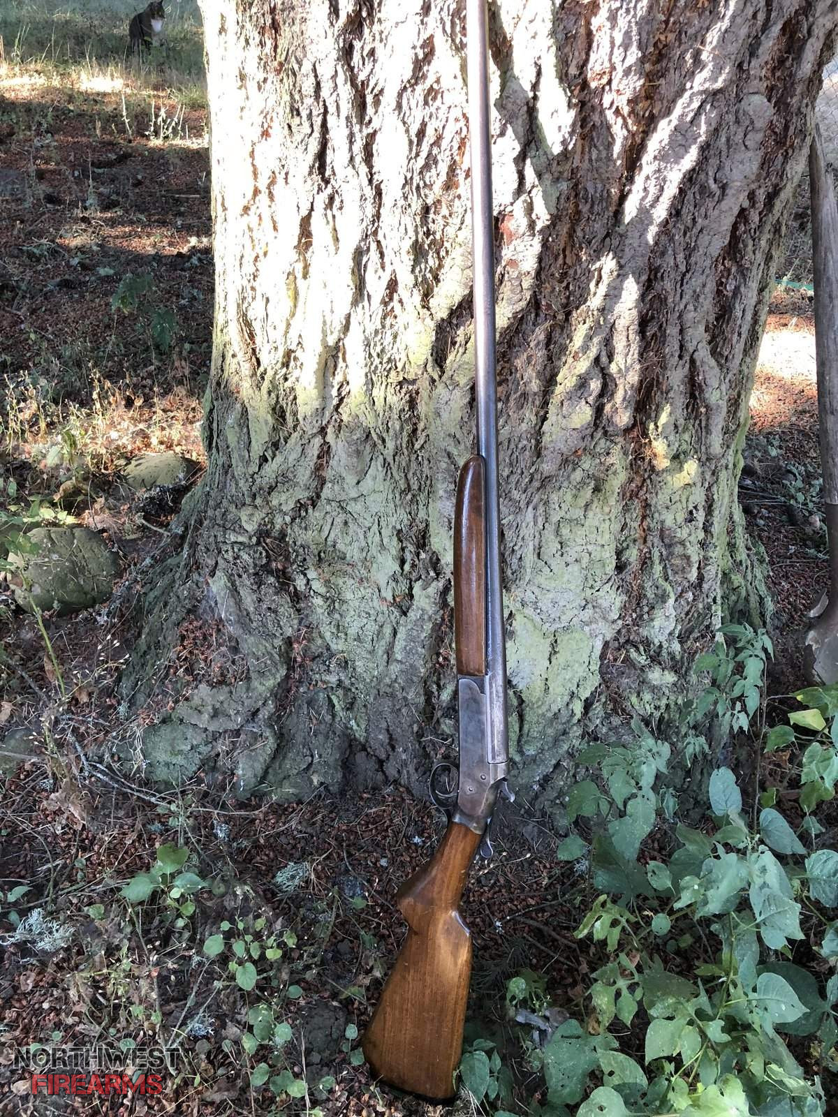

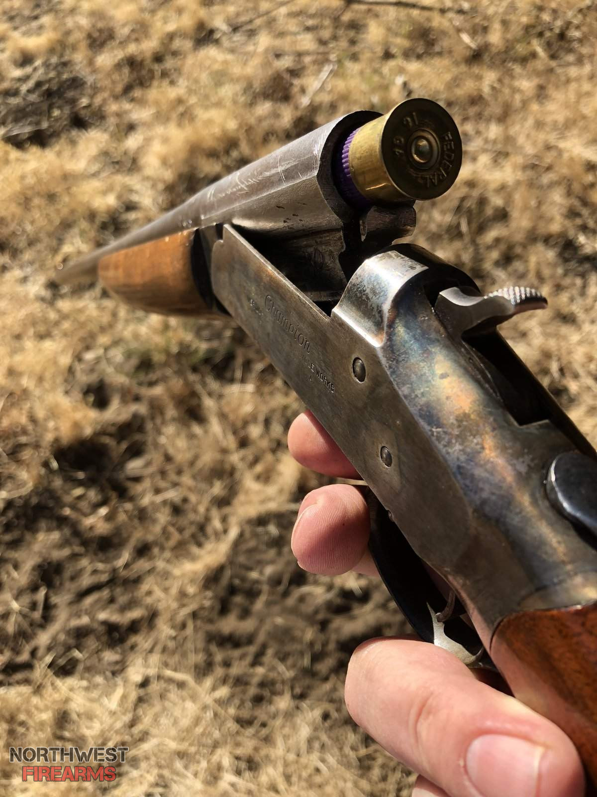

Well, only picture yet but it's a 16ga now. I had to file the mounting and latch areas on the barrel. Some light filing on the lower outside of the chamber area. Very little, mostly to smooth out dings there. I had to put small spacers under the latch assembly for the forearm to latch solidly. Firing pin hitting the primer right on the mark. Shot 8 rounds and works great!! Still will look out for a 20ga barrel.:)
Wow! congrats!
That gun looks amazing!
...if you can, post a short video (or link, if you have a YouTube page). I'd love to see that thing in action.
Very happy for you, man. :s0155::s0053:
Dean
