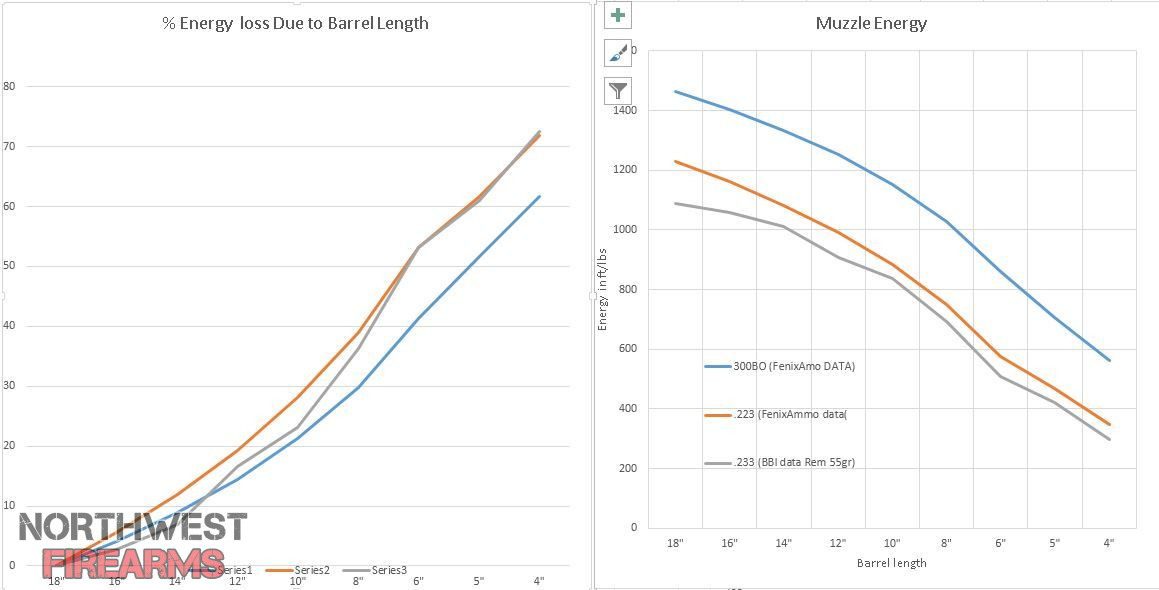

What do u mean by nothing gained over 9"? Haven't looked at graphs of subsonic but for supersonic ammo the gains beyond 9" are big. 581CB46B-F098-41D4-AD42-C67A7E4E25B8.jpeg

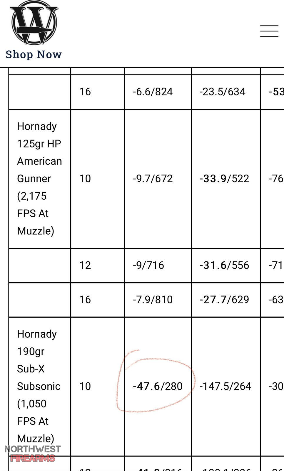

Also what range u intend to shoot at and amount of drop (and energy) u can live with. I know one source (wideners pasted below) used an often quoted assumed (not measured) 25 FPS loss per inch of barrel length. However if u look at the fenix data it shows an avg 44 FPS per inch for supersonic round. Anyway, using the assumed 25fps loss rate, wideners calculated a 47" bullet drop (and only 280 ft/lbs energy) at 200 yards for 190 gr subsonic round. I wonder how big drop would be if they used an assumed value of 44fps loss (u could plug it into a ballistics calculator to find out if u want). It's Probably a heck of a lot. that doesn't mean it's "bad", it just means that if u intend to shoot subsonic at any significant distance through a short barrel u may be really surprised at the amount of holdover needed and how much energy bullet has (ie it's a trade off).
Also fenix ammo data for Supersonic for reference:
