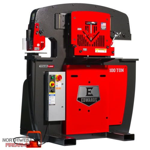

Hit a local steel fab shop up. Annular Cutter in .750" would do that no problem but the cutters are like $150 each and some effort to set up to cut. The best thing a fab shop might have is an Ironworker (hydraulic press tool) that can punch a .750 hole in that for you. Take this 100 Ton Edwards for about 10 seconds to punch each hole with no issues. Both of these options will make a nice round hold for you. Lastly would use a drill, that's a large hole for a drilling opp. It can be done but would take stepping up from .25" and time. Need a decent drill press or better yet a milling machine. CNC mill would be the ultimate as it can mill a circle into your plates to cut the hole.
