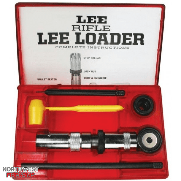

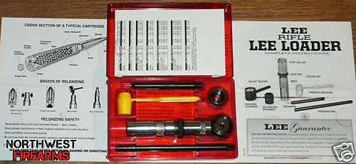

I used a Lee Loader when I was a teenager to load 38s for my Dan Wesson 357. Just need a hammer and a chunk of 2x4 and your consumables to reload.
The hand press would probably make better reloads though.

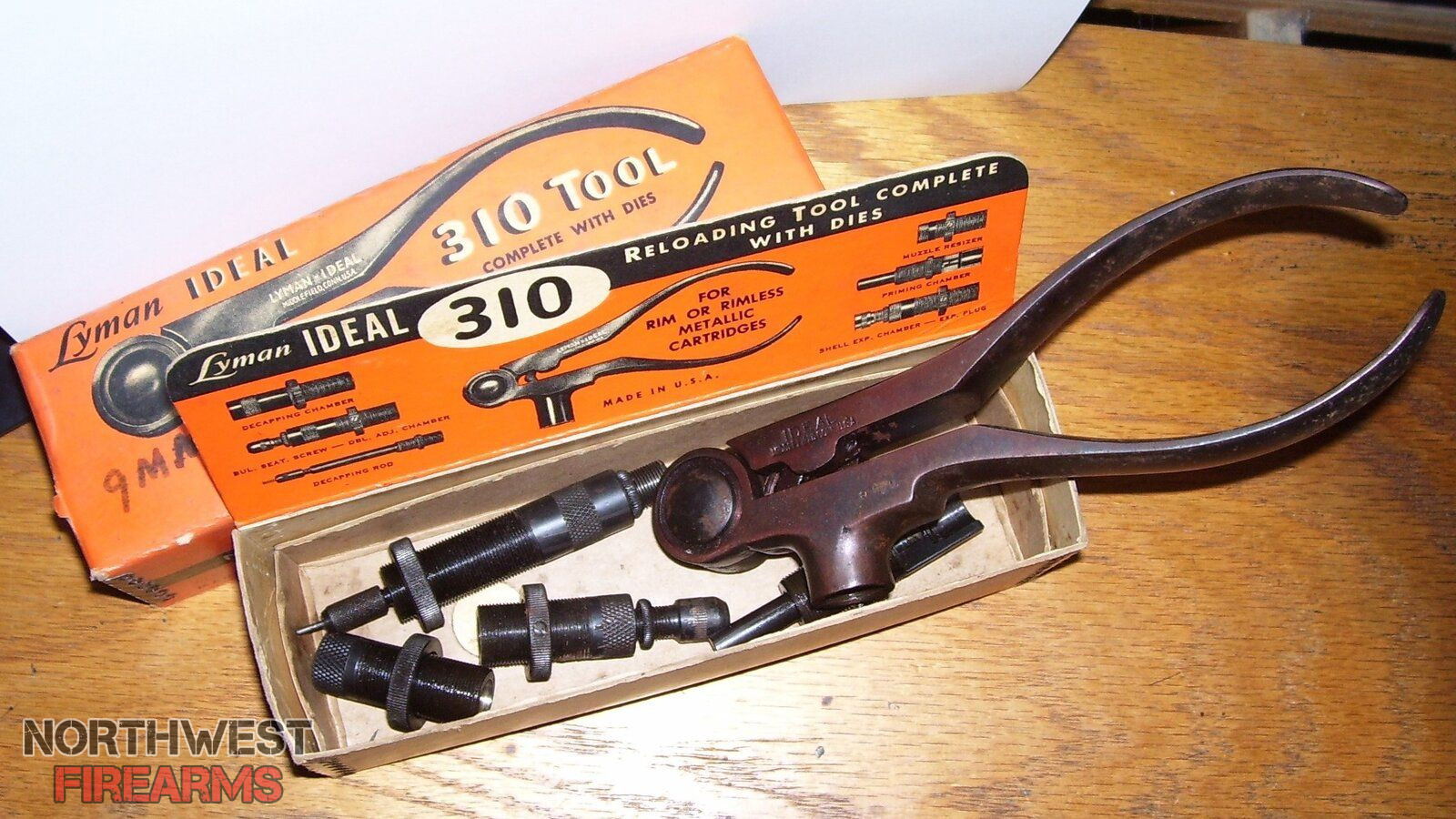

These are even smaller but finding them in this condition and complete can be a challenge. I get such things given to me or with other stuff sometimes. Never tried them but they must be ok if that's your thing. I guess if you're late to the game on stocking up on 9mm ammo or reloading gear these might be the cats meow.......
I like mine, and use them pretty frequently afield, pretty handy to have with you when factory ammo is hard to come by out in the middle of nowhere! Can also load .45 Colt, and both calibers use the same bullet moulds!
Might be old school, and nostalgic, but they are damn nice to have!

The minimalist set-up for reloading are those Lee Loaders mentioned by MrMillspecer. The hand presses these other folks are referring to are probably the next best thing. I bought some of these stands from Harbor Freight Search Results For "Grinder Stand"
Lee Loaders aren't gonna be a viable option in a motel room.
