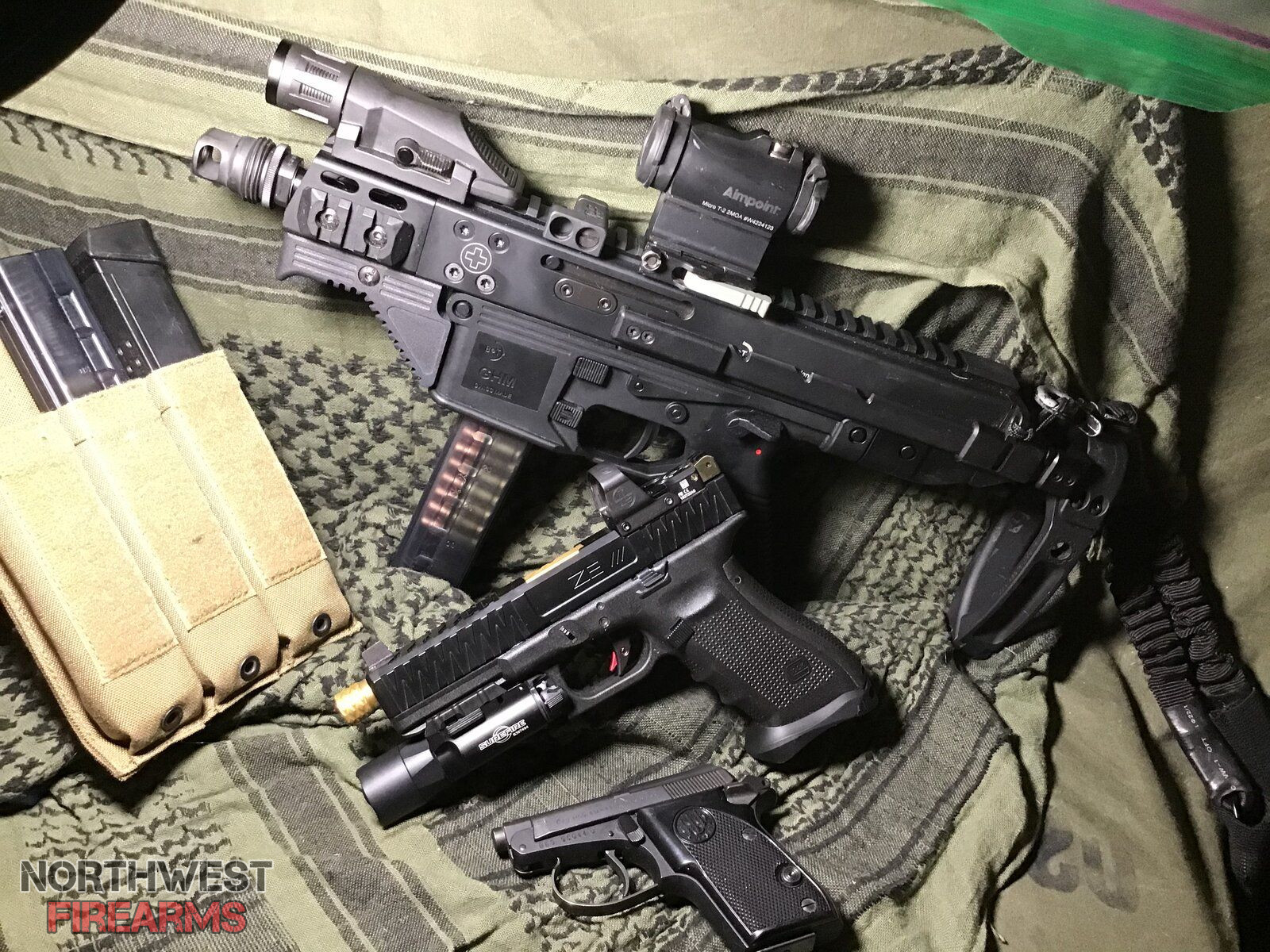

You can see the reduced reach in my pic.

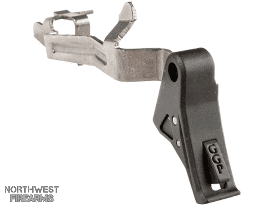

Just incase anybody was wondering. I purchased and Grey Ghost Precision Combat Trigger.
I will update when I get it in the mail.
