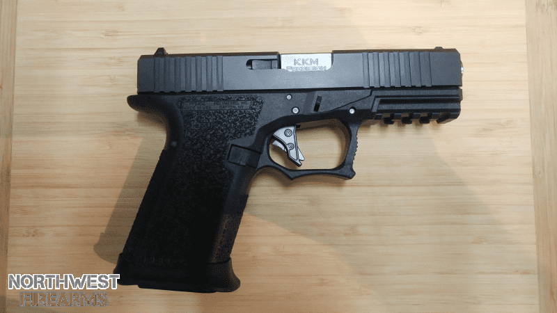

OK, let me be more clear. This is a ground up build. I have no trigger, bar, or anything. Also needs to be gen 3 compatible. ;)
$155.00 on ebay
I might need me a fared magwell. Looks good on the P80.
I can send you a 3D file for a P80 magwell or if we ever link up I can print you one.
