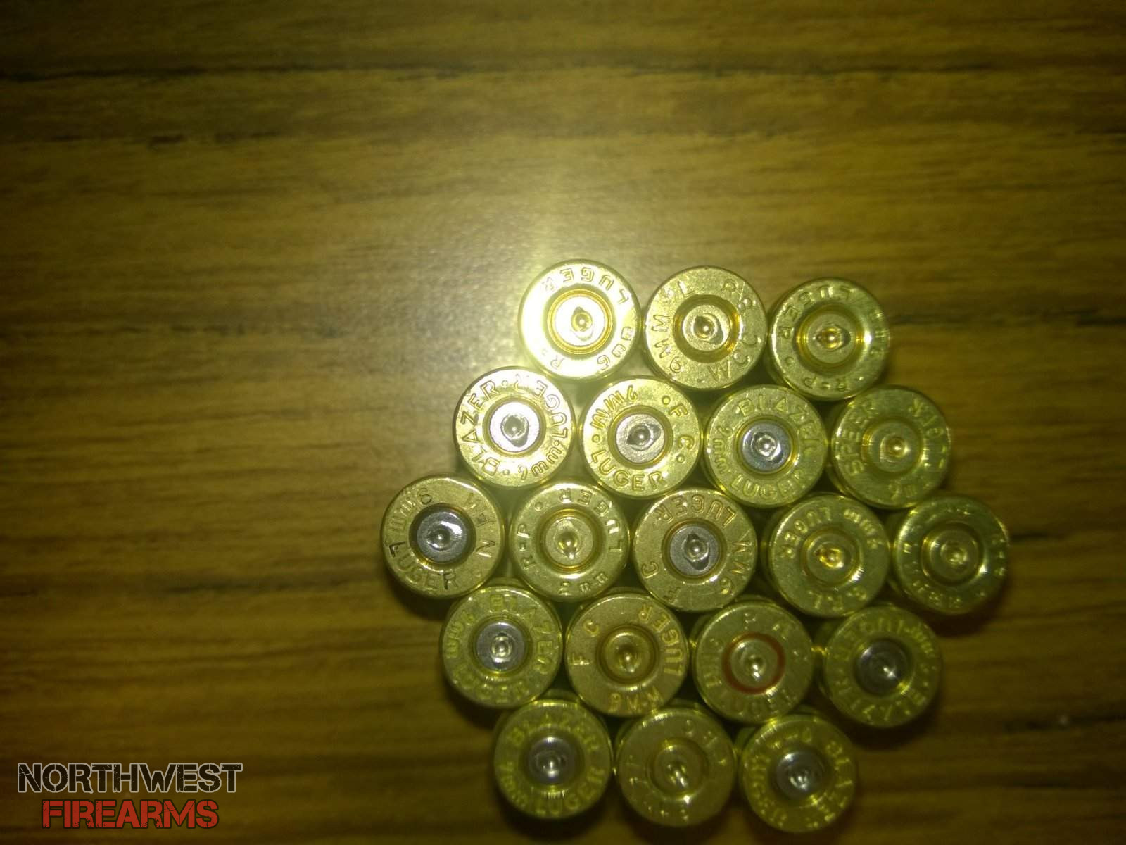

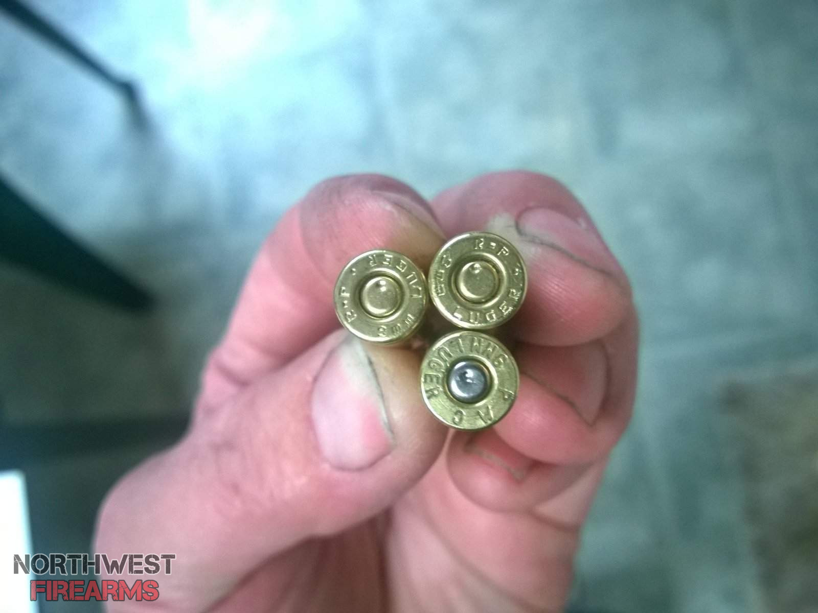

Jeannie bought a new Glock 43 and decided to use it for our class at Cerberus. On Saturday she fired about 125 rounds without any noticeable issues. These were the first rounds through the gun since new. I didn't inspect the brass because there weren't any noticeable problems. We cleaned it that night and proceeded to shoot about 400 more rounds the next day. Towards the end of the day she had four failures-to-fire. They were not consecutive, not even out of the same mag load, but probably over the course of an hour or so; we didn't really note the time. She picked up a couple of them and tossed them in the range box and I got the other two when we were picking up brass at the end of the day.
Upon inspection to see what happened I noticed that the primer strikes were way out of center on the four rounds (see picture, only three rounds, can't find the fourth.:mad:). Got some time this evening to look through the rest of her brass and found another twenty or so that are also out of center, though not nearly as bad as the FTF's (See second picture). The third picture is a small group of the rest that I would consider normal. Tonight after clearing the gun I tried to get it to dry-fire out-of-battery and it will. If I push the slide back until the barrel drops about .030"-.040" the gun will still fire. I then tried a G26, G19 and G27 and they all do it as well, though maybe not quite as far out-of-battery.

For those that may ask; yes they are reloads. Range brass, Tula primers (both nickel and brass; a subject for another thread), 6.4 gr HS-6, 124 gr. X-treme plated bullet, loaded on a Dillon 550.

The top two FTFs look like light primer strikes. And too far off center . Yikes !
The bottom a bad or not seated primer, possibly.

I here you. But don't think the primer strikes are off center. I believe their high on the primer.
This is from the slide not being fully forward.
Glocks will release the striker with the slide not quite fully forward.
In this case the high primer strikes did not fire. And that makes sense, since the striker pin protrusion is only so long. And doesn't look to have been able to cause ignition.
If this is insurance against firing out of battery then it worked.
The problem for me is not the high light primer strikes.
That's just an indication the slide is not going forward all the way. That's a problem!

Please look again at the second picture. Those are some of the ones that fired while out-of-battery.
