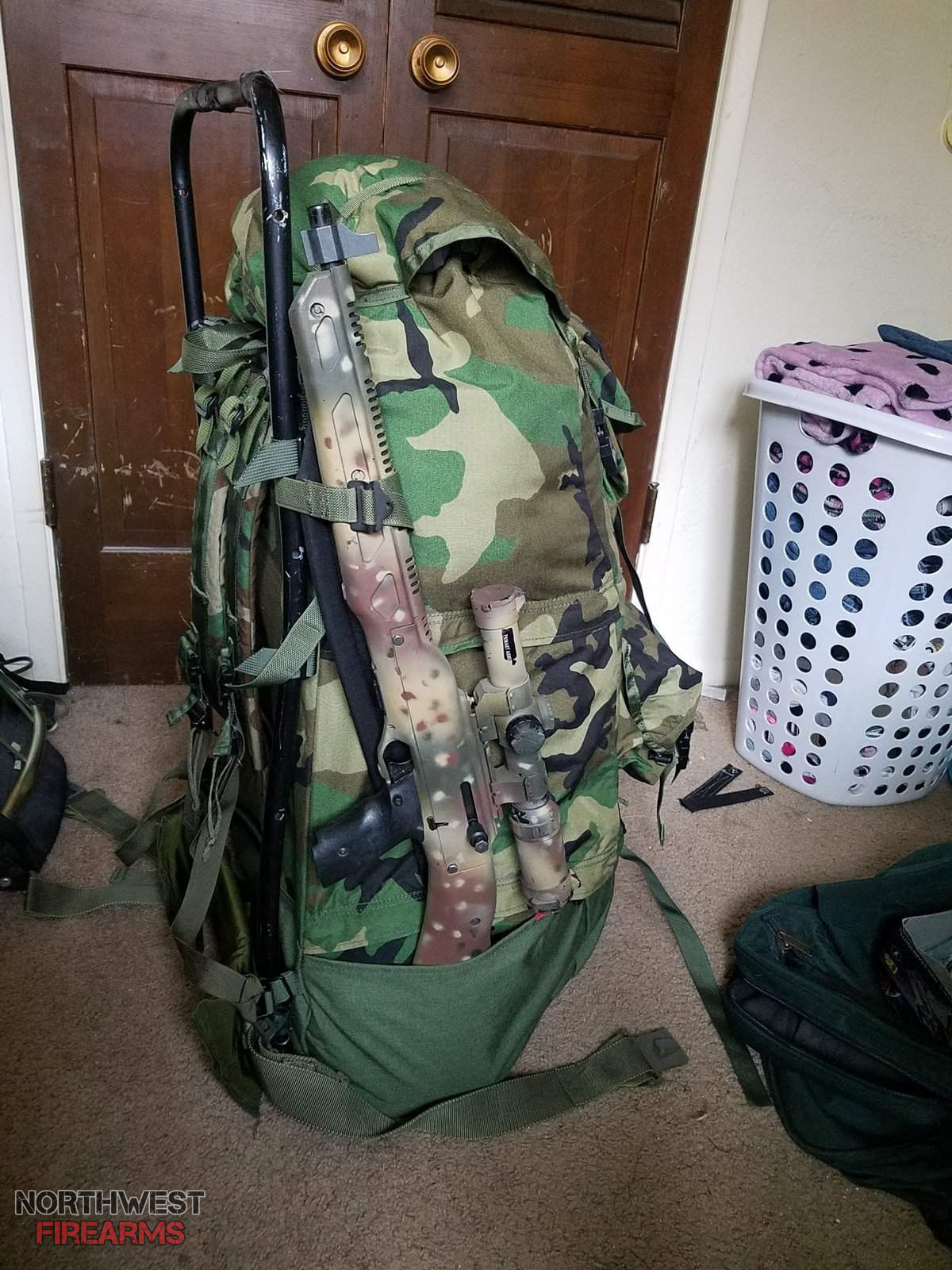

I picked up this 21 year old Mounted Crewman Compartmented Equipment Bag at the local flea market for cheap because it was missing the following items
5x fastex buckles
4x compression straps
2x metal loops for shoulder straps
Shoulder straps
2x D rings for shoulder straps
Basically it was nearly stripped of all its hardware except for the two remaining Fastex buckles... probably cannibalized for ALICE rucksack repairs/fastex mod
So.. I replaced the missing pieces, and added 6 triglide/strap pieces, and modified the D ring bottom units to also have ALICE style ladderlocks and straps to mount to the hiking frame I have, and then I made a couple 2" loop adapters that mounts to the frame via the grommet and pin method, so that I couldd fix the location and use the ALICE Kidney pad on the larger frame. No before pics, but there are unmodified bags out there for comparison.
Its HUGE. Standard 16" AR15 with collapsed stock in side pocket, and old school Hi Point carbine, for comparison against the bag, which is not even stuffed full.o_O
Would make an excellent game hauler if modify the dividers to open up on the inside or as an "I'm never coming home" vehicle bag.

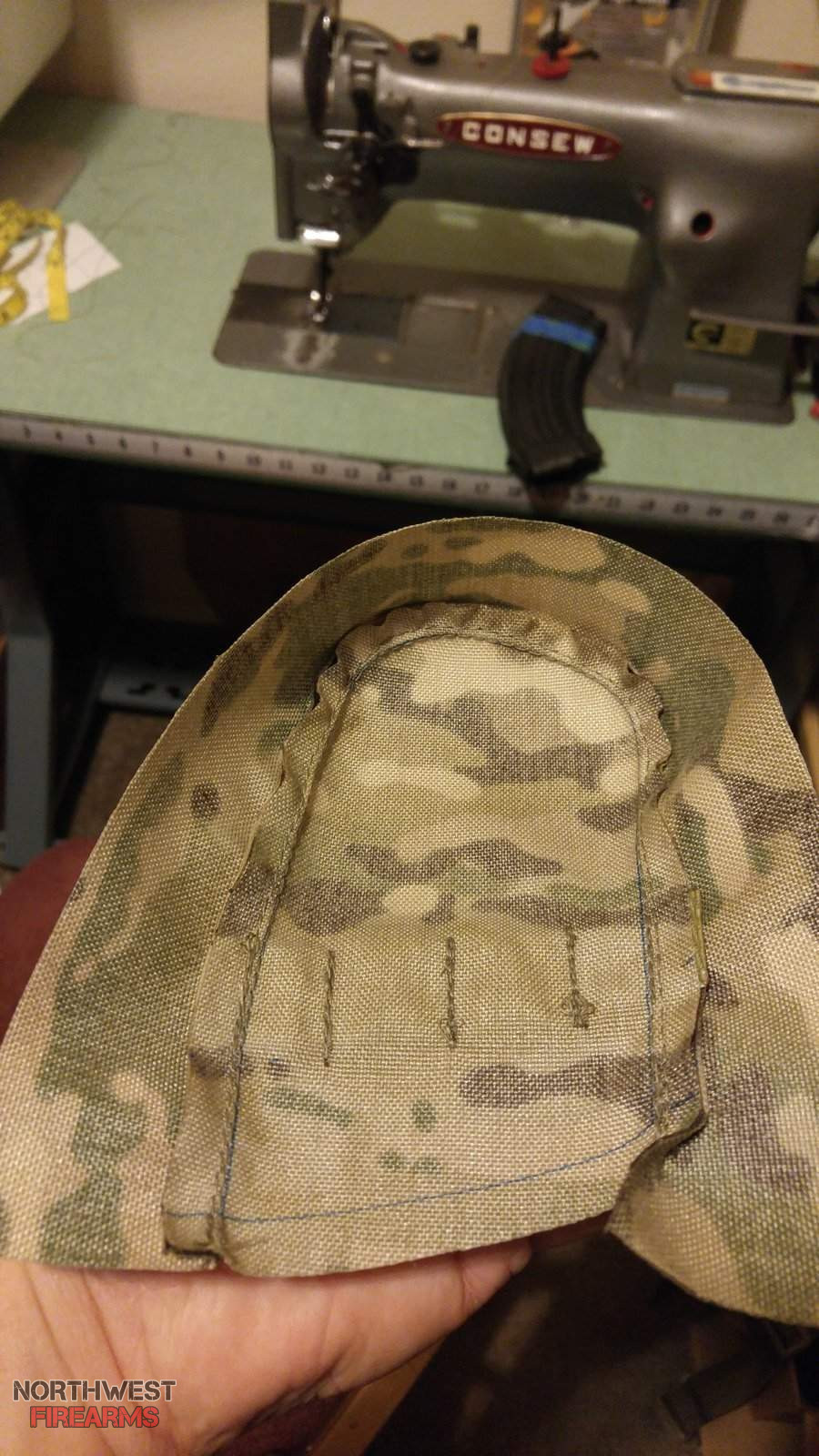

Here is one of my latest projects. It is my copy of the US PALM attack rack chest rig for AK mags. US PALM is out of business so I borrowed one my brother had and copled it. 0221182149a.jpg 0221182149.jpg 0201182241.jpg 0201182242.jpg 0201182240.jpg 0201182240c.jpg 0209181835.jpg 0209181835a.jpg 0201182240b.jpg

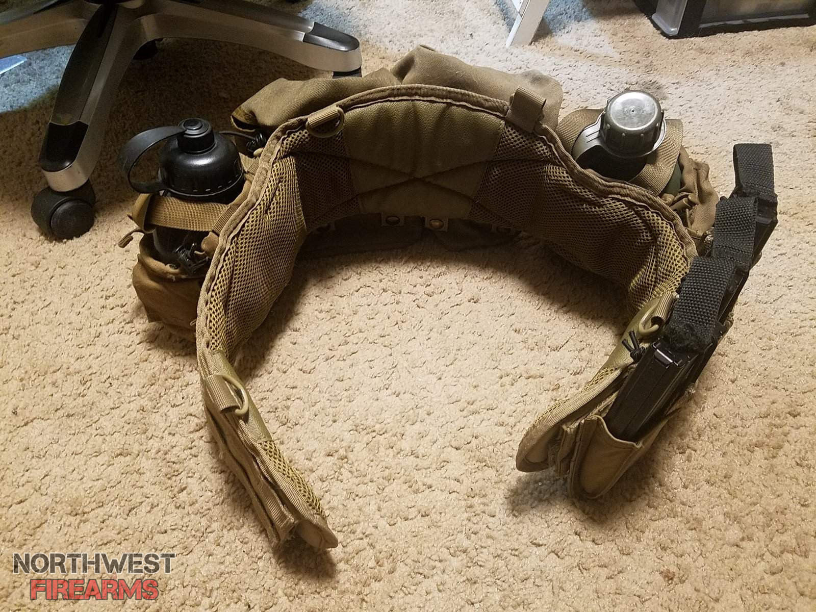

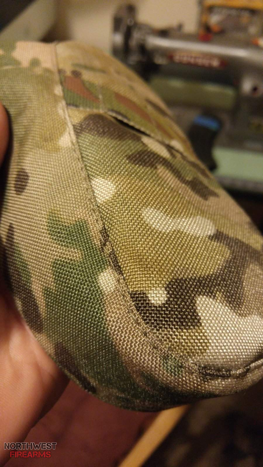

Sewn up a simple slick triple mag shingle in 500D Cordura, coyote brown coloring. Shown attached to Diamondback PC, Eagle LAND CIRAS, and Condor Medium MOLLE war belt pad. I think warbelt is one of the best uses for this minimalist slick mag pouch. 20180509_191930.jpg 20180509_193145.jpg 20180509_193152.jpg 20180509_194751.jpg 20180509_194607.jpg 20180509_174930.jpg

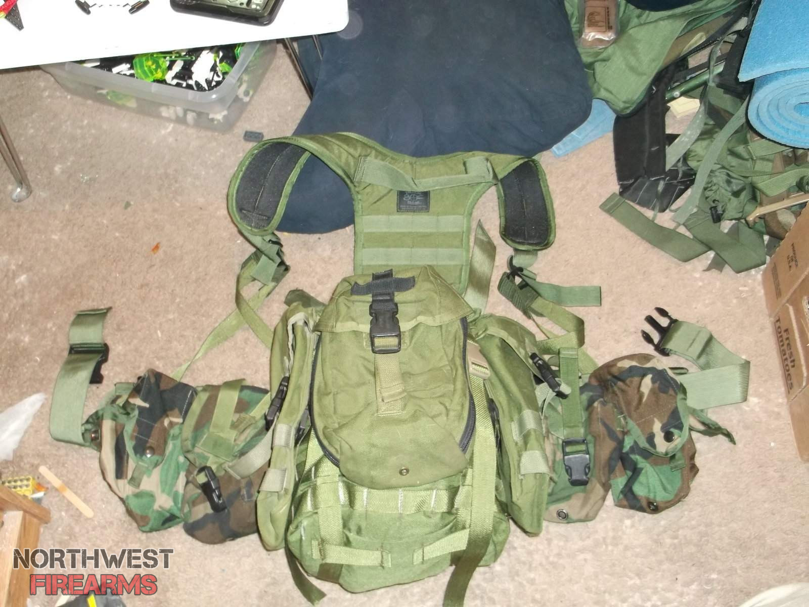

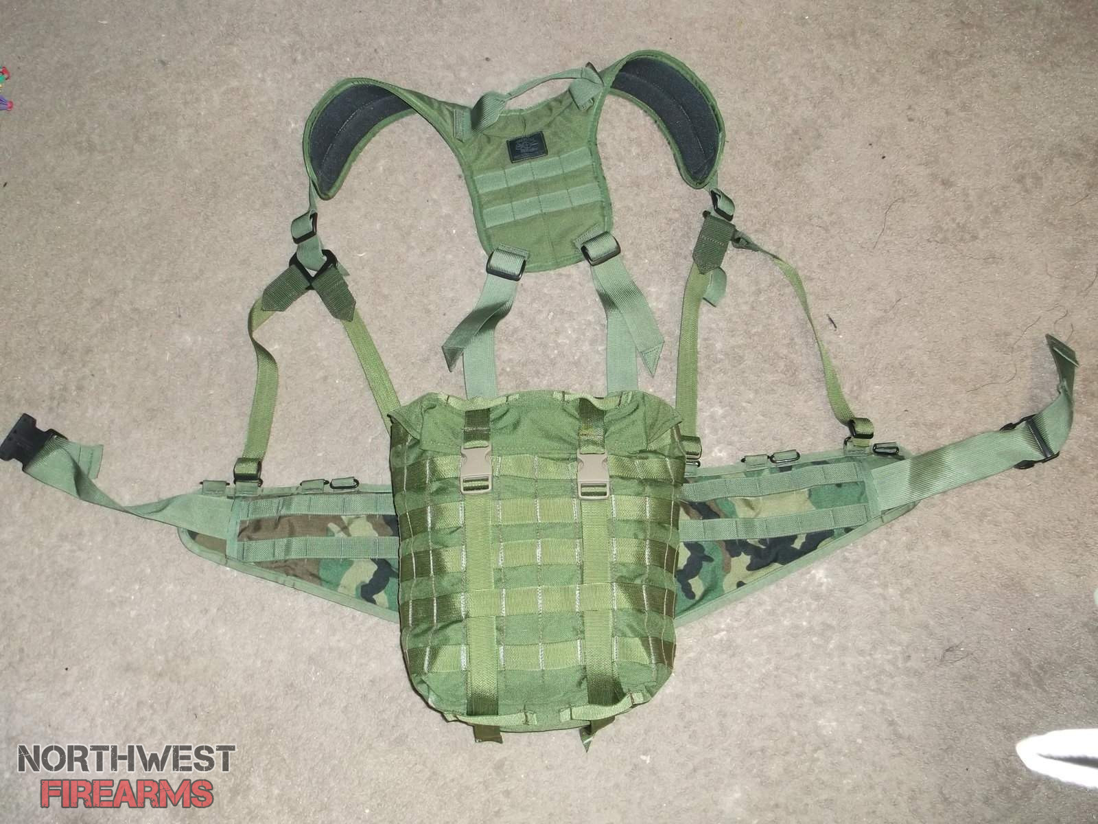

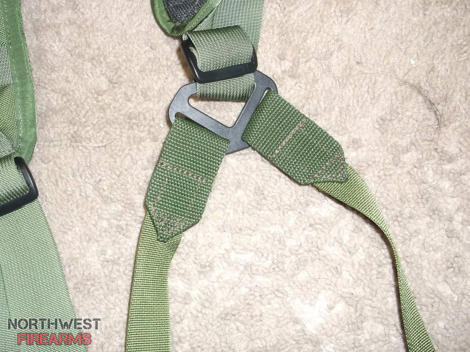

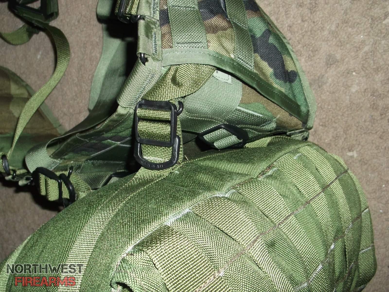

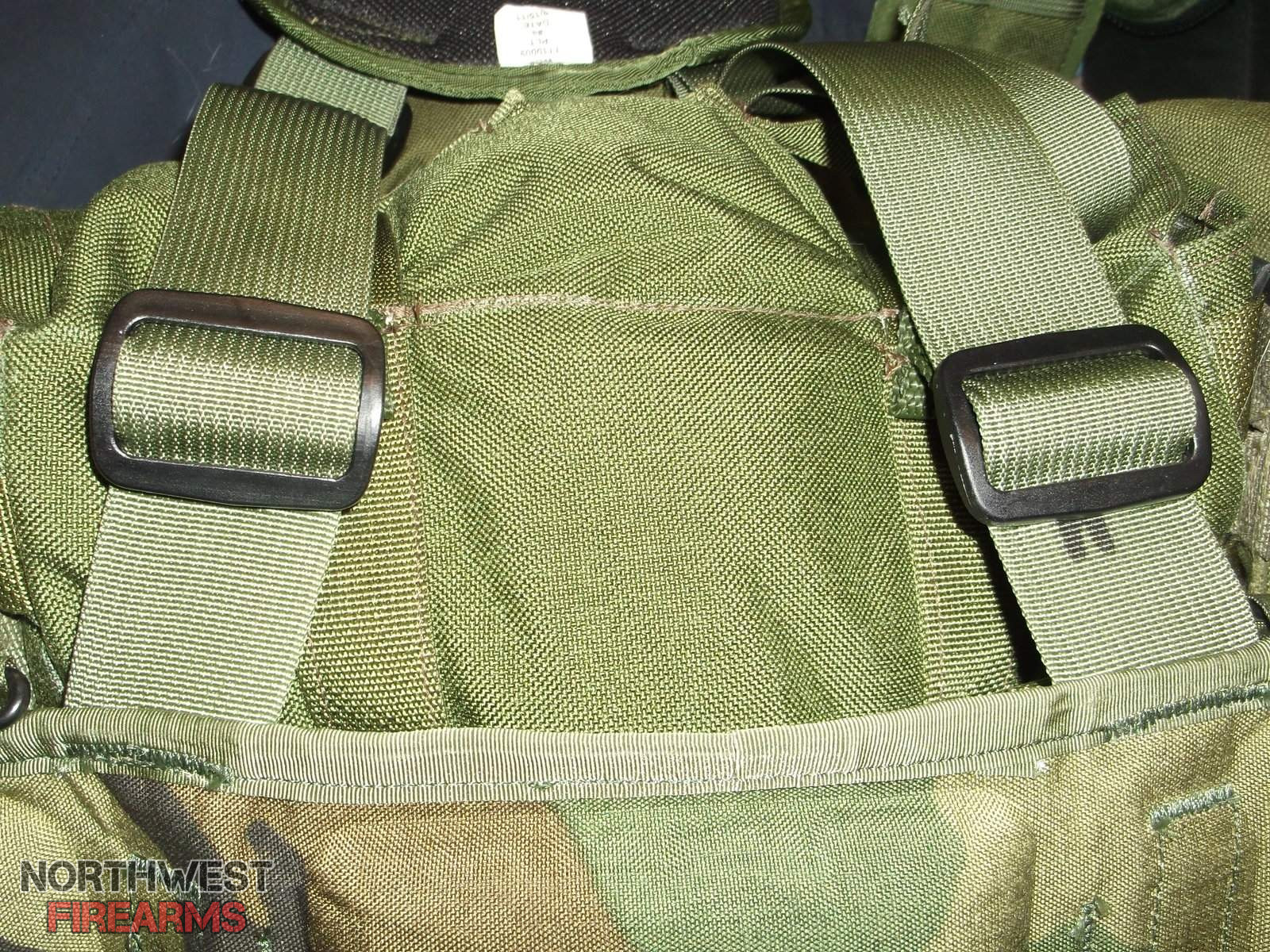

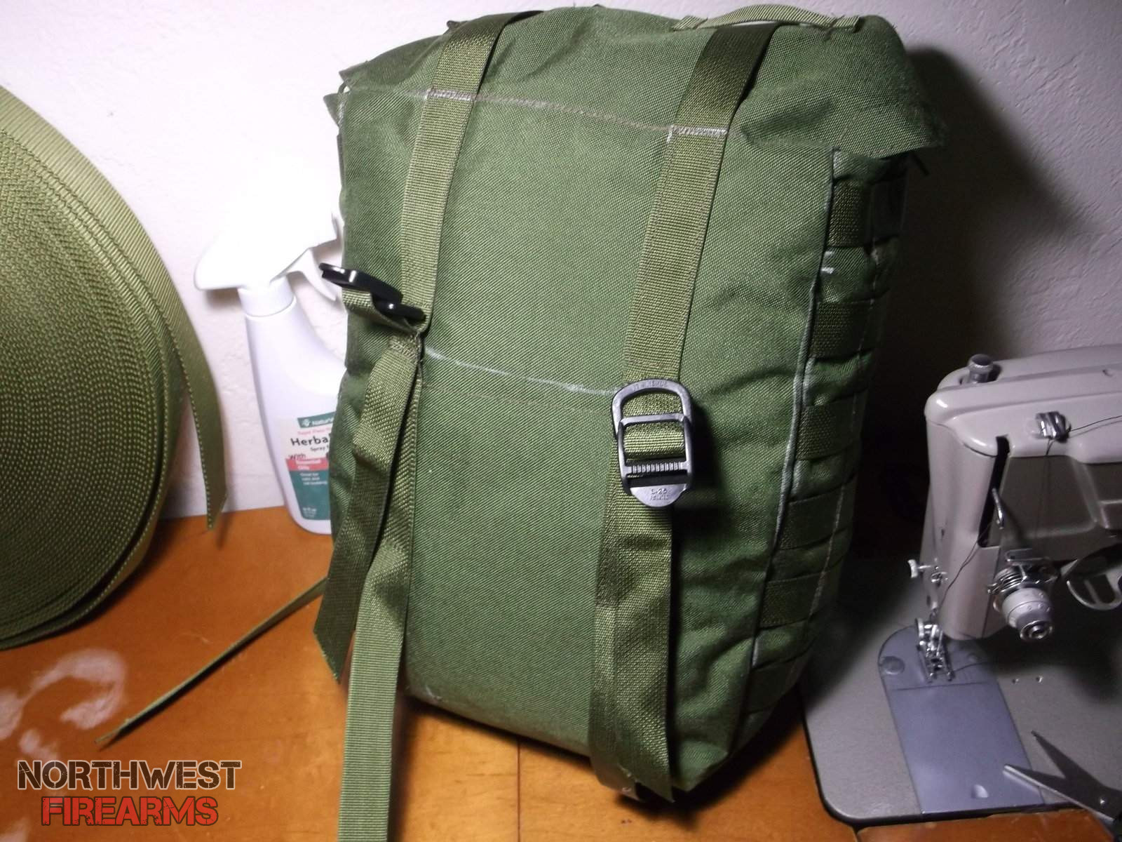

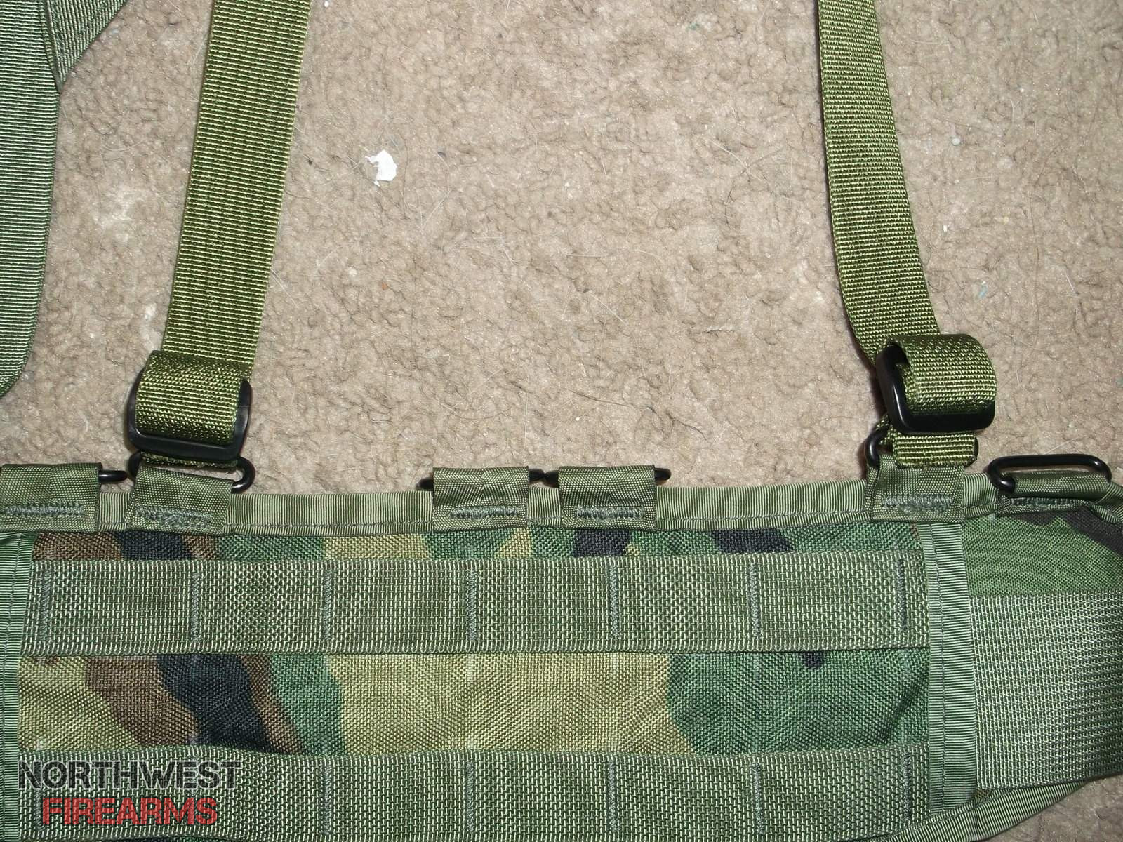

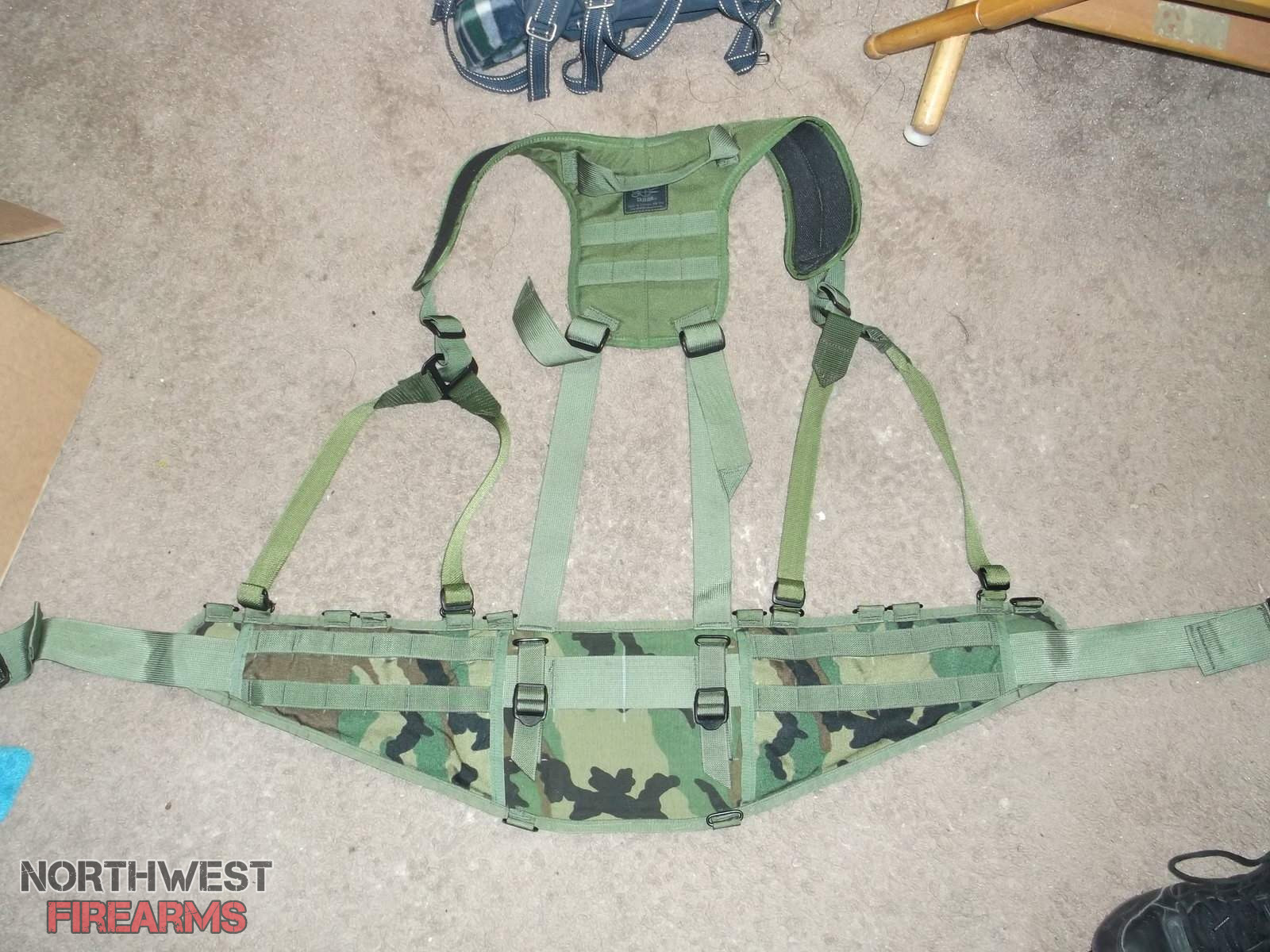

Sewn up a couple V strap adapters; and a large lumbar pack in 1000D Cordura, with MOLLE.... for use on an ancient MOLLE 1 waist belt. V strap adapters with 1.5" strap dividers and 1.5" webbing attahed to 1" webbing which connects to the metal loops on the MOLLE 1 belts. The adapters allows one to use a Tactical Tailor padded H harness from their MAV series, the MOLLE 1 belts originally comes with 1.5" webbing for the shoulder adjustment to the FLC vest pieces which are smaller and different than the later MOLLE II FLC vests. DSCF1439.JPG
Base rig without pouches or pack. MOLLE 1 rucksack waist belt with the ruck plastic socket module removed. (note the 4 loops on the middle, its for the MLCE buttpack straps)
On a 3 piece MOLLE Utility belt (adjusted to the smallest possible points); no buttpack loops.
Close up of V strap adapters
With yuuge lumbar pack attached.

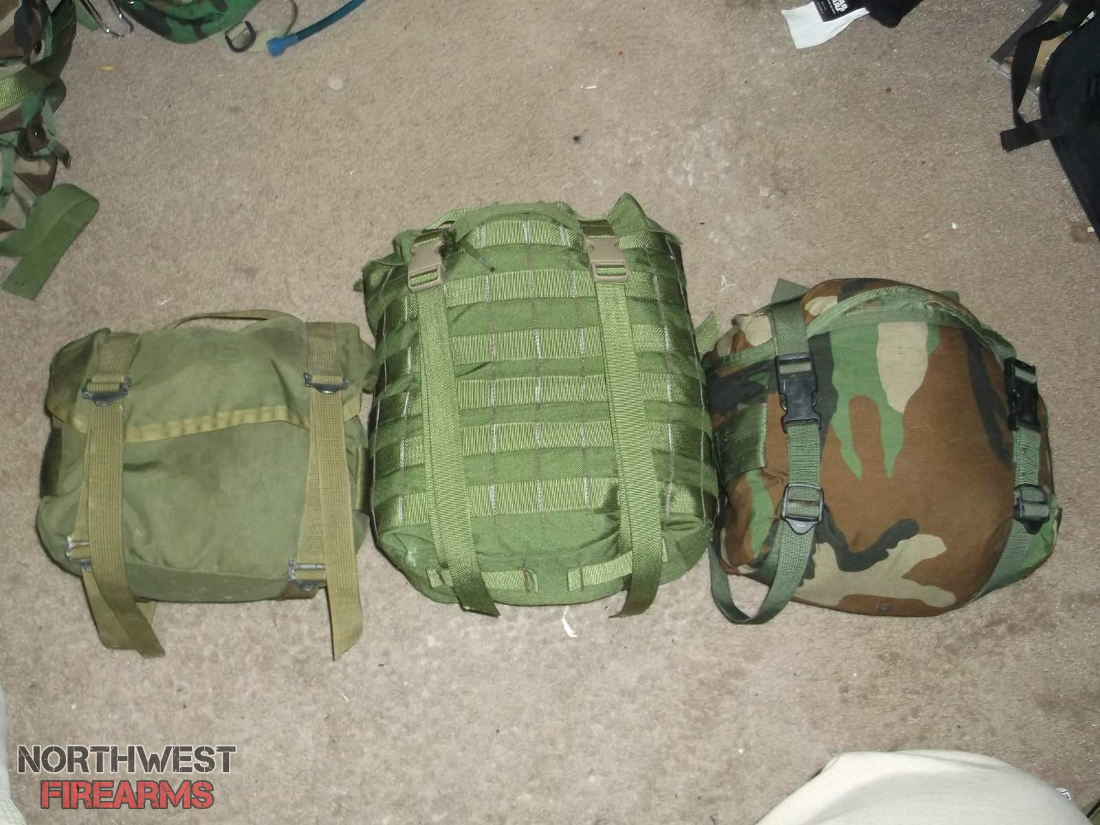

various views of the lumbar pack attached to the MOLLE 1 waist belt; and a size comparison of it between 1970s ALICE 3 day buttpack and the 1990s ALICE Woodland buttpack (Modernized Load Carrying Equipment/ Individual Integrated Fighting System version) which was issued with MOLLE 1 gear as well as the LBV series. the lumbar pack is easily double the size of the old OD pack, and roughly a third bigger than the Woodland pack.

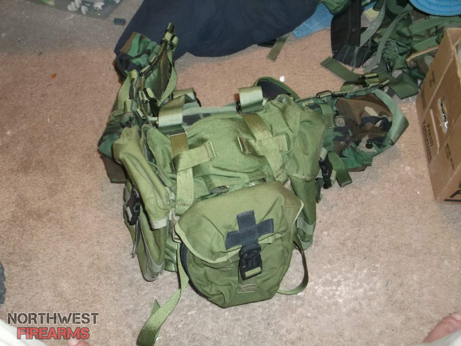

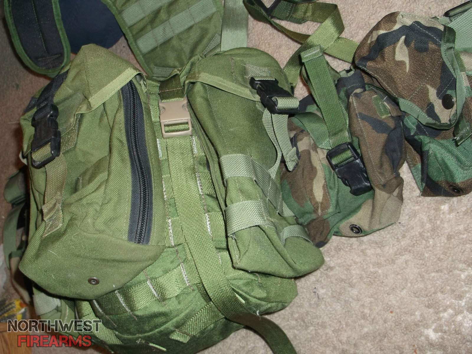

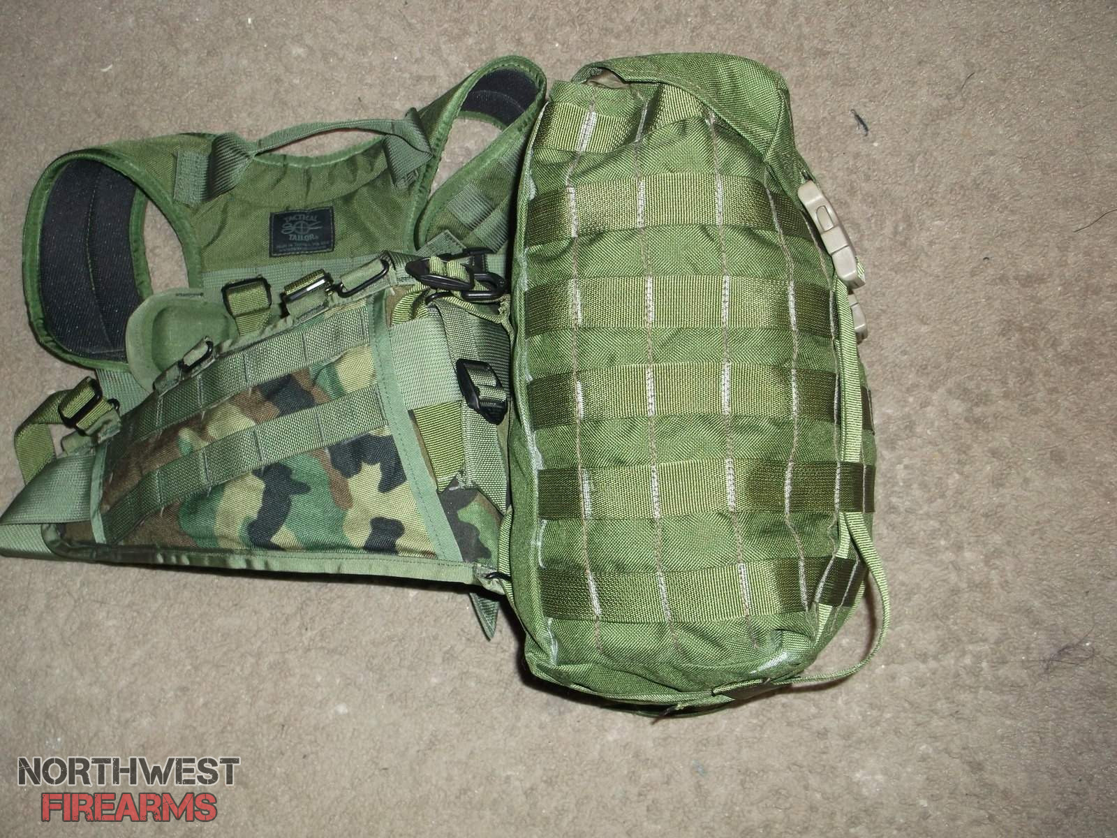

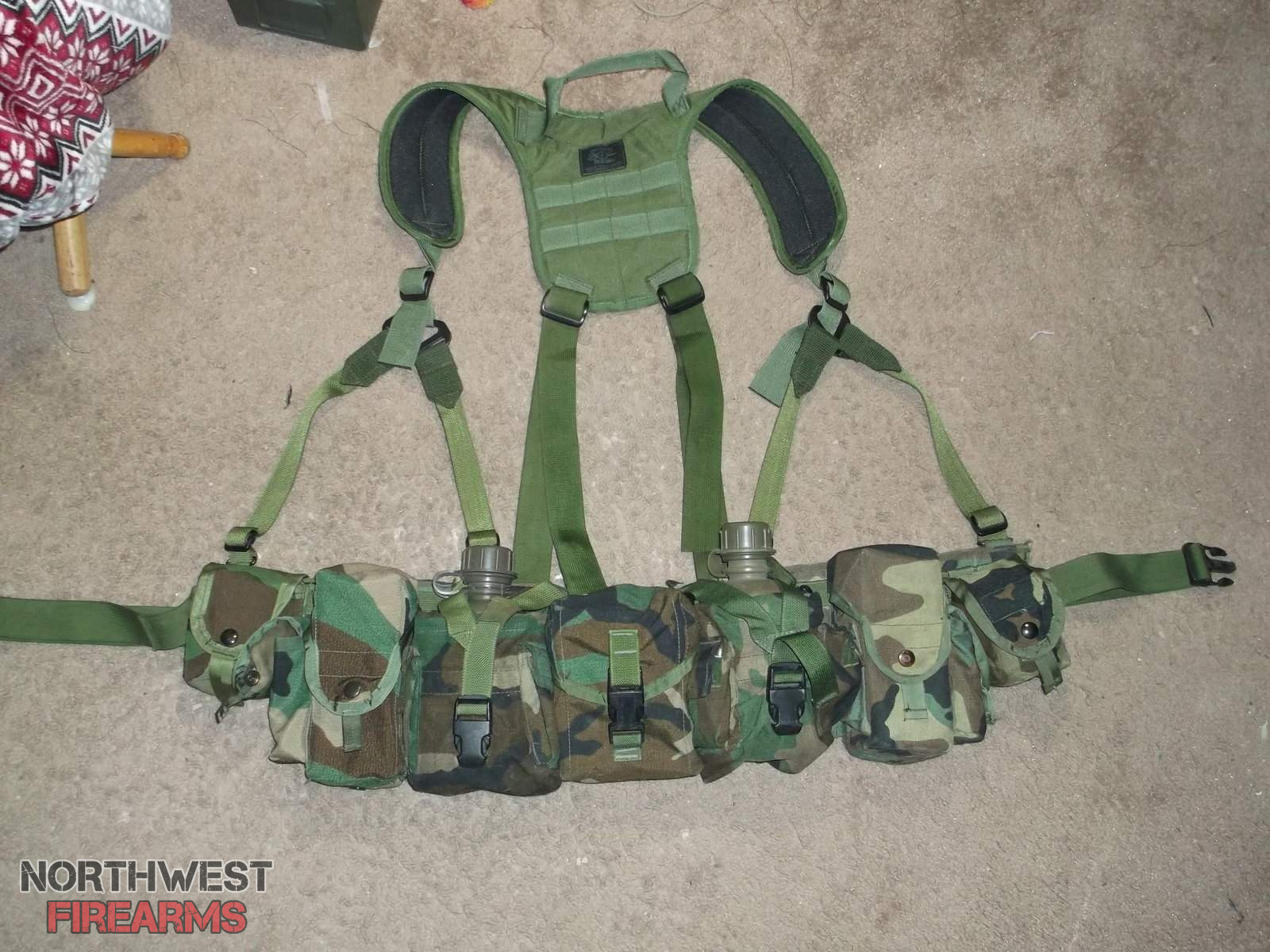

shown with pouches setup; as follows.
2x Combat Medic Vest System Triple M16 pouches, 2x Canteen covers, 2x Tactical Tailor Large Utility pouches, 1x Tacctial Tailor large zippered medic pouch, and lumbar pack; on MOLLE 1 ruck waist belt.
MOLLE 1 utility belt smallest setup;
2x grenade pouches
2x CMVS triple M16 pouches
2x canteen covers
1x 100rd SAW pouch with 1970s/1980s IFAK plastic insert box DSCF1441.JPG

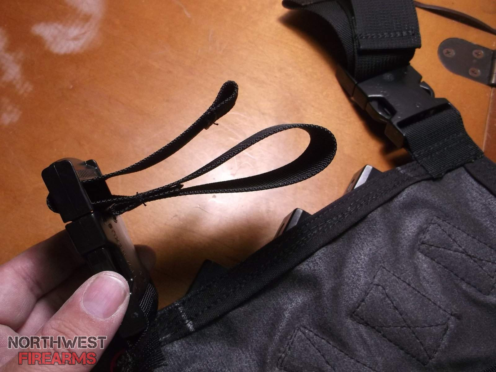

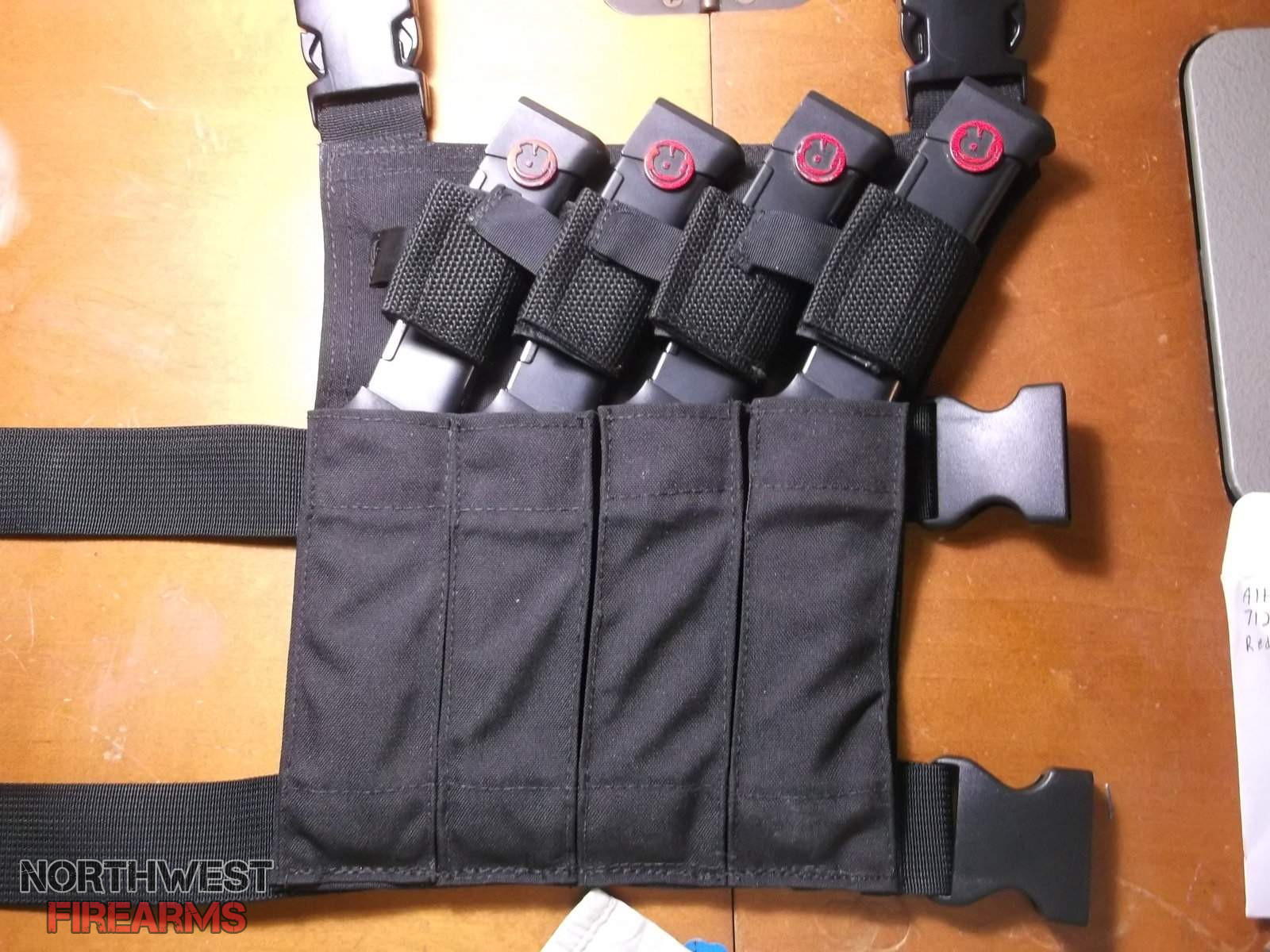

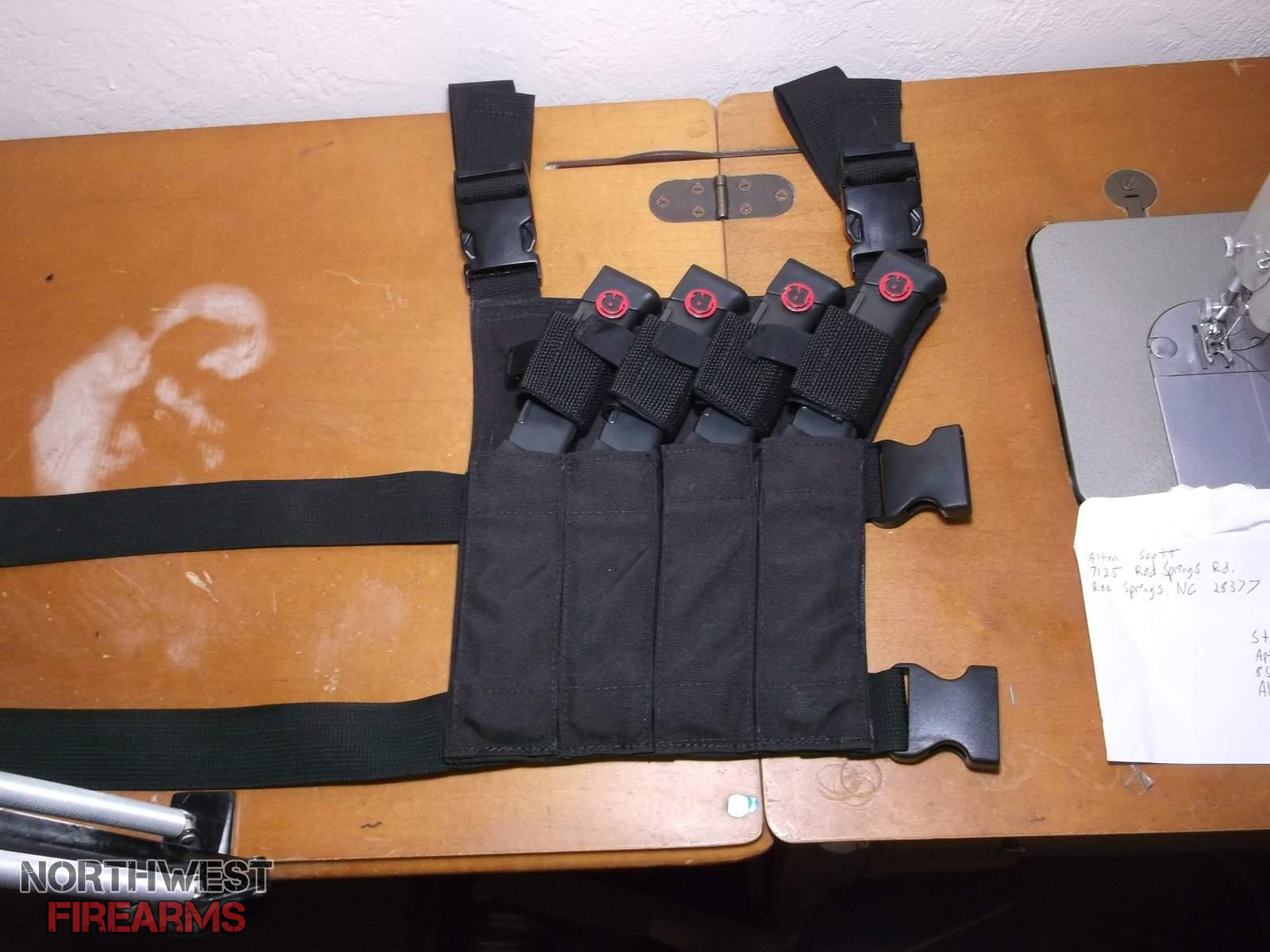

Sewn up a 4X Donkey D*** Redball Hi Point 9mm magazine Leg panel for a customer.
500D Cordura, Classic Ninja Black
Pleated magazine pockets, a departure from previous magazine pocket designs

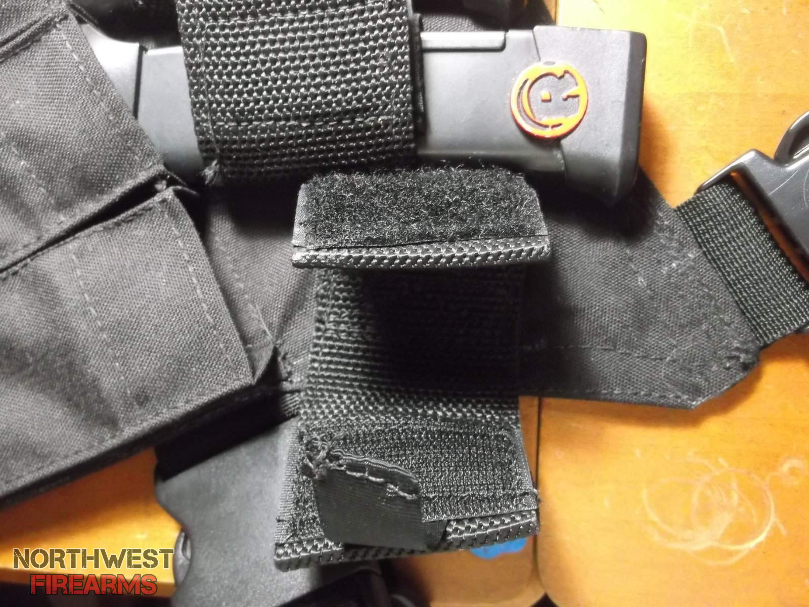

Velcro retention straps
2x Belt loops with adjusting buckles; belt loops accommodate up to 2.25" USGI Pistol Belts; recommend use with standard Patrol Belts, gun belts, or Riggers belts, not with MOLLE belts of greater than 2.25" width. (Can make one to attach to MOLLE instead)
DSCF1499.JPG View of whole thing
Closer view, focus on magazine pockets

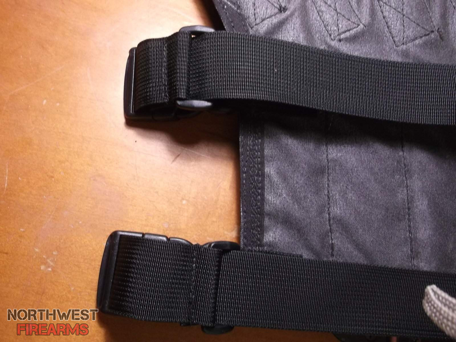

View of leg strap adjusters, whose ends are sewn into plastic loops that slides over the main straps, for a better retention/cleaner look as opposed to Velcro strap wraps or elastic loops

DSCF1503.JPG Velcro retention straps; I formerly had issues sewing velcro to anything, until an old lady told me a trick; sew it with the velcro panel facing down relative to the needle. Worked like a charm!
