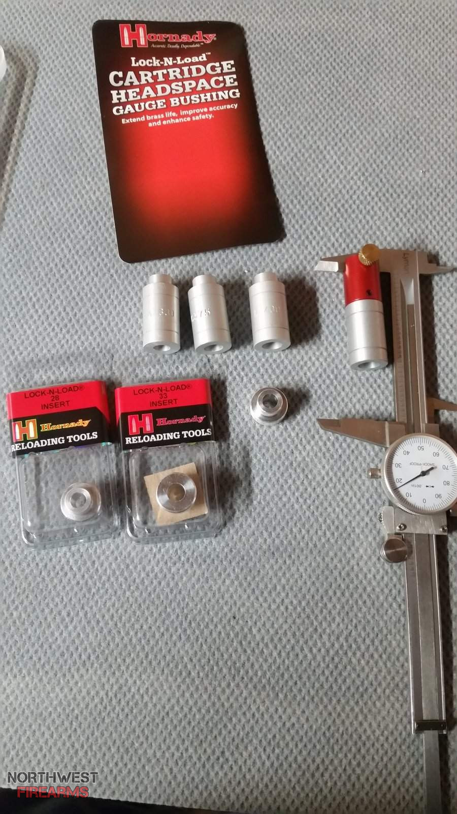

A set of these headspace gauge bushings and caliper are all you need to set up you dies. Cover pretty much all rifle calibers.
Takes up less space and is much cheaper than having a precision mic for every caliber.
Throw in the lock and load insert to measure your overall length and your done.

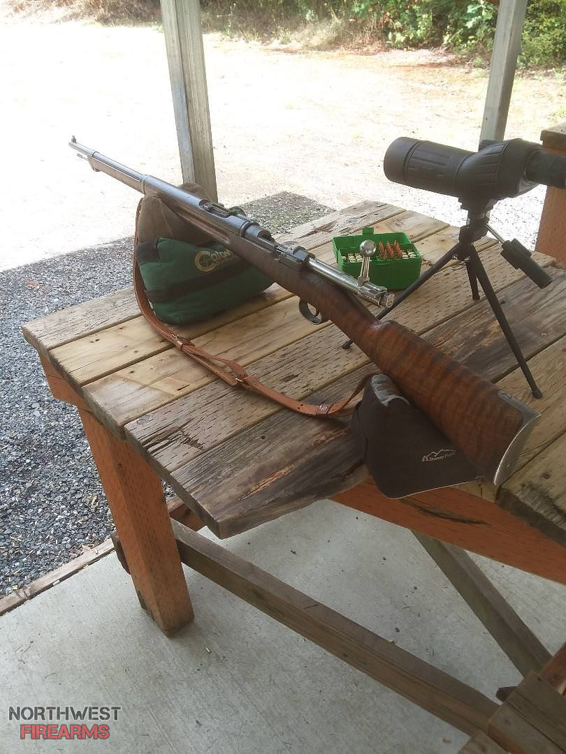

This be my 1902 short rifle from this thread...
Swedish Mauser ?........
