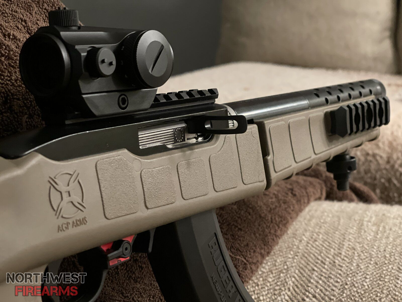

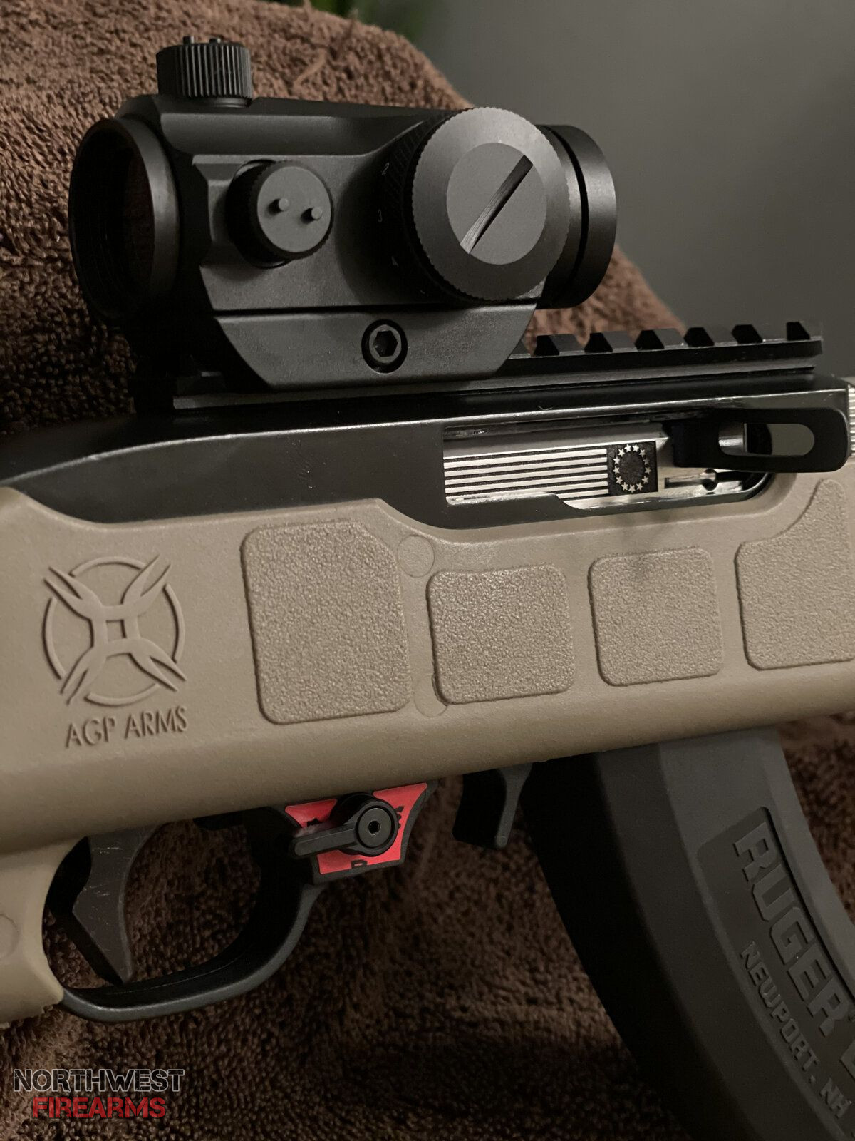

I just read through this thread. I was really shocked to hear a couple of you were having issues with the 10-22 Binary by Franklin. I ordered mine from BUDK, had it in 4 days and installed and test fired on day 5. I couldn't be happier. I will say though that my trigger group and housing was all stock before the install and it sounds like those of you having issues had the upgraded aluminum housing. I'm not sure if that's still an issue but I can say that my trigger works flawlessly. I've had it out 4-5 times and run several mags through it. I do have an upgraded bolt as well as the eagle talon extractor from TK. The combination of these three makes this a really satisfying shoot. Anyway, in stock at BUDK. Cheers, gents! :s0048:

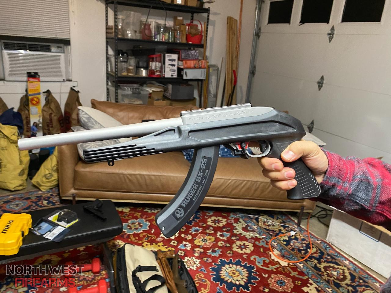

@Comanche I have a Ruger Charger pistol with the grey aluminum trigger housing. This one is only 2 position after installing the Franklin Binary - Safe and Binary. I'm ok with this.
The other 4 that I've installed, 3 had zero issues and were the plastic/polymer housing. I had an older metal housing trigger that just wouldn't work. Switched to a BX trigger housing and no issues since.
From direct observation, it seems that there are tolerance differences between the metal and plastic/polymer which cause the Franklin Binary not work correctly in the metal housing.
I decided to live the 2 position life because that Ruger Charger looks good with the matt silver finish. I also have the original wood frame that came with this charger and that color combo looks great. 38019.jpeg
The other old metal housing was on a Butler Creek Folder so switching to BX trigger housing was no issue.
I don't think I've ever seen that matte silver on one. It's almost a battleship gray. Looks pretty tough. Having that floated barrel is ideal for running that binary I bet. :s0048:Nicely done.
