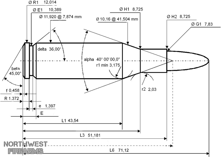

One source notes that some commercial .308Win loads can be as much as 10% more lively than an equal weight bullet 7.62x51 NATO round.
Please note that the original 7.62x51 bullet weighed in at just 147gr, now mostly 150gr. With modern .308 Win loads using bullets up to 190/200gr, it's obvious that some serious differences in pressure inside that little brass bottle are taking place. FYI, the UK/CIP proof pressure for 7.62x51 is just 20 tons per square inch.
Here is some interesting data to give you something to mull over -
7.62×51mm NATO cartridge dimensions. All dimensions in millimeters (mm).
Americans would define the shoulder angle at alpha/2 = 20 degrees. The common rifling twist rate for this cartridge is 305 mm (1 in 12 in), 4 grooves, Ø lands = 7.62 mm, Ø grooves = 7.82 mm, land width = 4.47 mm. The primer type can be Berdan or Boxer Large Rifle.
According to the official NATO EPVAT NAAG-LG/3-SG/1 rulings the 7.62×51mm NATO can handle up to 415.00 MPa (60,191 psi) Pmax piezo pressure. The proof round pressure requirement is 521.30 MPa (75,608 psi) piezo pressure recorded in a NATO design EPVAT barrel with a Kistler 6215 transducer, HPI GP6 transducer or by equipment to C.I.P. requirements..
The 7.62×51mm NATO cartridge approaches the ballistic performance of the original U.S. military .30-06 Springfield M1906 service cartridge. Modern propellants allowed for similar performance from a smaller case with less case capacity, a case that requires less brass and yields a shorter cartridge. This shorter cartridge allows a slight reduction in the size and weight of firearms that chamber it, and better cycling in automatic and semi-automatic rifles. The .30-06 Springfield M1906 round weighed 26.1 grams (403 gr), and the 7.62×51mm NATO M80 round weighs 25.4 grams (392 gr)..
7.62×51mm NATO vs. .308 Winchester.
Although not identical, the military 7.62×51mm NATO and the commercial .308 Winchester cartridges are similar enough that they can be loaded into rifles chambered for the other round, but the .308 Winchester cartridges are typically loaded to higher pressures than 7.62×51mm NATO service cartridges. Even though the Sporting Arms and Ammunition Manufacturers' Institute (SAAMI) does not consider it unsafe to fire the commercial .308 Winchester rounds in weapons chambered for the military 7.62×51mm NATO round, there is significant discussion about compatible chambers and muzzle pressures between the two cartridges based on powder loads, chamber dimensions and wall thicknesses in the web area of the military compared to commercial cartridge cases. As the chambers differ accordingly the head space gauges used for the two chamberings differ.
You choose.
