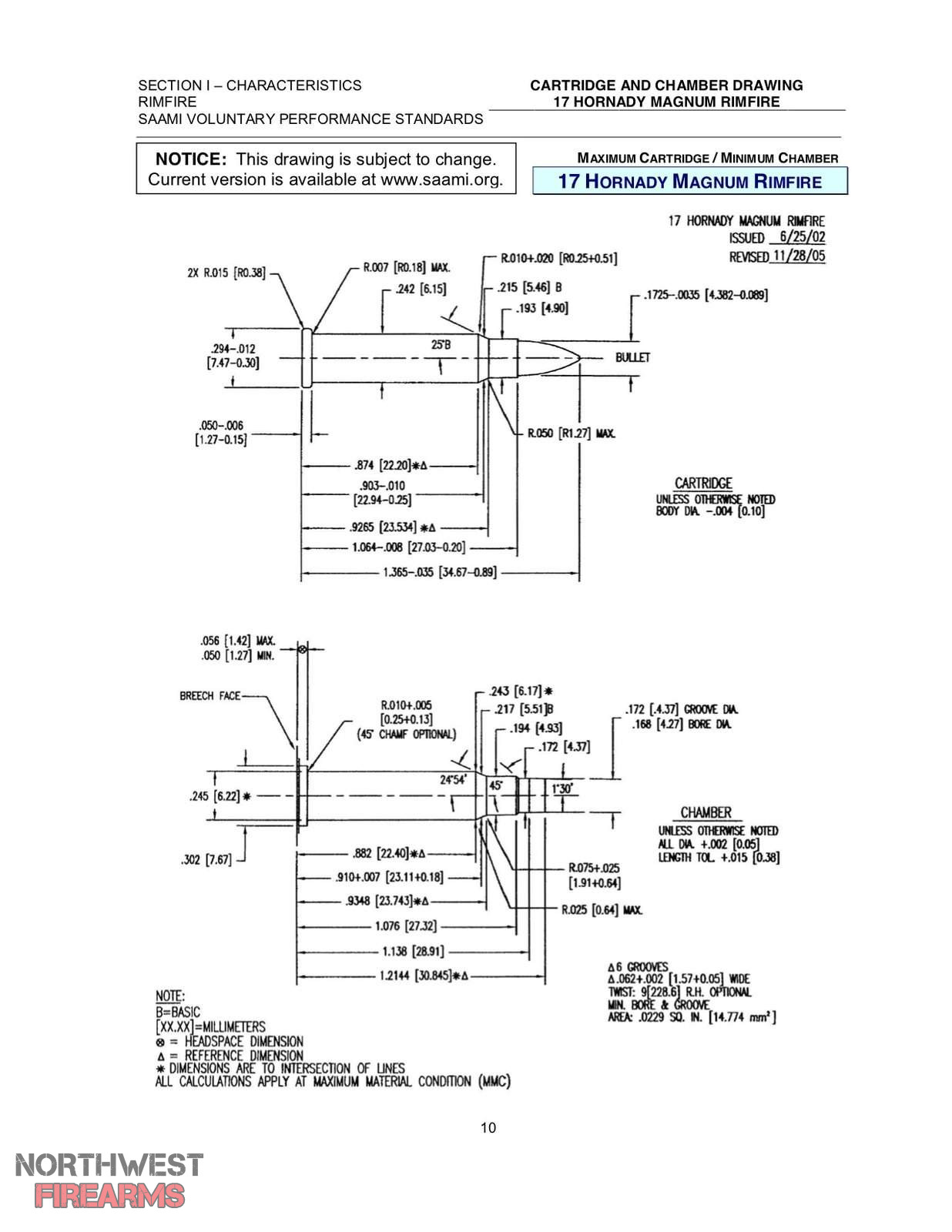

CIP and SAAMI do not always agree dimensionally. Savage rifles are made in the USA and hopefully conform to the SAAMI recommendations. CZ are made in the Czech Republic and conform to CIP specs. I don't know what either are as my SAAMI data references do not include the more recent calibres like .17HMR.

Tac, is this what you are looking for?
Cartridge & Chamber Drawings – SAAMI
https://saami.org/wp-content/uploads/2018/01/Z299-1_ANSI-SAAMI_Rimfire.pdf#page=8
A lot of history and documentation about this issue on the RimfireCentral.com forum. Mostly annealing issues with older lots, Winchester seems to have a lot of issues also. Good luck with it Tac.
Here's the SAAMI drawings
