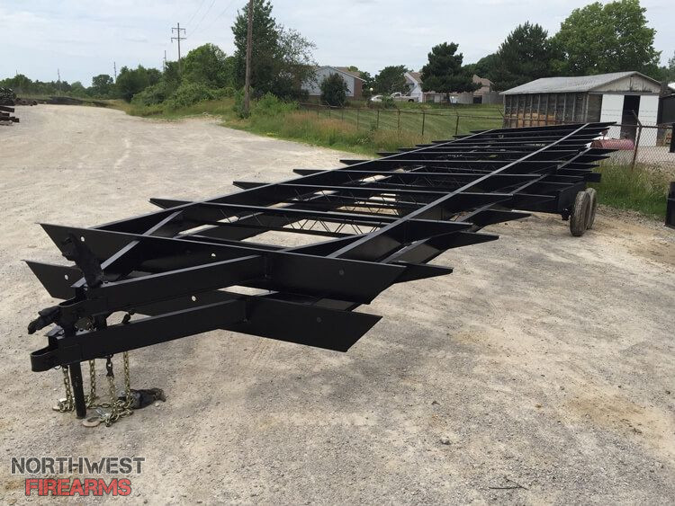

Most "mobile homes" - now called manufactured homes, are built on an underlying steel frame, usually i-beams. I didn't mean that the walls are steel framed (although there are houses that have steel 'studs'/etc. in the walls, instead of wood, those are mostly commercial buildings and the studs are not weight bearing like in a house, they mostly just serve as walls to separate rooms).
I meant like this:
They then lay a wooden floor on top of that frame, then wooden stud framed walls and wooden roofs.
