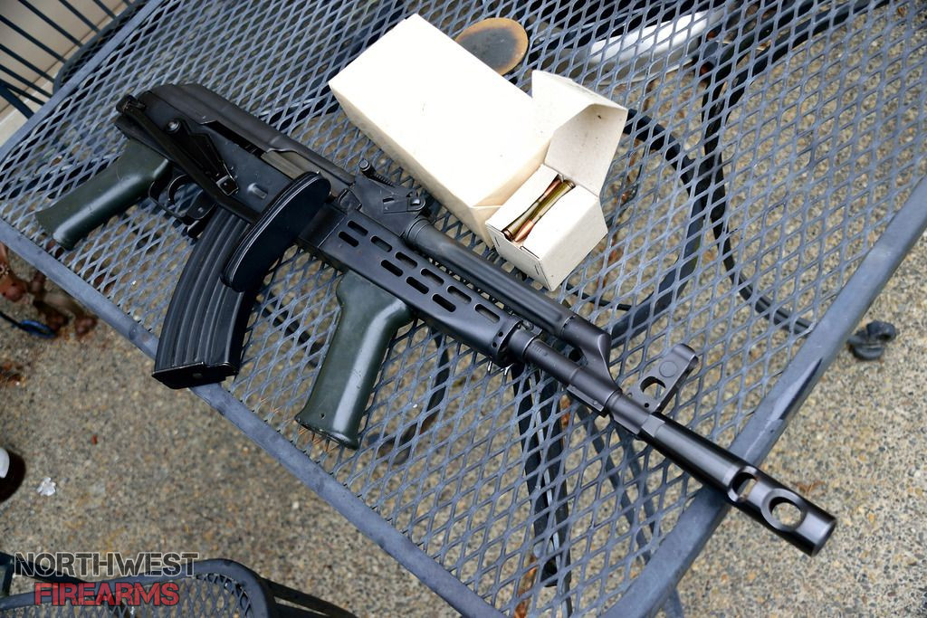

I had this AMD65 clone that was built by shop in Boise ID about 12 years ago. The gun shot well but I hated how it was finished. Every component had a different finish making the gun look like a POS :)
I decided to give Duracoat a try in HK black and this is how it turned out:
DSC_1640_zpsrbrsof2q.jpg DSC_1693_zpsducvp6yo.jpg DSC_1692_zpsnyp7rsmu.jpg DSC_1634_zpsv4f0ld0l.jpg
Lookin good! I did the frame on my witness in duracote. Used the rattle can stuff. It will dull out some over time. At least mine did.
I did my latest couple of FAL's in Duracoat and it turned out really well. I did the same HK black and really like how it "ages" with use! The FAL's were never really coated with any consistancy and were prone to all sorts of damage and scaring as well as rusting, this gives it a nice finish that lasts and still shows use! Nice job, looks great!
