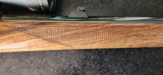

The checkering is very shallow with flat tops to the diamonds and it is full of the same thick finish on the rest of the rifle.

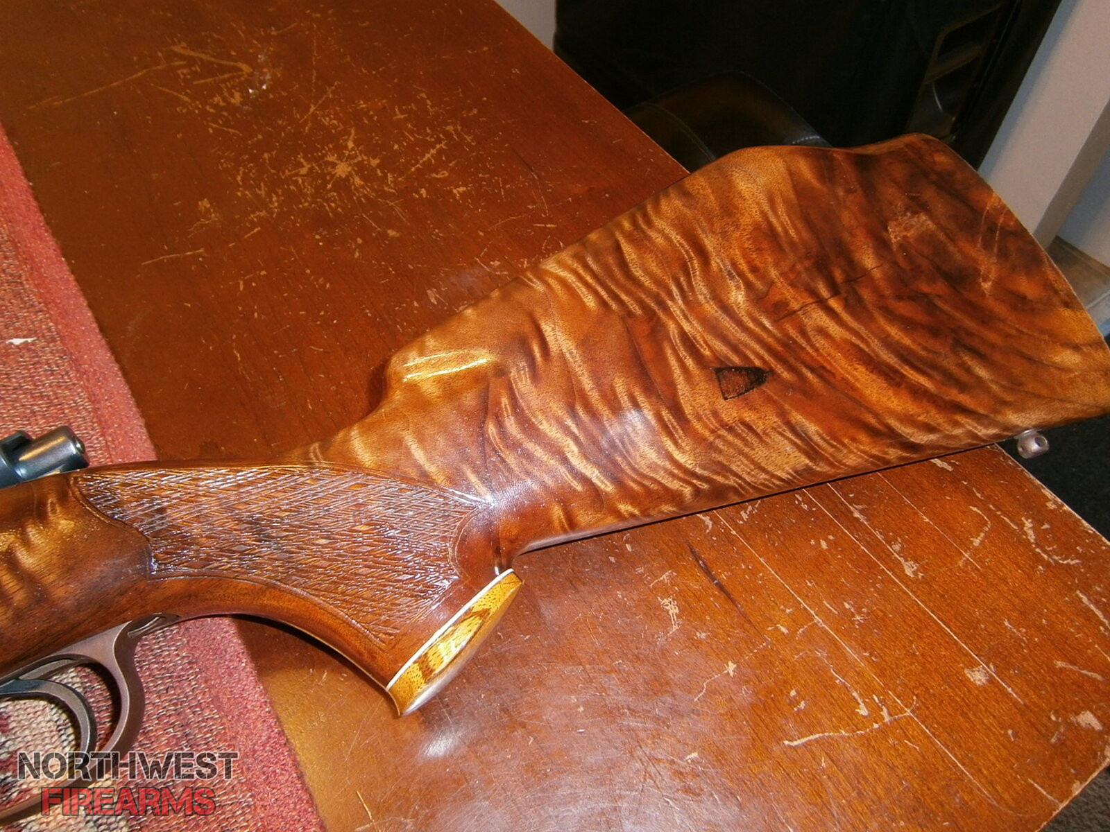

The pic below is the original finish.

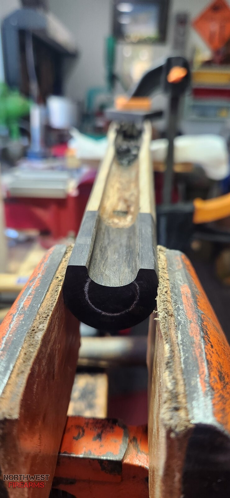

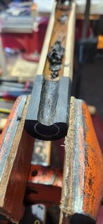

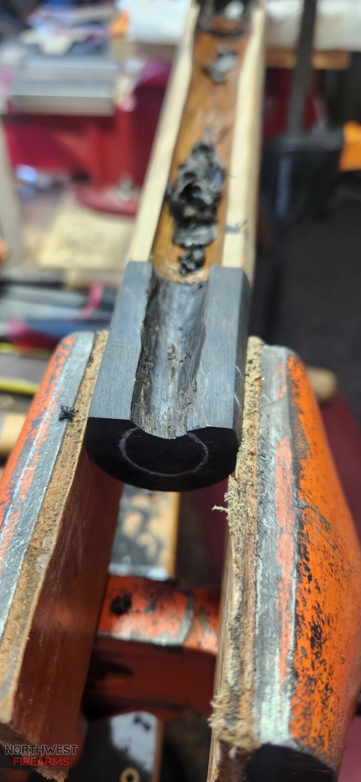

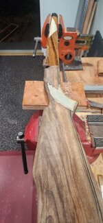

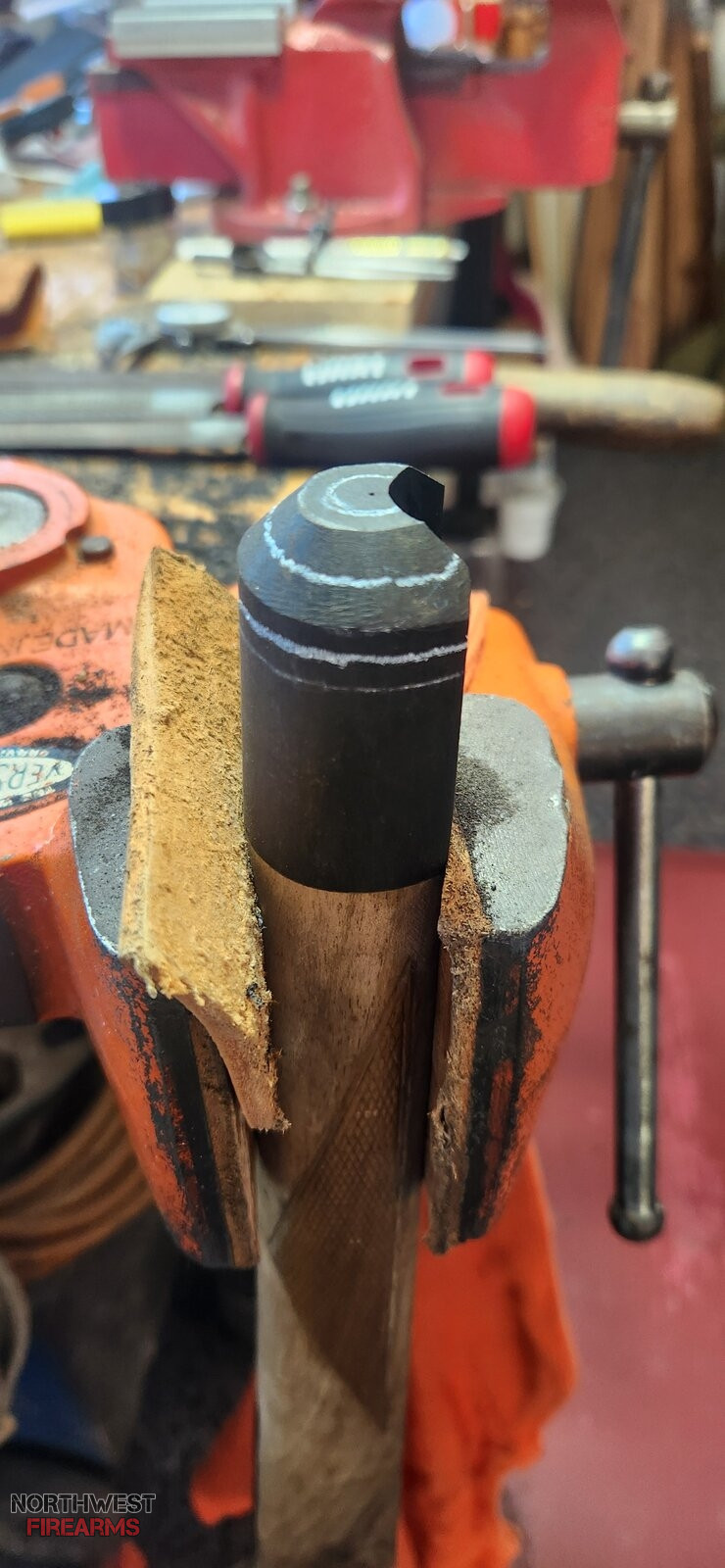

New ebony fore-end tip now fitted.
Channel roughed
Before inletting barrel
Barrel inletted and tip taking shape.
More to come.

ah, looks like a deluxe model of some sort. It's just aged badly as some of those old laquer finishes do. I do not do checkering but my gunsmith says very few do it anymore and the good ones who did are dying off. Might be a good money maker to learn if a guy needed a job in retirement. Good luck touching up yours. Probably good practice at getting started. Good luck!

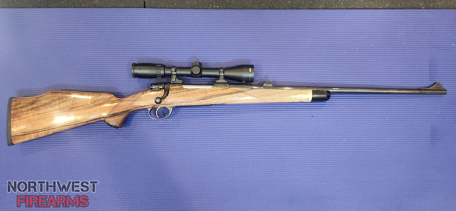

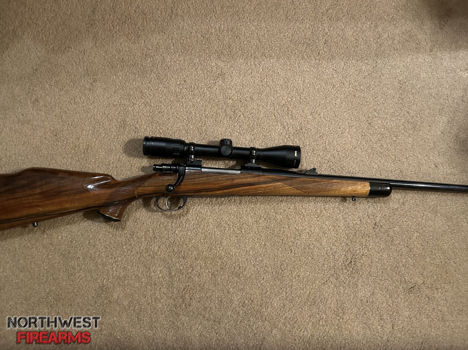

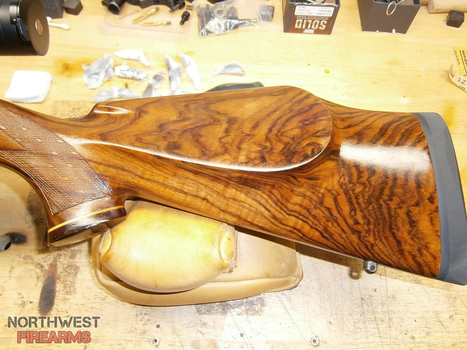

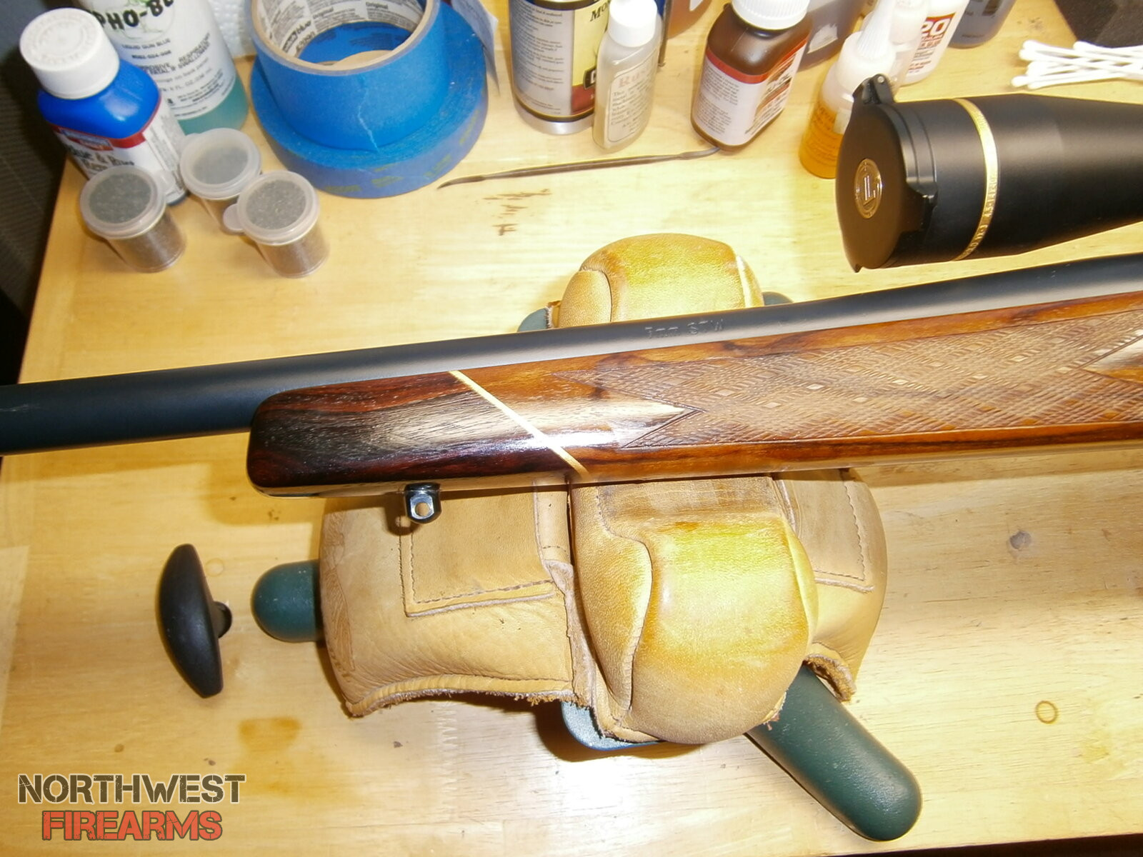

Progress so far:
Old finish removed
Sanded back
Ebony tip fitted and finished
Tru-oil fill coats and sanded back
7 coats of Tru-oil lightly applied
Plastic grip cap replaced with steel cap (temp fit)
Plastic butt plate removed and .6" Pachmayr pad fitted (temp fit)
Rubbed back with water and Rottenstone powder.
Not 100% satisfied with finish yet, I will apply a few more coats of Tru-oil and rub back again with Rottenstone until all the grain is filled. I can see areas when holding the stock a certain way.

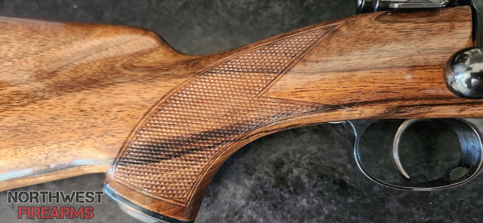

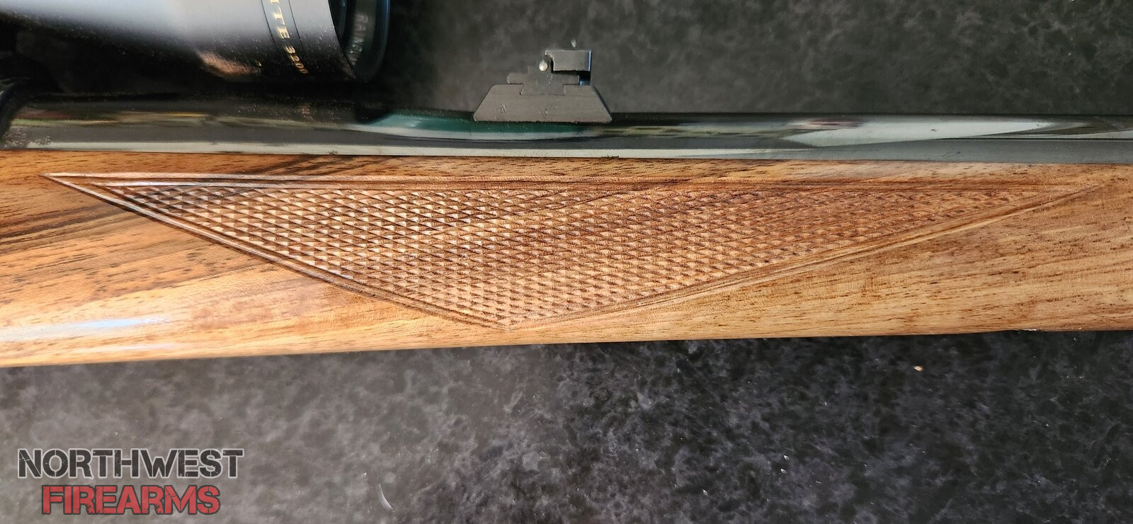

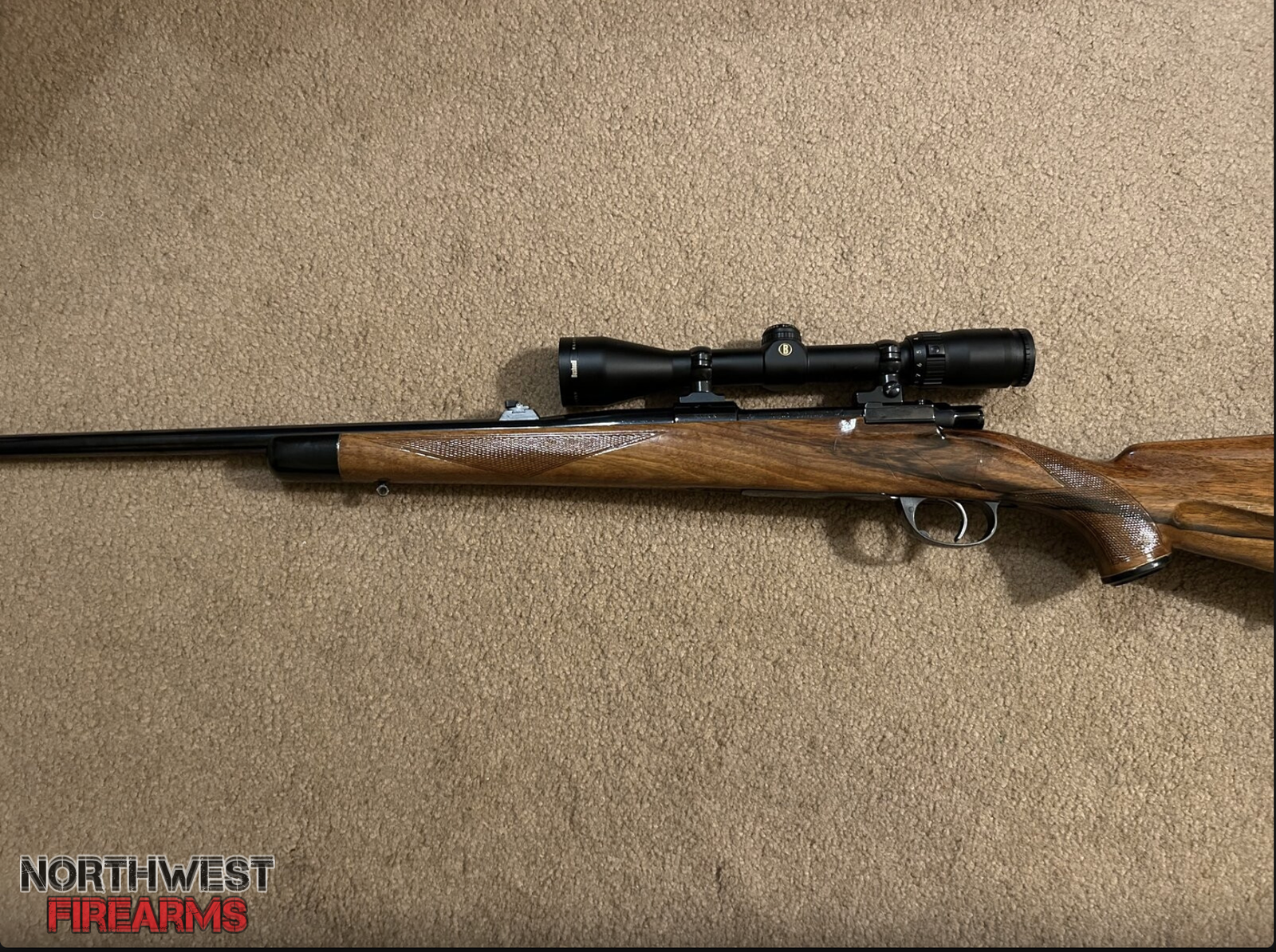

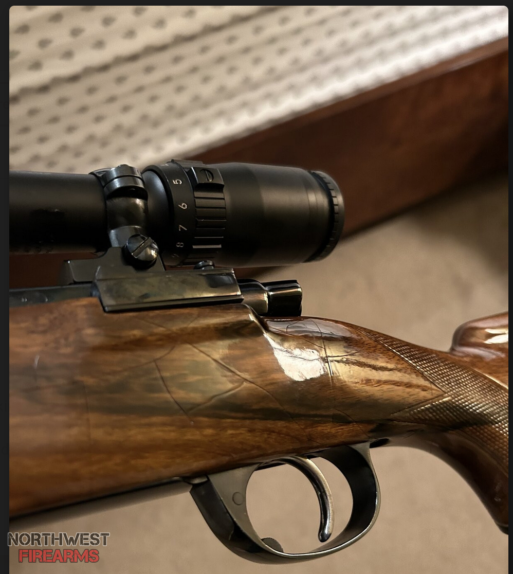

A few pics of after and a couple before.
New ebony tip, Ruger #1 steel grip cap, .6" Pachmayr recoil pad, checkering re-cut.
Contact details for anyone looking for someone to do quality checkering at a reasonable price with quick turn around times.
