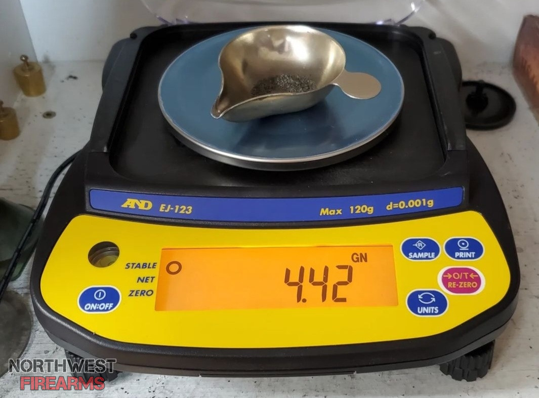

One thing that tightened up the velocity spread was going to a scale that shows hundredths of grain measurement vs tenths.
