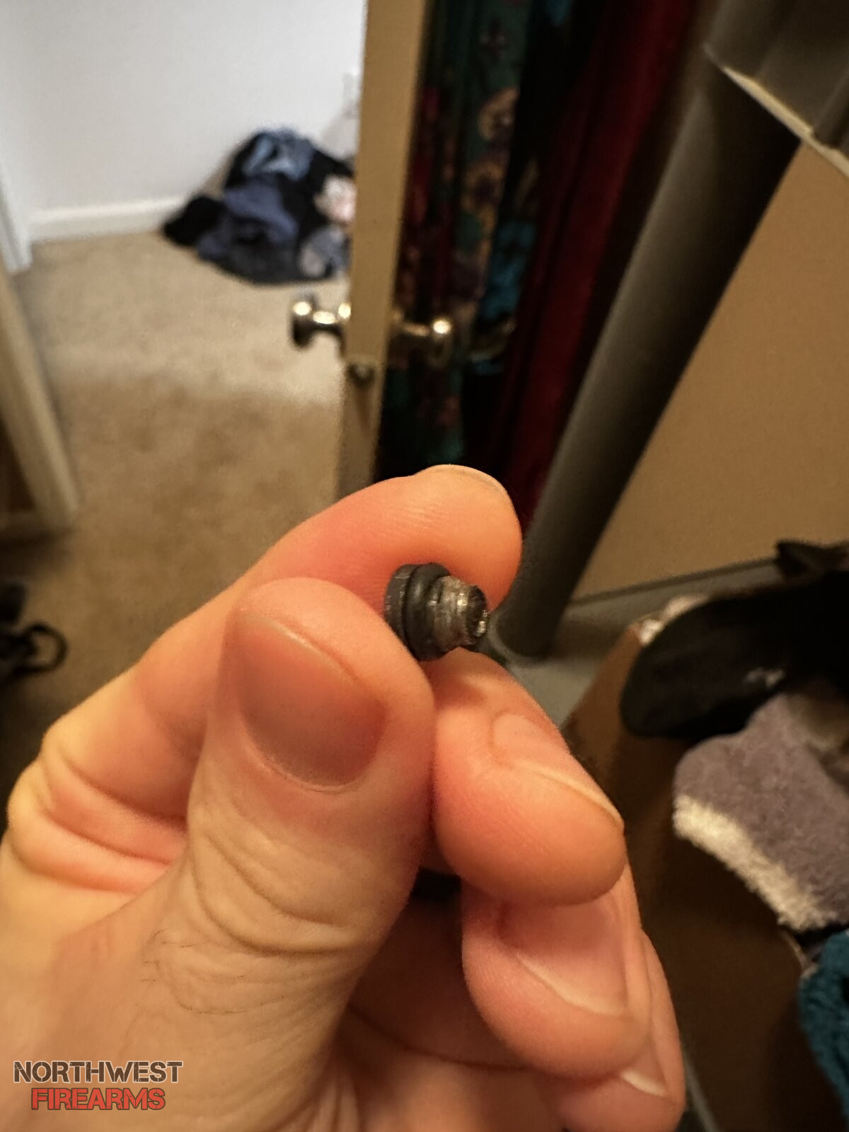

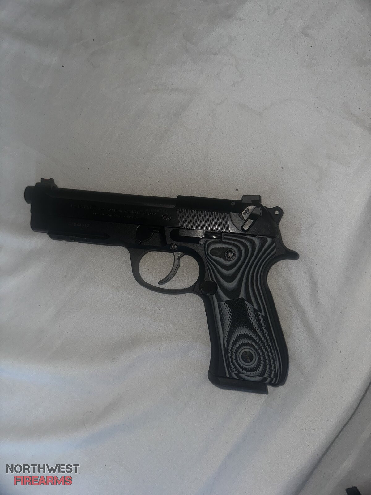

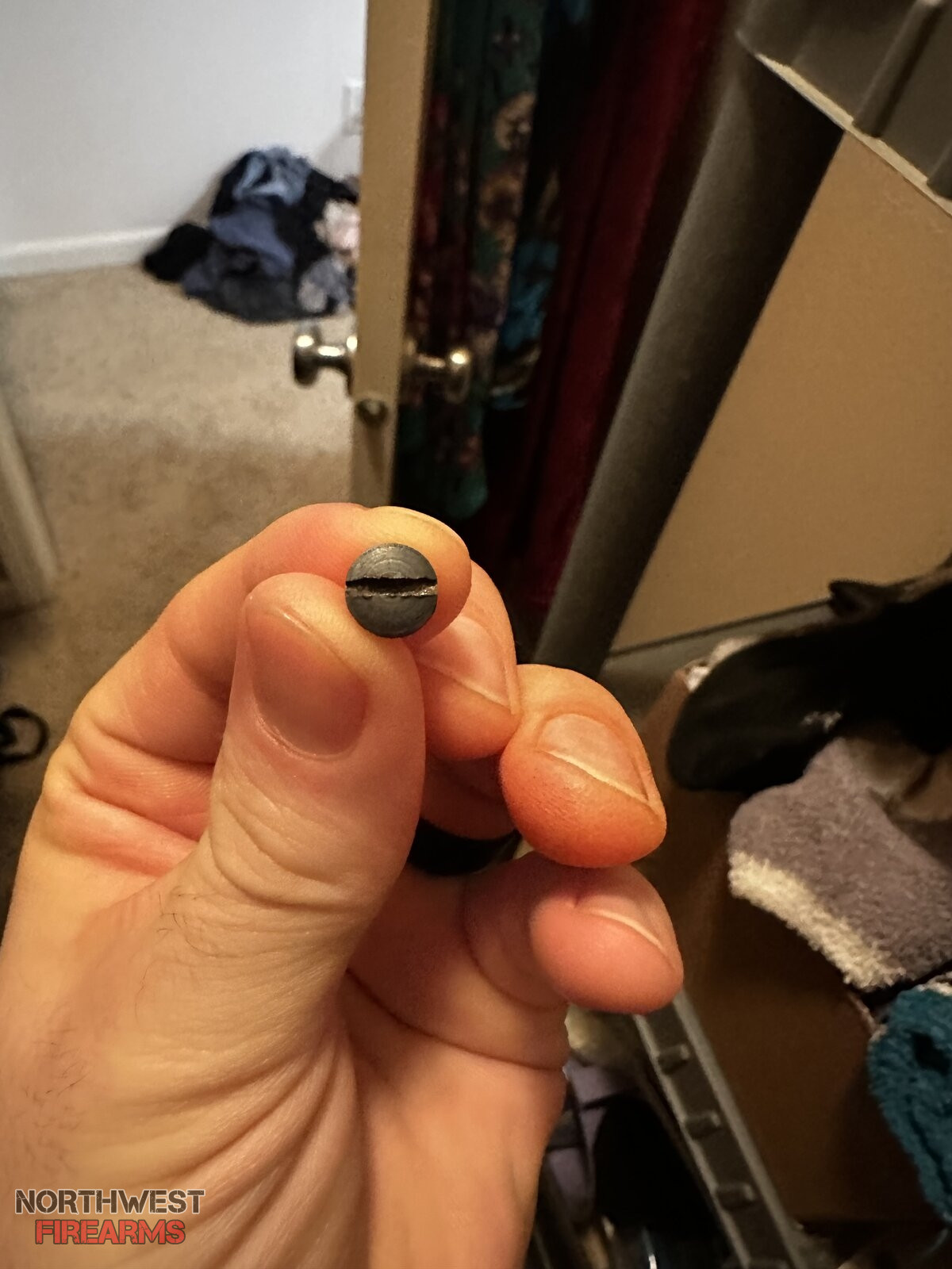

Was shooting and noticed that the top left grip screw came out (along with the o ring and something else). Tried screwing it back in but it won't stay. Am I stupid (rhetorical question), or is this a gunsmith type of issue?

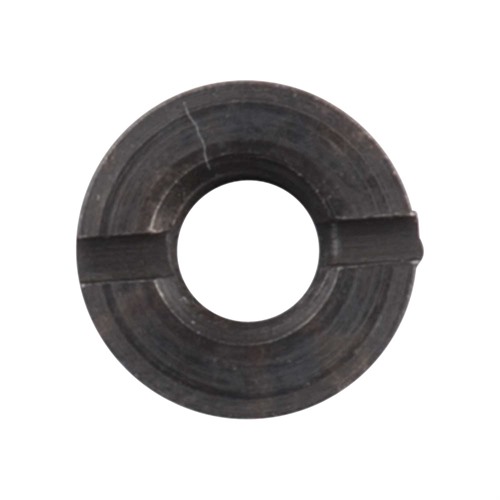

From the looks of that screw you'll need to replace that too, include a new oring.
Be careful replacing the bushing, thats the thread you dont want to have stripped out and sometimes they are staked in place or require heat to remove if red loctited.

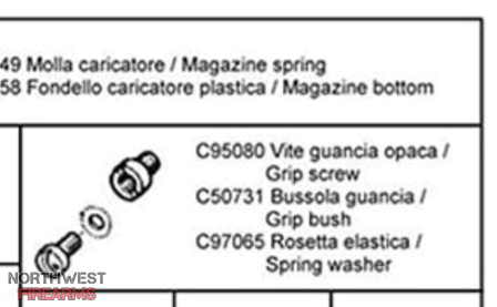

Interactive schematic and a good seller.
