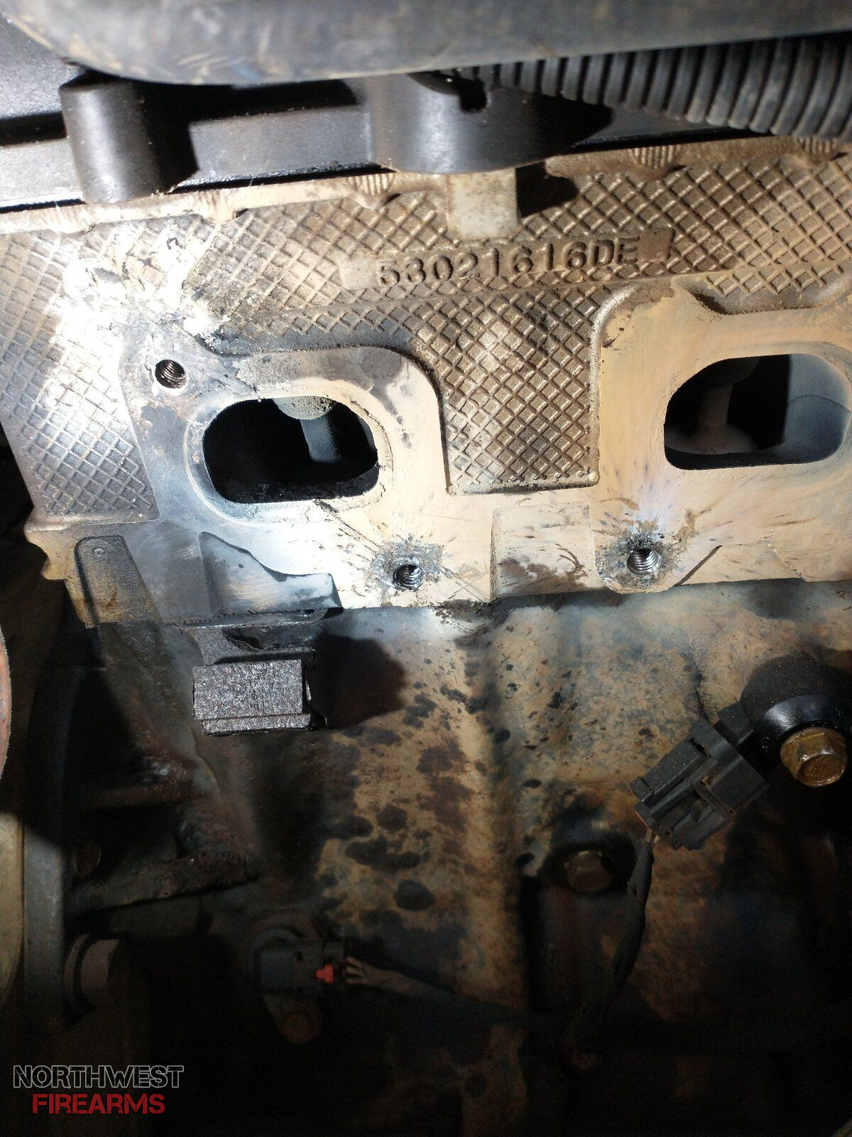

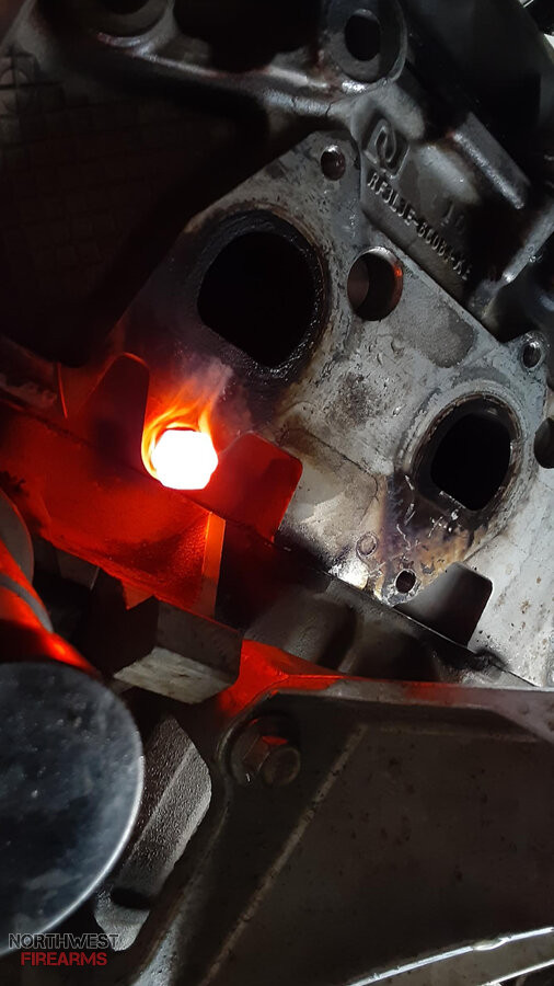

My son has been nursing his Ram 1500 along with broke exhaust manifold bolts for a while now and it started running bad enough that it was time for the plunge. Had three bolts broke flush and I was able to get enough metal built up to grab with the vice grips. Really easier than I expected. Tried welding a nut on first, but that was no bueno. I've used that little Harbor Freight welder quite a few times now and works like a charm.

Aluminum heads, cast iron manifolds and heat cycles, seem to make it pretty common. Happens with Chevy and Dodge more than Ford, Coyote at least, as they use larger diameter fasteners. The good news is they are dissimilar metals so there is not much worry of welding the broken fastener to the parent, the heat also helps break any bond, although they are generally not very tight anyway, now that the tension is gone.
With a TIG you can remove very small things too.
