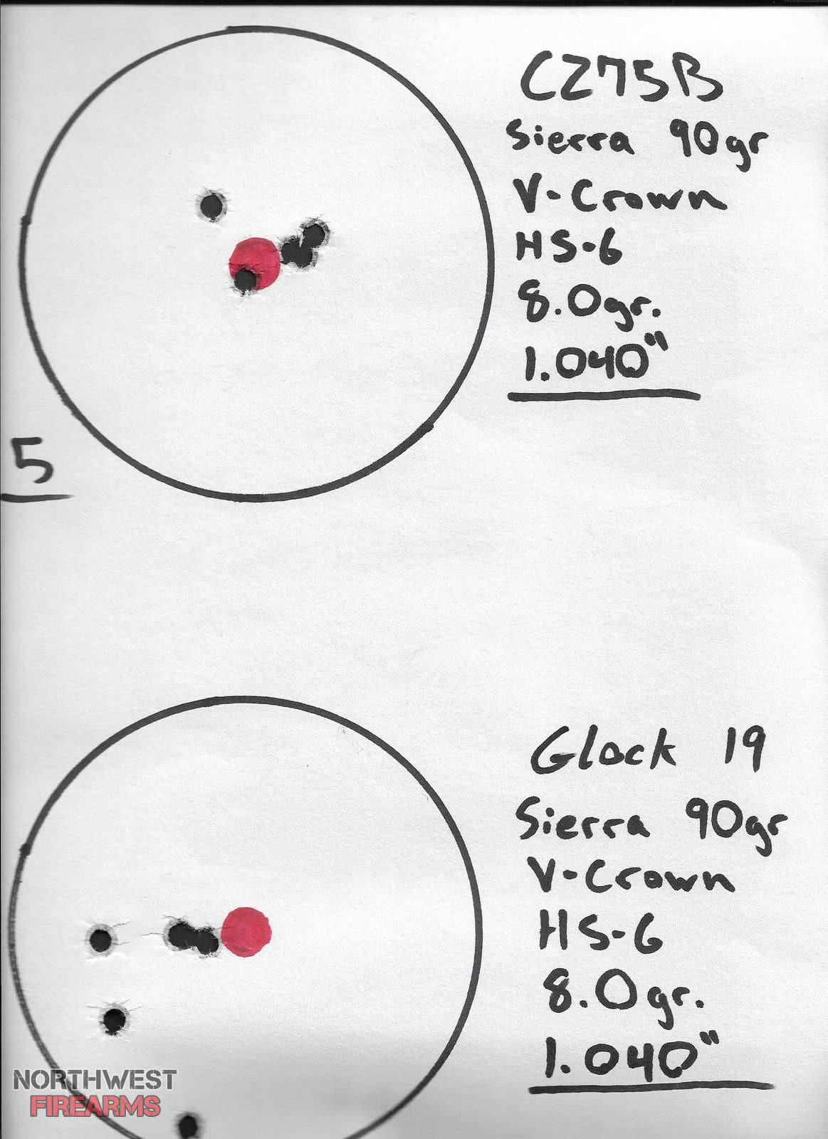

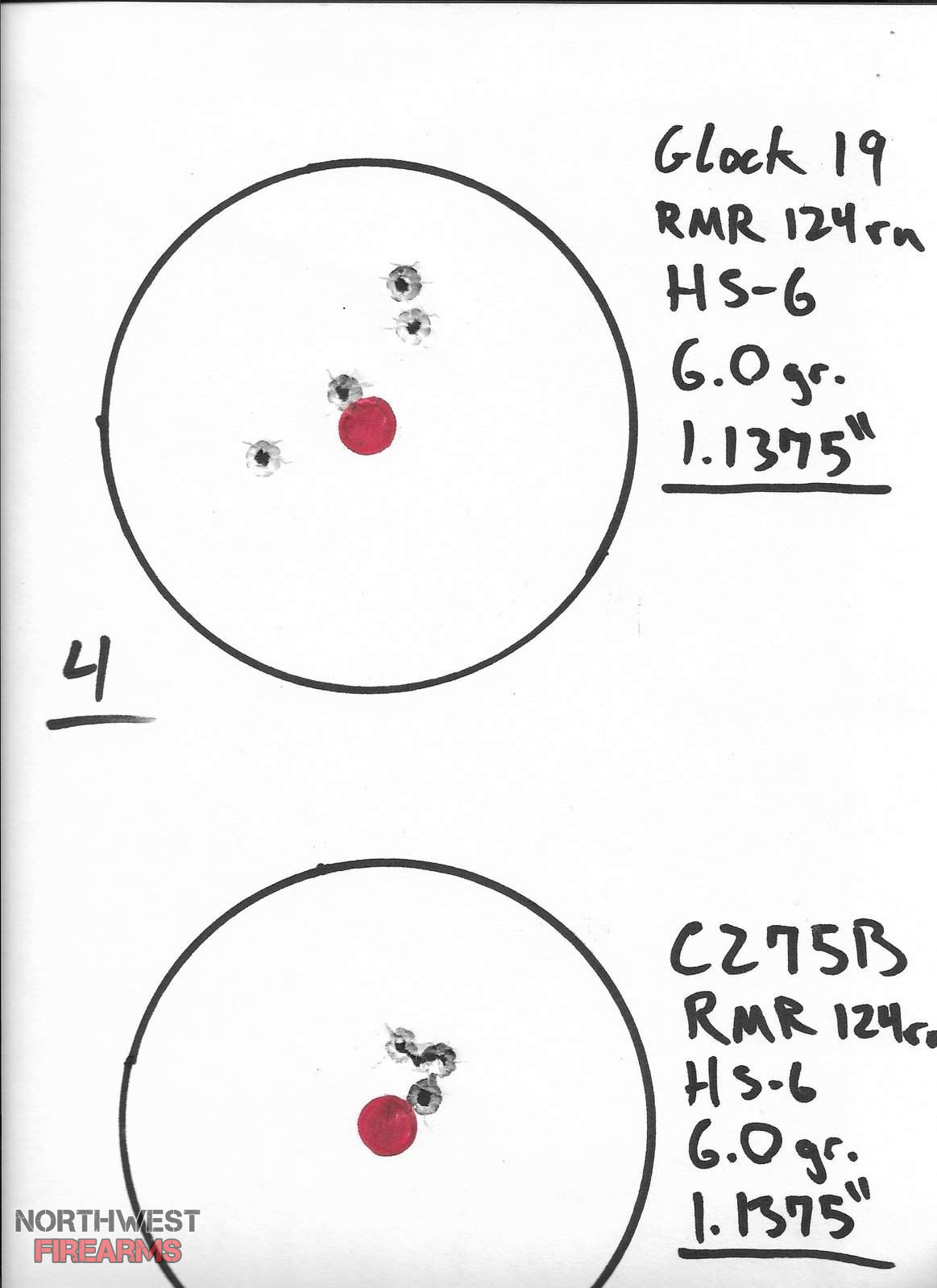

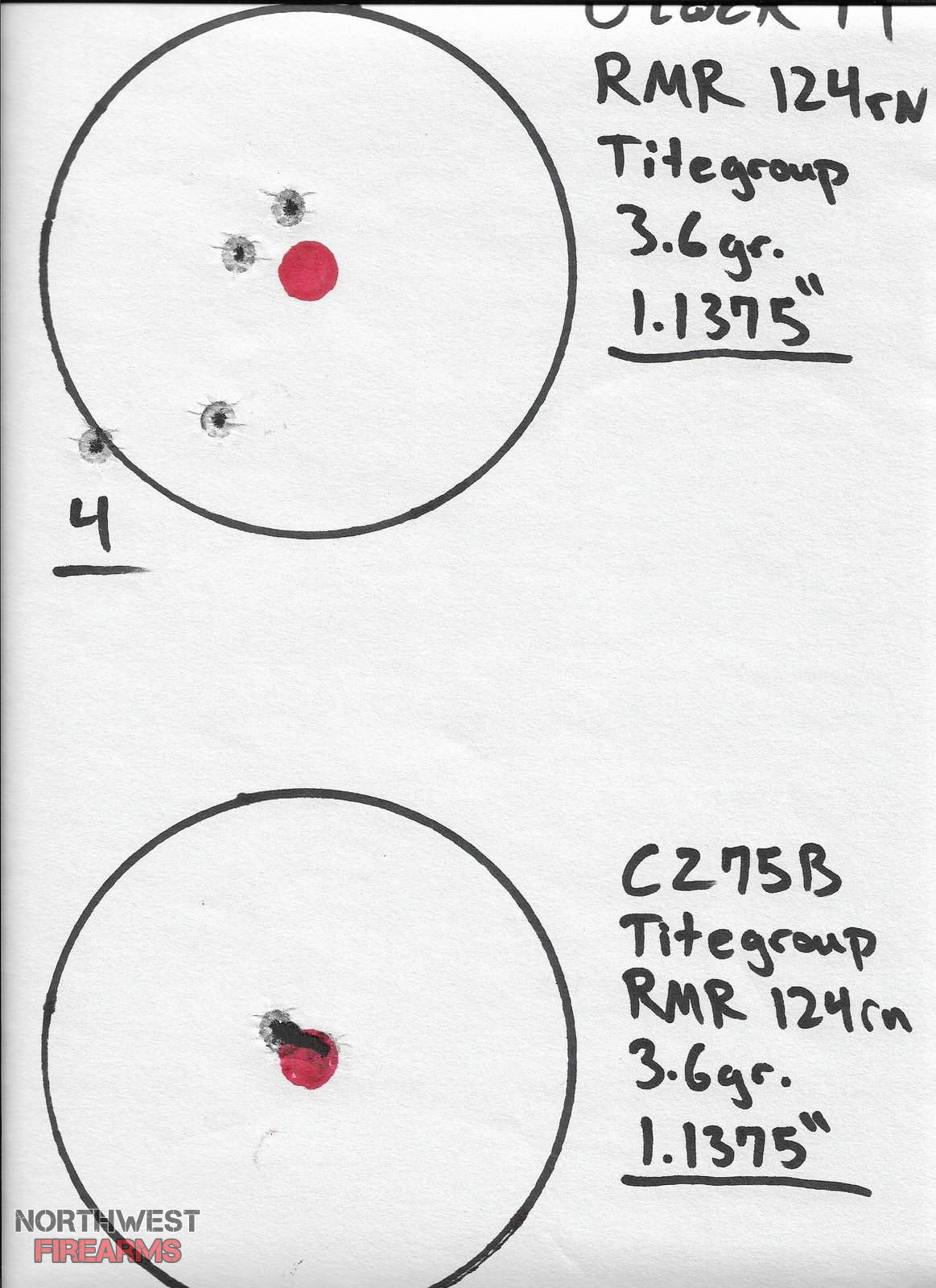

Looks like the cz beat the snot out of the Glock, I knew there was a reason I decided to buy one of them.;)
It looks like tiregroup produced the best results, which is the same thing I've found in mine.
So chrono data was as follows, Titegroup 3.6gr 3 string was 1,017 1,010 984. HS-6 at 6.3 grs was for a 3 string 1,115 1,135 1,099. 700x at 3.8 grs three shots 921, 908, 889.
So everything is looking good so far but here's where it get's interesting as the target shows I loaded some Sierra V-crowns 90gr. and at max charge which I did work up my final readings were at 1528, 1545, and 1601 fps... according to my Lee manual velocity should be around 1400fps. longer barrel of a CZ giving extra velocity maybe?
Love to see these at 20-25 yards.
Yeah I never said I was a marksman, I definitely think the glock could have been better with a slightly modified trigger, the break feels really heavy and could be why the shots opened up so much more. I thought about shooting at the 20yrd line been then I realized others would see the targets and decided not to :oops:.
