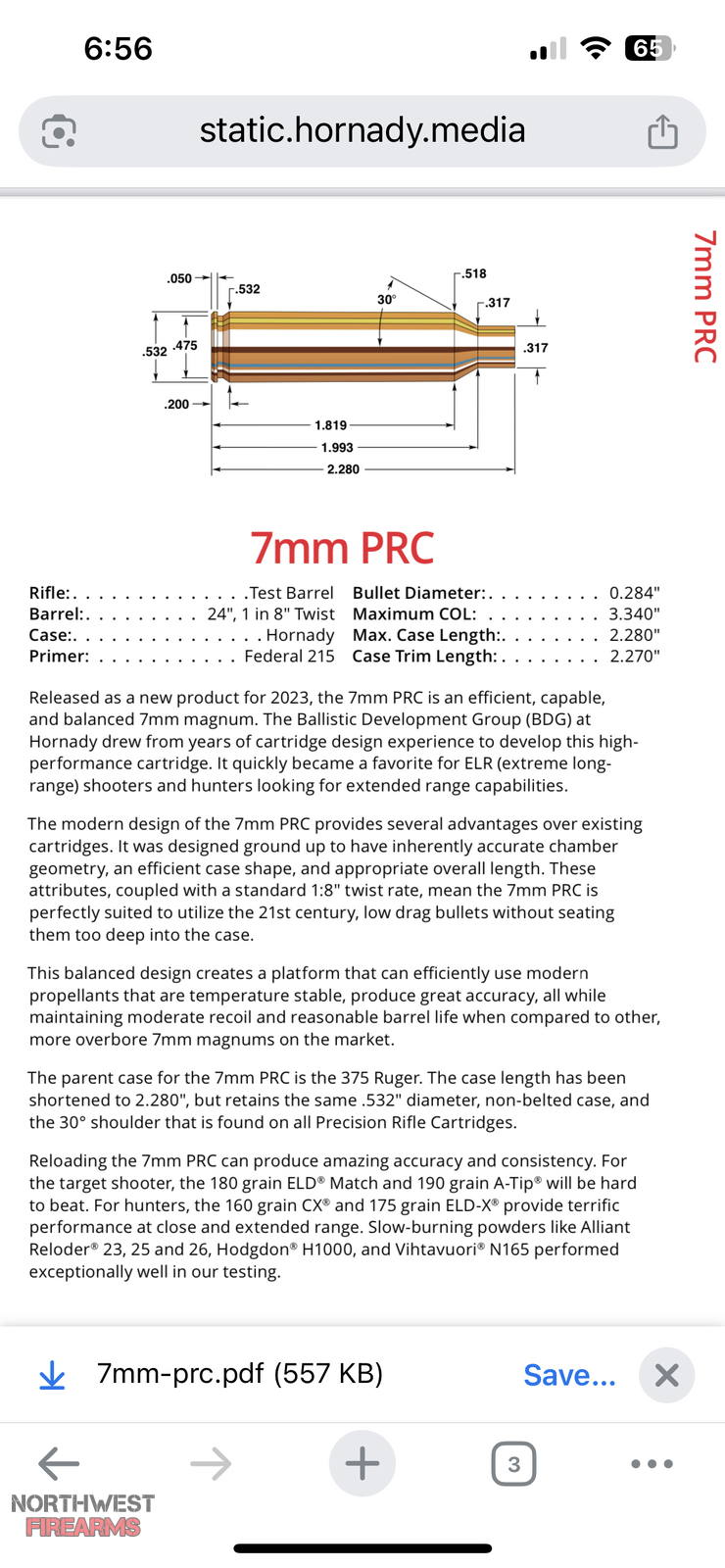

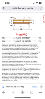

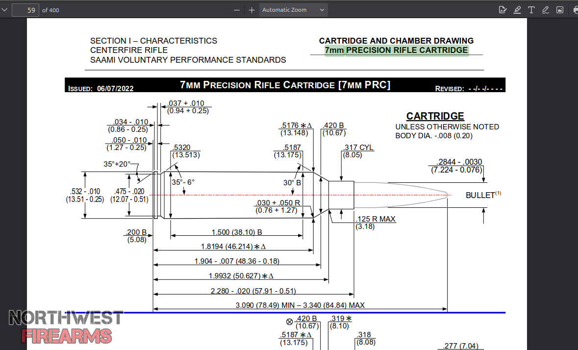

I believe the saami spec for the shoulder datum on the 7prc is 1.904" -.007"
How are you checking your shoulder datum? You should be using a .420dia comparator with the Hornady comparator.
I have sac headspace comparator 7mmx 30deg which they recommend for 7prc and I'm right at 1.82 .
