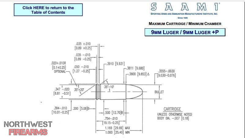

So I've been trying to set an overall length for some 124gr fmj round nose and I am running into a problem, even at minimum seating depth the rounds will not pass the plunk test. The data from lee states that for a 124 fmj round nose using Titegroup minimum COAL is 1.150, so first I thought the bell on the case was to blame but I dropped several unloaded cases in and they cleared no problem. After browsing CZ forums and discussions it seems I'm not the only one with this issue, some where saying they have to set their length at 1.10 for proper function. What bugging me is I'm trying to make a nice happy medium that works nice in my Glock 19 and my CZ and going below listed safe depth makes me a little nervous.
I understand that Glock chambers and CZ vary greatly in design and allowable length will be different as well. The only conclusion I can come up with is set charge at minimum and keep dropping the length until they chamber, Can anybody shed some light on this subject? :s0107:
I've used the 1.1 successfully with my cz SP01. It can be fussy and jamb some hard lead 124's. I take problem rounds and put them in my stock High Power and shoot them flawlessly. My cz shoots practically all factory loads without a hick up. I use a lot of titegroup, bullseye, and some CRP? (That new copper-eraser stuff)
