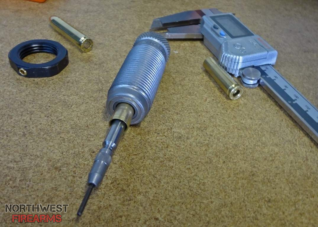

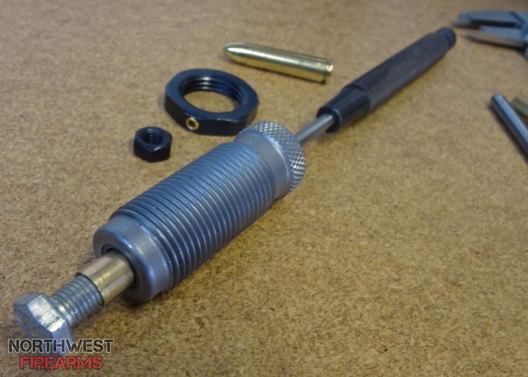

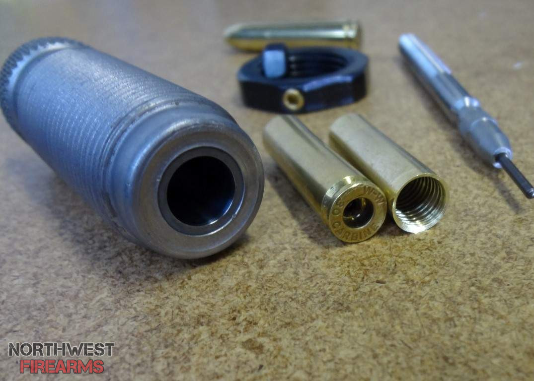

I stuck an M1 Carbine case and used the tap, bolt, hammer & punch method and it worked great +1 for that system. First I took the primmer removal pin out of the bottom of the die, drilled out the bottom of the case, (the rim had stripped off). Tapped it 5/16-24, installed the bolt , and drove it out with a punch.

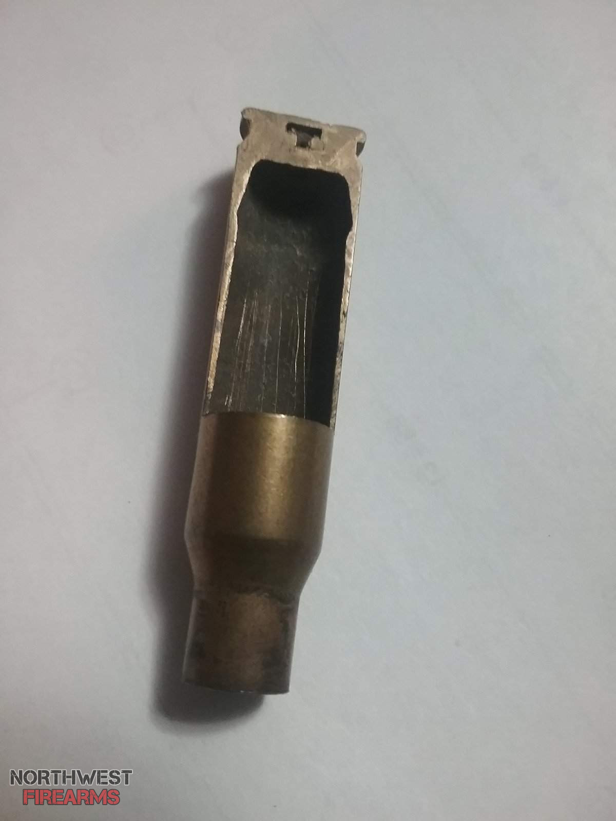

Do you know how many times that case has been reloaded? It looks like a classic case head separation in progress. The case stretches on multiple firings until it finally lets go. They don't usually stretch uniformly, the stress gets concentrated at a section change in the wall thickness and it becomes a case of "tear along the dotted line". Head space is the cause of this. Excessive head space makes it worse. There's always a bit of head space or you wouldn't be able to chamber the round. Upon firing, the firing pin drives the case forward against the shoulder and detonates the primer. Then the case expands, adheres to the chamber wall and the case head, unsupported for a few thousandth of an inch, moves until it contacts the bolt face, stretching the case wall in the process. Do this several times (or sometimes once in the case of a rifle with excessive head space) and the case can let go. If this happens forward of the rim enough, things can function normally except you only extract the case head, leaving the body in the chamber. This was common enough that the military made a tool for extracting the headless case at least in the .30-06 era and earlier.

A way to check cases for this is to take a wire or paper clip and bend a little hook on the the end. You can drag it along the inside of the case and feel for any notches. Here's a photo of a case I sectioned years ago that was showing signs of this in about the same area where the head of your case came off. case head separation.jpg
You are correct in this Ownerus...If chambered in a 7.62 chamber with .308 Win dies (ie. Small base dies) this does become a problem but the other aspect is if its an M1A/M14 or AR-10 with a match chamber do not expect 5-6 loadings from the brass regardless of the type, ie HP, max, match, hunting or mild load...the brass being fired in either of these especially in 7.62 match chambers the brass is not expected to have long life for reloading...at most I load mine sometimes to 3-4x from new but after that into the brass can they go. I too have noticed this and did a bit of research on this and found I was running too much on the use of the brass. I started seeing problems after 5x loads and had major problems after 6x...never made it to 7x...regardless of the quality of the brass.
Too much stretch inside and bases start to show as well. Match 7.62 chambers are inherently tighter dimensions and as such run higher pressures as they are supposed to and are loaded differently as per powder charge and more care taken with the brass. That is why most good load manuals differentiate this in their manuals and load pages with some of the powder manufacturers by Service loading vs. 308 Win. Should anyone want the info and loading data let me know...
It's Lake City Match brass; reloaded once or twice I believe. I have 400+ pieces that have been stored for a dozen years or so. I'm finally getting my bench set back up again.
Yep, it is the typical case head separation; I've had a couple of others that either cracked at the head or neck but didn't break off in the die.
What kind of rifle are you firing these in?
It was previously fired in a NM M1A and will now be loaded for my M1 in 7.62N.
Hopefully you know the actual times its been reloaded...make sure it is not to be used in an M1 match sized chamber...see above. You may not see the "classic" flat primer although it should be there but also the primer pockets themselves will start passing gas through the edges and burning the bolt face...classic signs of pressure and or loose /marginal primer pocket seating size and chamfer for the primer pocket. Too much chamfer can cause improper seating of the primer. When I mentioned care in the use and development of the these loads in match chambers the primers used are very important.
