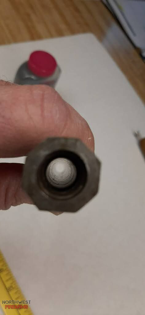

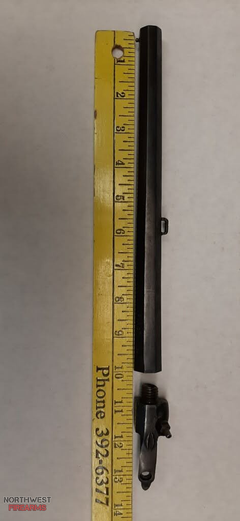

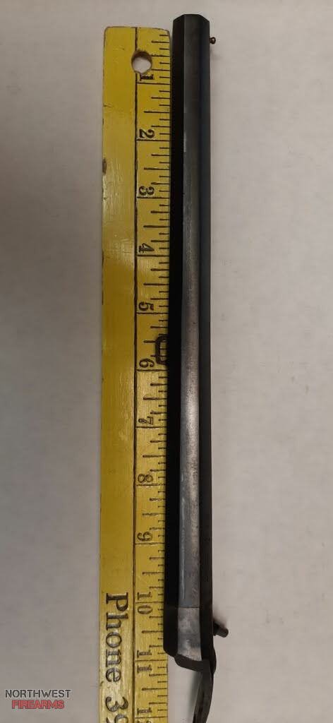

Thank you for the replies! I was able to get quite a bit more info today. This is a Rusco 12mm pistol. On the barrel is engraved, Madison Import Corp. Model 3. Cal 12mm. Made in Spain. He believes it is a reproduction (of what we aren't sure) that he picked up back in the 1960s.
725C44B0-937D-4571-813D-A29DD5F51841.jpeg 9F22C141-810A-4D05-9137-85BFBB8CDE78.jpeg E14A251A-AD96-4818-BB86-82111C84B052.jpeg
I tried to post a few pictures of the "rifling" for detail but I was told it's rough boring done incorrectly. My dad described the rifling more like threads on a bolt or screw than a traditional rifle bore.

You have a inexpensive "replica" percussion pistol.
12mm....is about .47 caliber...which is a correct period caliber 1820's - 1840's.
Replica is in quotes here , because the pistol really isn't a copy of anything.
I am a bit concerned with the breech being removed....
That could lead to problems if it is not reinstalled tightly and aligned correctly.
As for the rifling....it just done in a modern style....not cut like an original antique firearm.
If it were mine...
I'd get the breech back on correctly and find a mold that casts a .450 -.460 round ball*....this actually isn't too difficult as , many pocket pistols of the 1820's and 1840's used this size.
If accuracy is lacking...a thicker patch may be of some help with that issue.
*Assuming that the bore is indeed 12mm / .47 caliber...I'd mic or get a bore gauge and double check.
Speaking of accuracy ...pistols of these sorts were designed for close range...like bad breath distance...not Olympic type target shooting....
The is not a target pistol.
Also a light load would be wise....something in the order of 20 grains of 2 or 3 F black powder.
To be honest here , re-boring or re-barreling the pistol would cost far more than what the pistol is worth.
