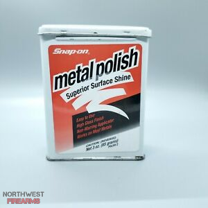

OK, you asked for it, my super secret sauce for cleaning out the nastiest chunky barrels ever!
Get ya a tin of this stuff, tear off a chunk and wrap TIGHTLY around a smaller caliber nylon brush and work it through the barrel both directions, keep at it till it's spotless! Helps to heat the barrel with a heat gun, do it out of the stock and try to get the heat as even as you can, almost too hot to touch is just about right! Careful this stuff is amazing and will polish things you didn't think could take a polish, must be used in a vented room or outside!
It funny that I am a chemist and have access to any chemical you can think of. Acetone and DCM (Dichloromethane) might be to strong for rifle. I will first try JB paste and then Metal Polish product that Ura-Ki suggested above (can't heat the barrel since I live in an apartment). This barrel is going for a replacement at the end of tis months, but this time I want to learn, so I can keep my barrels clean. Copper removal is easy, but this carbon removal is very tough. Interestingly, I bore-scoped all my rifles this evening and the only two that had a lot of carbon buildup and fire-cracking were both Tikka's.
Thanks for the advice. Since I can't heat the barrel in my apartment, I am thinking doing this at my range. Take 10 shots to heat the barrel, and then keep cleaning with the polisher.
