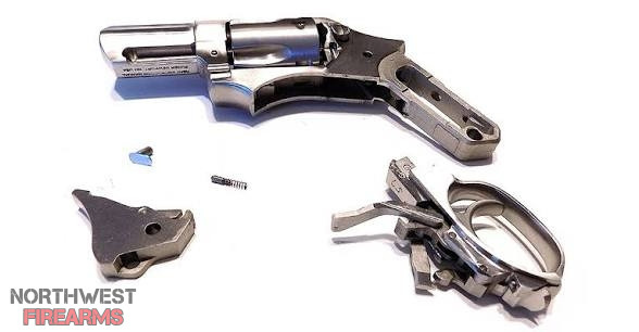

Would you have some time available to make some tweaks on my GP100 and SP101?
Just kidding! ;) :D
For you, yes...yes I would. Just won't guarantee in what condition it would be when returned.
Most likely a bag of parts, and again no guarantee that all parts would be there or belong to the gun. :D
