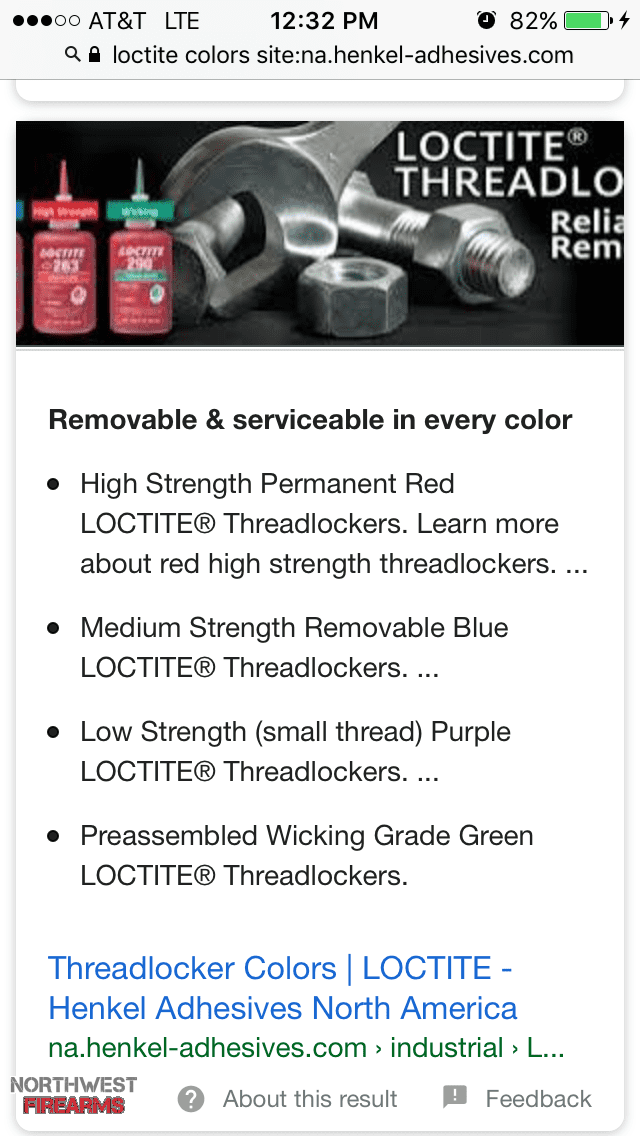

Not to nit pick but locktite makes a lot of colors for various applications:rolleyes:

That Preassembled Wicking Green sounds like it might be just what one would need for the OP's needs.
I've never used it though so I'm not advocating for it.
