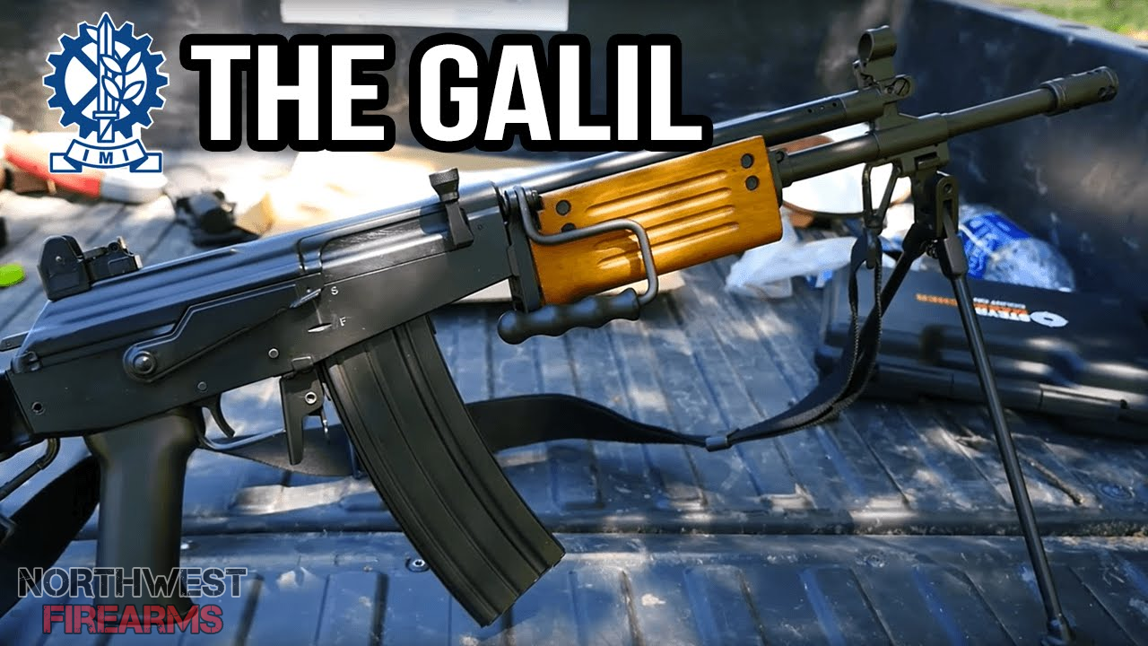

The support hand going over works- going under IME not so much. I've been toying with the idea of having a knowledgeable handy smith weld an upright piece to the bolt handle to make it easier to access. But for the $$$ spent I'd be better off getting a better rear sight first. Something like a tech sight, maybe....
I always thought that the op rod "handle" here, was an excellent idea.
No fair.....It's NOT an AK.
Whatever dude. Not to mention the "better" sights.
