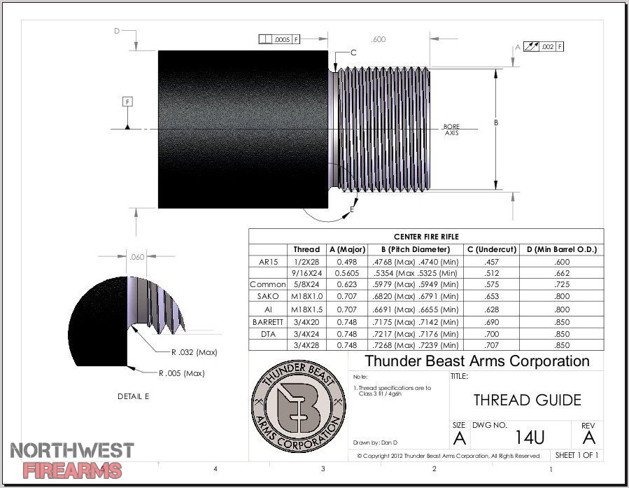

I was wondering how to tell what the thread is for a flash hider?
The caliber is 6.8 SPC but unsure of the barrel actually on it. I assume since it is so close to a 7.62/308 it would be the 5/8-24 not the size for 5.56/223 at 1/2-28.
I also don't see markings on the barrel which might indicate the size, BUT I don't really know what I am looking for there.

That wouldn't usually be marked on a barrel. 5/8x24 is the norm. If you wanted to verify, measure the major diameter (OD) of the threads.
Measure it. If you don't have measuring tools, go to your hardware store and pick up a nut for both thread sizes. See which one fits.
