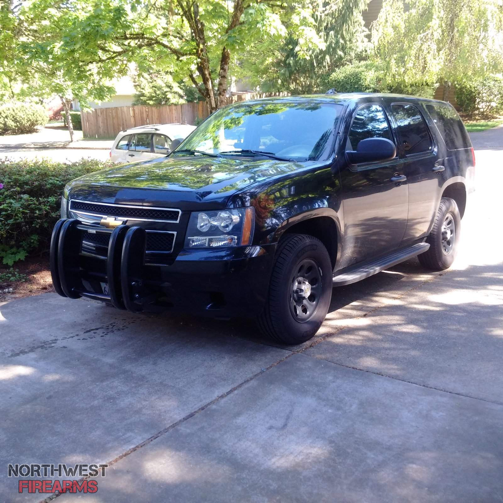

Something like this?
Just like my 99 except mine was maroon and had a bunch of antennas.
2011 approaching 170k. Bought it with 119k on it. I've since added stock rims. That bumper is aftermarket. the original one was a huge Setina with the wrap-arounds. Oddly enough, my wife liked the cop bumper more than I did.
I currently have several antennas for my ham and GMRS radios. It's way toned down from when I first got it. I got tired of that fast though. It was like I was leading a parade everywhere I went, lol.
