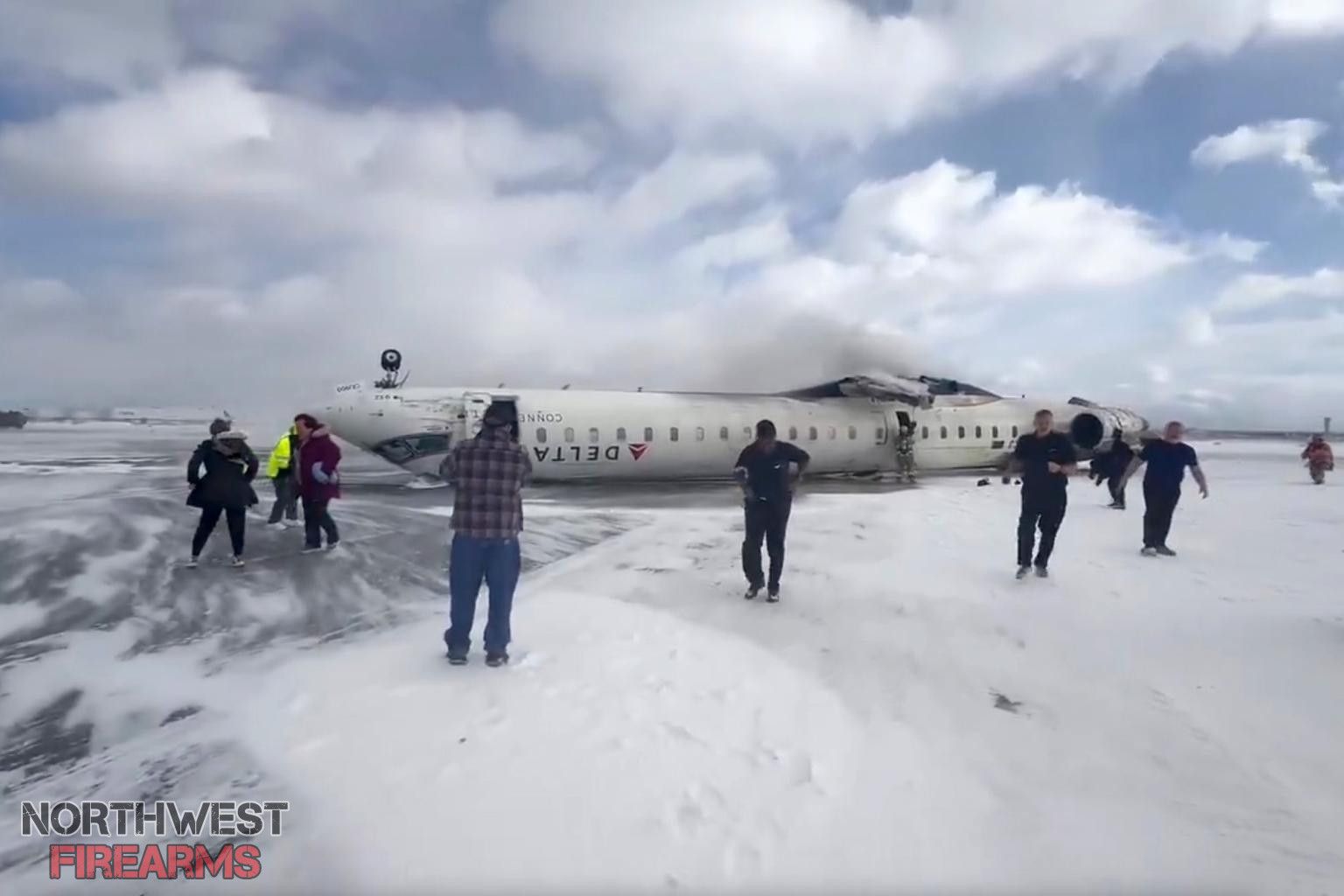

Soem delta plane upside down somewhere now. How's that for specifics? :s0112:

Video of the Toronto crash. ATC said 35 mph gusts. Looks to me like right wing broke off right away. It looks to me like he was too short and hit a road before the runway.
View: https://youtu.be/ZLKbrL7KFNY?si=qRzGnTr_mnp-3uK7
Wind Shear most likely, with those sorts of gusts on short final, and the approach nearly stalled, I'm gonna say unstabilized approach, ( too far behind the curve) in strong wind gusts, hits wind shear and drops it in like a Bush Pilot, which brakes it into pieces! Lucky they were as slow as they were, that could have ended much worse then it did! Still, don't think that's gonna buff out!
It looks like everybody fastened their seat belts and the tanks got opened up enough to leave most of the fuel behind from their forward progress. Very fortunate for the occupants.
