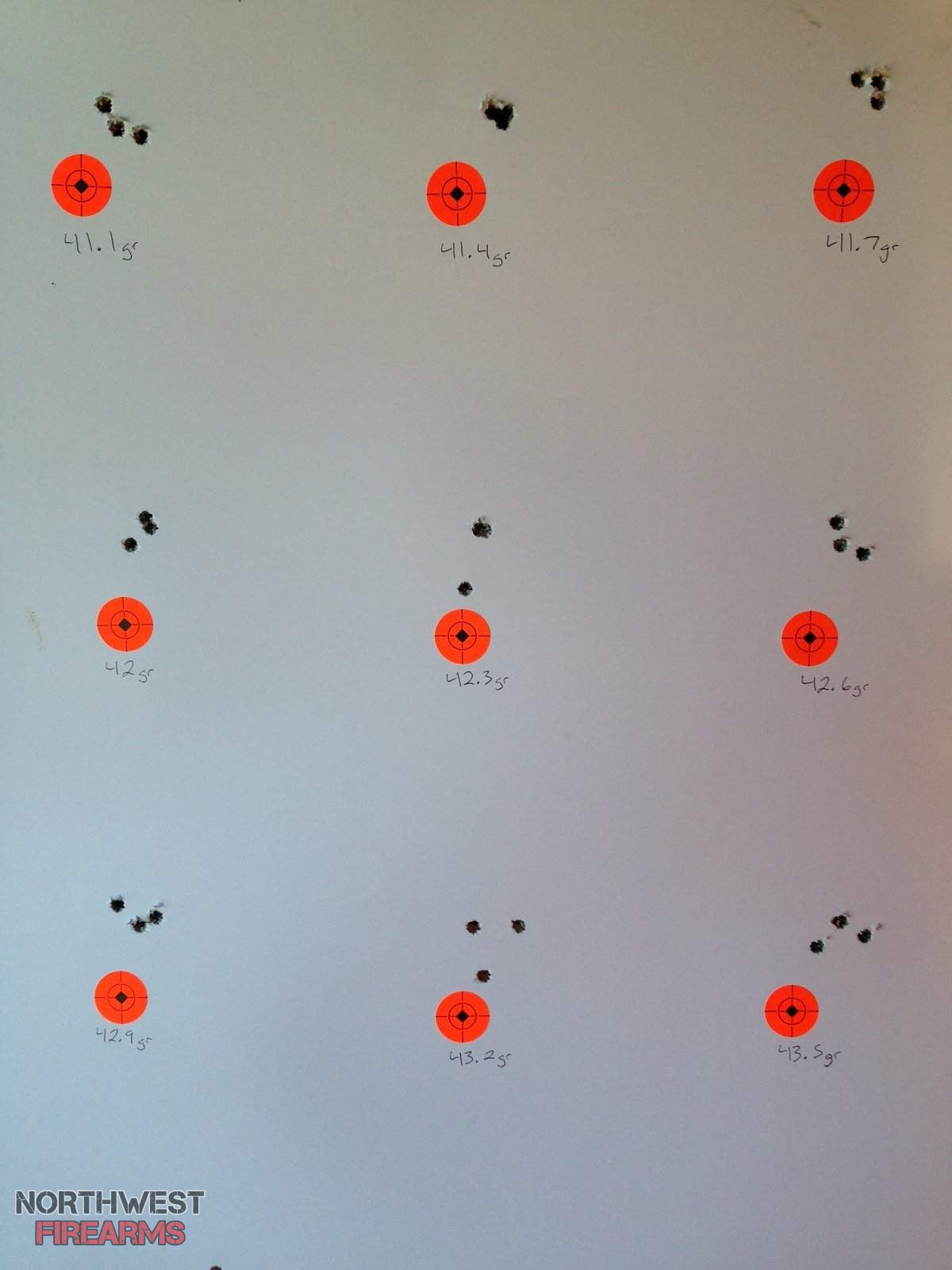

If your goal is long distance I would certainly shoot over the chrony and look for flat spots. To me it looks like your rifle is not that picky. Whichever load shows the least SD and ES will probably shoot best at long range, and sometimes the best long distance loads are not the best at 100 yards.

i was hoping to see a more dramatic POI shift when I shot this test to make seeing the node a little easier but they all are relatively close to the same POI. So either my gun likes everything or should I retest over a chrony and look for a load with low SD and ES? What do you guys think? The gun is a Tikka CTR, virgin Lapua brass, RL16 powder, CCI450 primers and 140gr ELD-Ms loaded .02" off the lands.
Since they are all hitting relatively in the same location, I'd say chrono the 2nd group. If it's fairly low Es and sd, go with that. If not, find one that has better Es and sd, and fine tune with bullet seating depth.
Nice shooting rifle btw. This is all I need. Another rifle for consideration. Thanks a lot. :D
Made it out again today with my magnetospeed chronograph. I shot five rounds per group @200yds so it's a fairly small sample size.
1x fired Lapua brass FL sized
140gr ELD-M
CCI 450 primer
RL16 powder
CBTO 2.355" =.O2" off the lands

So 42.4gr had the best SD and ES numbers but one of the worst groups. Do you think playing with the seating depth would shrink these up? I'll admit it was a little cold and I was doing my best to not shake.

Yeah, play with seating depth, just about any load can be made to shoot well by playing around with the seating depth, but poor SD and ES will give you bad results at a distance.
An OCW test isn't really about groups anyway, it's more about finding patterns and consistent velocities.
Just to confirm, you're shooting round robin right, one of a charge weight then the next weight and so on, then start back at the low end.
Edit: looking at the patterns I would be inclined to try 42.2 as well, the CW above and below all shoot to roughly the same POI.
Another edit: I just read you are using a magnetospeed, make sure you test the seating depth with it off.
