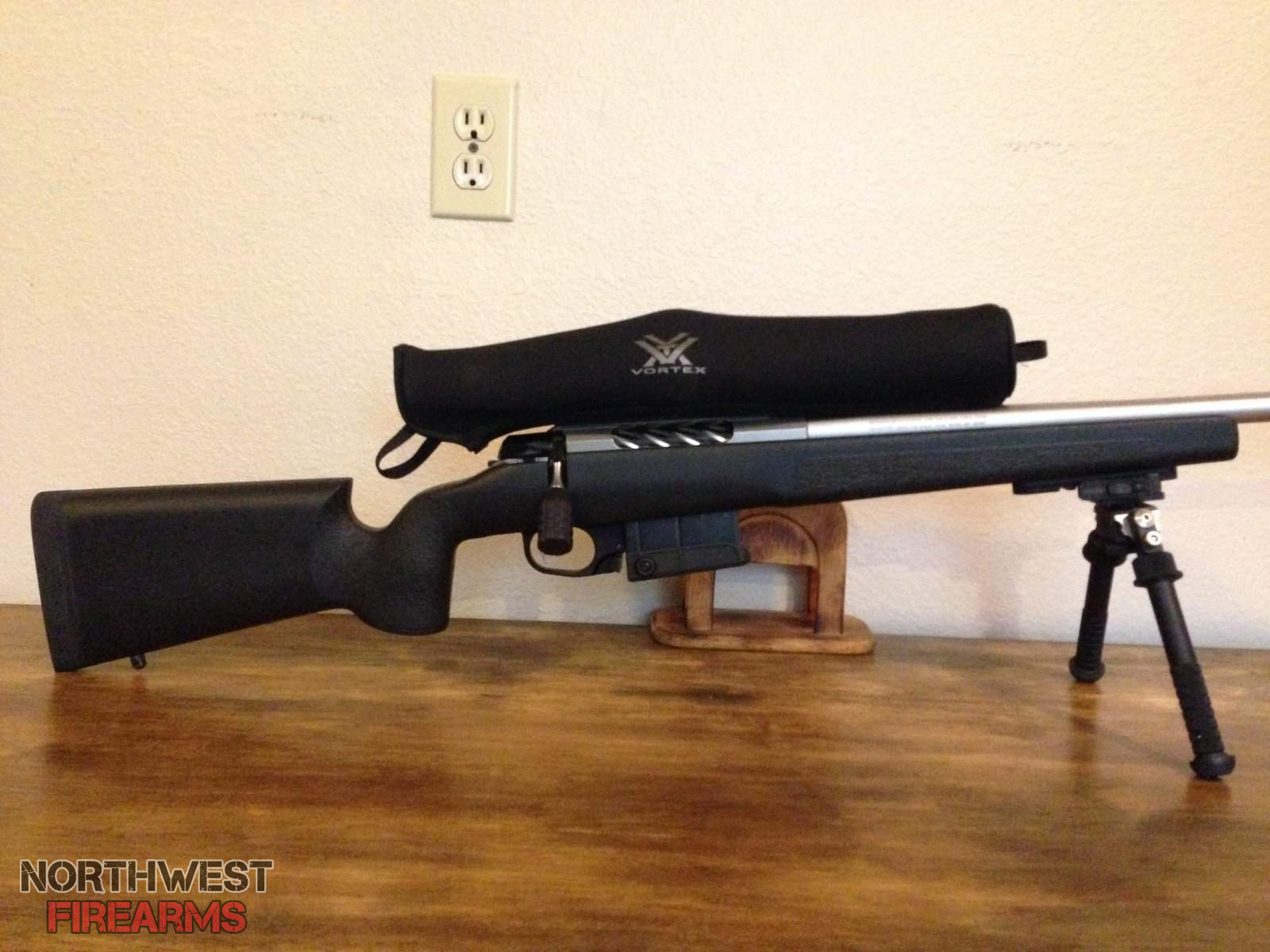

i was hoping to see a more dramatic POI shift when I shot this test to make seeing the node a little easier but they all are relatively close to the same POI. So either my gun likes everything or should I retest over a chrony and look for a load with low SD and ES? What do you guys think? The gun is a Tikka CTR, virgin Lapua brass, RL16 powder, CCI450 primers and 140gr ELD-Ms loaded .02" off the lands.
