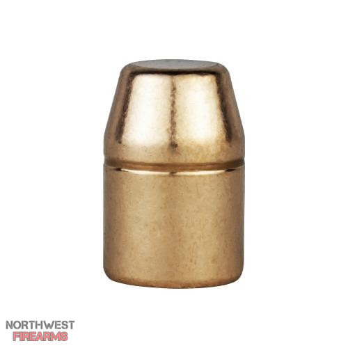

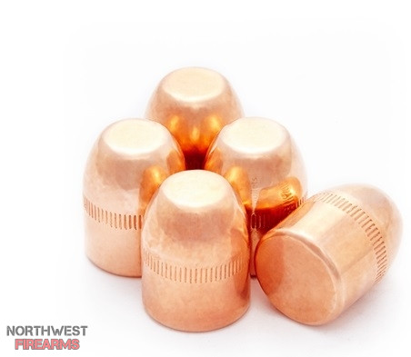

Momentarily back to your feeding issue, you may want to try another bullet with a different profile to get back to book COAL values. I ran into feeding issues with 10mm using a "square shouldered" bullet like the Berrys, but my pistol runs all day with Xtreme "round shouldered" bullets. You can see the difference below:
Berry's 240 gr 44 cal:
Xtreme 240 gr 44 cal:
