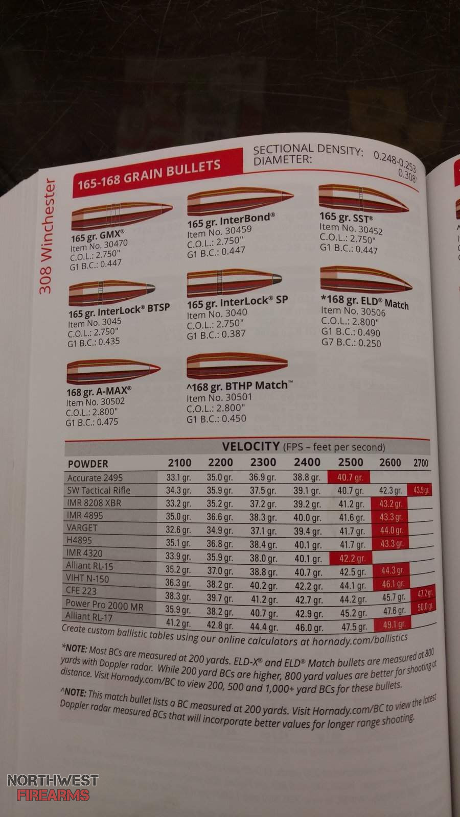

Does anyone have a good load developed for the ELD Match 168 for a 308? Or anyone have the new Horandy book with the data that i could start with. I have some Varget powder and some 4895.

Actually, I noticed some discrepancy in the BC from different sources and I emailed Hornady. They have 3 different BC listed depending on MV Ballistic Coefficient - Hornady Manufacturing, Inc The Book is worth getting just for the ELD info. The link gives an explanation.
This is for the 168 ELD Match, G1 BC
2512 - .523
2232 - .516
1953 - .498
Thanks for the clarification. It seems common to have a higher BC at higher velocities. I've noticed that with sierra bullets as well.
The Hornady book numbers seem pretty conservative to me. I would hope for faster speeds than that with a 168. My 175 grain 308 load is 2650ish fps with 44 grains of Varget. I will look up my 168 AMAX load and report back.
Don't forget to look at online data from hodgdon and or ramshot,
The hornady book is good but limited in data I always check on line the hornady book doesn't include many of the new powders out,
I started working with IMR 4166 and 168gr amax 308 I am still working on dialing in my load but so far I can repeatedly hold 3/4 moa at 100 yards,
My 168 Amax load is 45 grains of Varget with CCI 250 primers. Been a couple of years since I chrono'd them and I have kind of a limited sample when I did but it looks like they averaged about 2705 fps.
