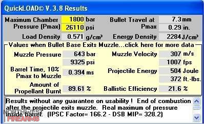

I could model it up in QuickLOAD, but it would be for "illustration only" ;)
not sure what extrapolate meanso_O but would love the illustration,i need to try quickload never messed with it before,but ive heard alot of people talk about it.probably great for obsolete stuff.thanks for the help.
